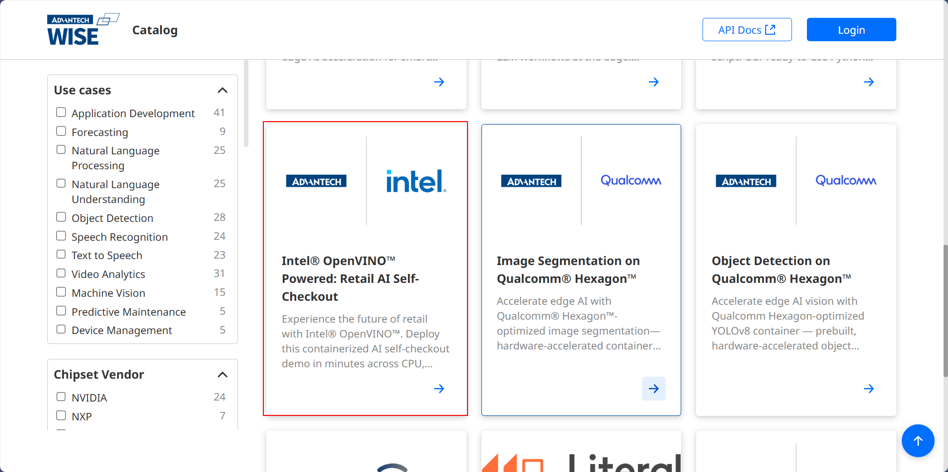

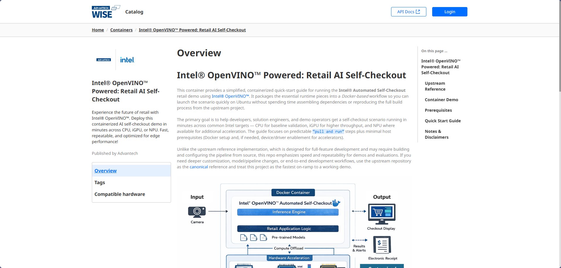

2. Select a Container
Choose a container that meets your application requirements.
In this example, we will use the container shown in the image: Intel OpenVINO Powered: Retail AI Self-Checkout.
WEDA Catalog Container

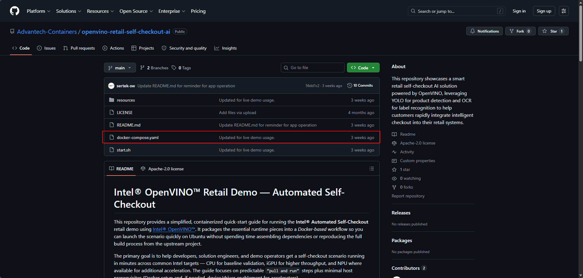

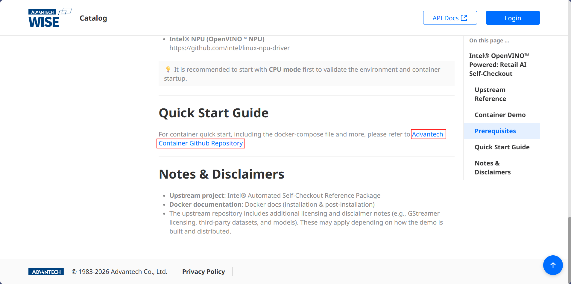

3. Get Docker Compose and Registry Information
Each catalog container entry includes:
  • A GitHub repository link with the docker-compose configuration
  • Registry information (registry URL and credentials) for pulling the container image
WEDA Github Link
Click the GitHub link to access the repository and download the docker-compose.yml file.
WEDA Github Repo

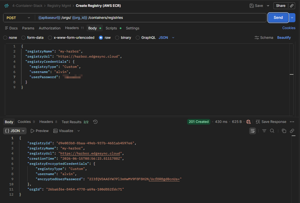

1. Create Registry Configuration
Use the following API to register the container registry with WEDA Cloud.
Create Registry (AWS ECR): Register the container registry with your organization.
備註
While the API is named "AWS ECR", it supports various registry types including Docker Hub, AWS ECR, Azure Container Registry, and private registries.
Expected result: WEDA Cloud returns 201 and provides the created registry configuration.
Postman create registry

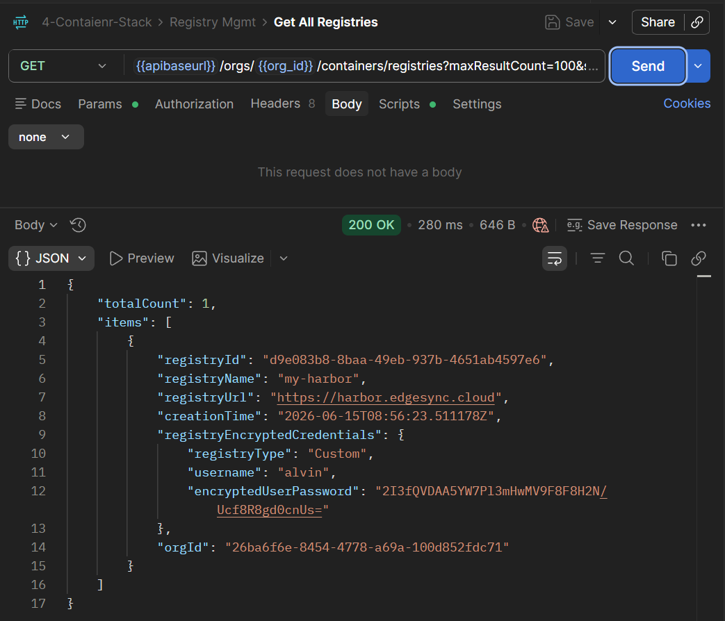

2. Verify Registry Configuration
Use the following API to verify the registry was successfully registered.
Get All Registries: Retrieve all registered registries to confirm the new registry appears in the list.
Postman get registry
Example Request: Curl
curl --location --request GET 'https://{domain}/{tenantPath}/{appPath}/api/v1/orgs/{orgID}/containers/registries' \
--header 'Authorization: Bearer {access-token}'
Example Response
"totalCount": 1,
"items": [
"registryId": "d9e083b8-8baa-49eb-937b-4651ab4597e6",
"registryName": "my-harbor",
"registryUrl": "https://harbor.edgesync.cloud",
"creationTime": "2026-06-15T08:56:23.511178Z",
"registryEncryptedCredentials": {
"registryType": "Custom",
"username": "alvin",
"encryptedUserPassword": "2I3fQVDAA5YW7Pl3mHwMV9F8F8H2N/Ucf8R8gd0cnUs="
"orgId": "26ba6f6e-8454-4778-a69a-100d852fdc71"

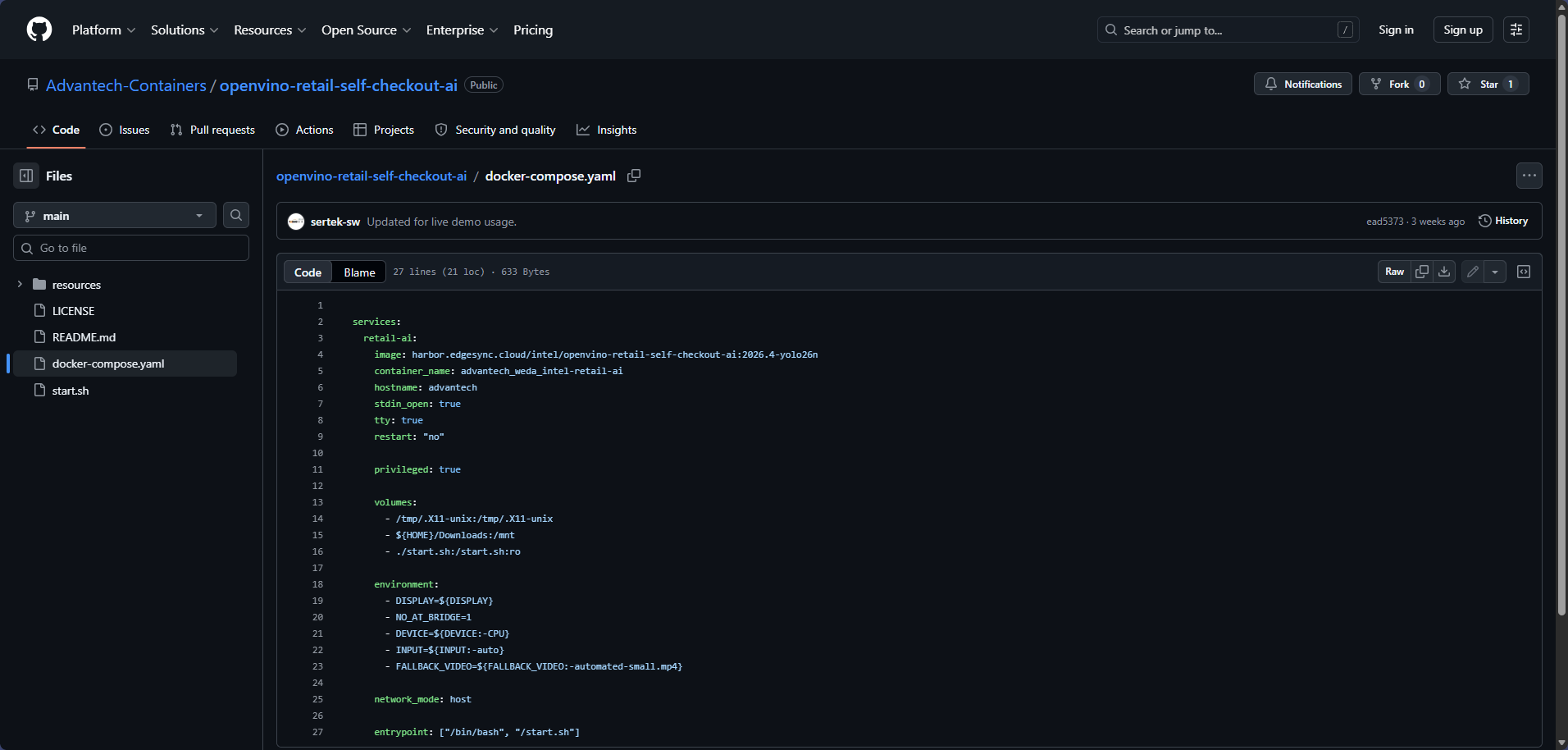

1. Download or Create docker-compose.yml
If you selected a container from Advantech Catalog, download the docker-compose.yml from the GitHub repository.
WEDA docker-compose

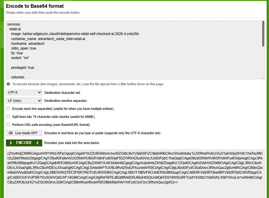

2. Encode Docker Compose File in Base64
The WEDA Stack API requires the docker-compose content to be Base64-encoded.
Copy the docker-compose.yml content and encode it in Base64 format. Use any online Base64 encoder or command-line tools.
Example command (Linux):
base64 -w 0 docker-compose.yml
Example command (macOS):
base64 < docker-compose.yml | tr -d '\n'
Example command (PowerShell):
[Convert]::ToBase64String([System.IO.File]::ReadAllBytes("path/to/docker-compose.yml"))
The encoded result will be used as composeFileContent in the stack creation API request.
The screenshot below shows an example using a web-based Base64 encoder.
WEDA Base64 Encode

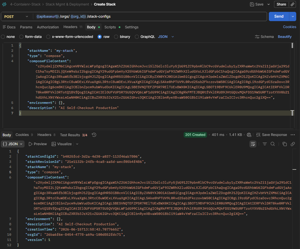

3. Create Container Stack
Use the following API to create a container stack with the Base64-encoded docker-compose content.
Create Stack: Create a container stack with the Base64-encoded compose file and reference the registry you registered in 2. Register Container Registry.
Expected result: WEDA Cloud returns 201 and provides the created stack configuration with a unique stackConfigId and stackRevisionId.
Postman create stack

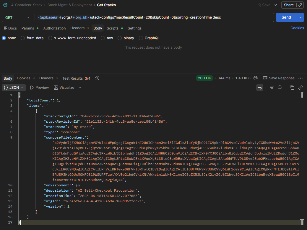

4. Verify Stack Configuration
Use the following API to verify the stack was successfully created.
Get Stacks: Retrieve all stacks in your organization to confirm the new stack appears in the list.
Postman get stacks
curl --location --request GET 'https://{domain}/{tenantPath}/{appPath}/api/v1/orgs/{orgId}/stack-configs' \
--header 'Content-Type: application/json' \
Example Response
"totalCount": 1,
"items": [
"stackConfigId": "b4025fcd-3d2a-4d30-a037-113f46ab7806",
"stackRevisionId": "21e1132b-24fb-4ca8-aa5d-aecf05b4f486",
"stackName": "my-stack",
"type": "compose",
"composeFileContent": "{Base64-encoded}",
"environment": {},
"description": "AI Self-Checkout Production",
"creationTime": "2026-06-15T13:58:43.707766Z",
"orgId": "26ba6f6e-8454-4778-a69a-100d852fdc71",
"version": 1

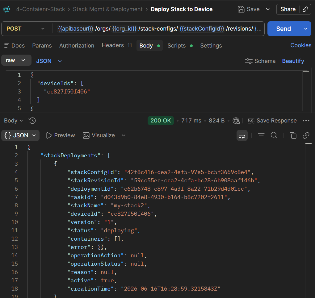

1. Deploy Container Stack
Now that you have created the stack configuration, deploy it to your edge device.
Deploy Stack to Device: Deploy the stack configuration to one or multiple edge devices.
Expected result: WEDA Cloud returns 200 and provides deployment information including the deploymentId and taskId. The status will typically show "deploying" initially.
Postman deploy stack
curl --location --request POST 'https://{domain}/{tenantPath}/{appPath}/api/v1/orgs/{orgId}/stack-configs/{stackConfigId}/revisions/{stackRevisionId}:deploy' \
--header 'Authorization: Bearer {access-token}' \
--data '{
"deviceIds": [
"{deviceId}"
Example Response
"stackDeployments": [
"stackConfigId": "42f8c416-dea2-4ef5-97e5-bc5f3669c8e4",
"stackRevisionId": "59cc55ec-cca2-4cfa-bc28-6b908aaf146b",
"deploymentId": "c62b6748-c897-4a3f-8a22-71b29d4d01cc",
"taskId": "d043d9b0-84e8-4930-b164-b8c7202f2611",
"deviceId": "cc827f50f406",
"version": "1",
"status": "deploying",
"containers": [],
"error": {},
"operationAction": null,
"operationStatus": null,
"reason": null,
"active": true,
"creationTime": "2026-06-16T16:28:59.3215843Z"
"totalDevices": 1,
"skippedDevices": 0,
"newlyDeployedDevices": 1,
"deviceActions": {
"cc827f50f406": "add"
提示
Key Parameters:
  • stackRevisionId: The revision ID from the stack creation step
  • deviceIds: Array of device IDs where you want to deploy the stack
  • deploymentId: Unique identifier for this deployment (used in verification step)
  • status: "deploying" indicates the deployment is in progress

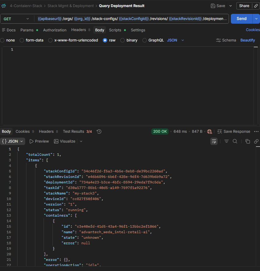

5. Verify Deployment Status​
1. Query Deployment Result
After deploying the stack, use the following API to check the deployment status and verify that the containers are running on the edge device.
Query Deployment Result: Get the list of active stack deployments and check their current status.
Expected result: WEDA Cloud returns 200 with deployment details. When the status shows "running", the containers are successfully deployed and running.
Postman deploy result
curl --location --request GET 'https://{domain}/{tenantPath}/{appPath}/api/v1/orgs/{orgId}/stack-configs/deployments' \
Example Response
"totalCount": 1,
"items": [
"stackConfigId": "34c46f2d-f5a3-4b5e-8eb8-de39bc2260ad",
"stackRevisionId": "e46b6896-6b6f-428e-9df4-7d639b6b9a72",
"deploymentId": "734a4e23-b3ce-4bfc-8594-29eda7f9c5da",
"taskId": "d30a1777-85b1-40d5-a149-7597f1a92276",
"version": "1",
"status": "running",
"containers": [
"id": "c3e40efd-41d5-43a4-96f1-13bbc2ef1066",
"name": "advantech_weda_intel-retail-ai",
"state": "unknown",
"error": null
"error": {},
"operationAction": "idle",
"operationStatus": "deployed",
"reason": "",
"active": true,
"creationTime": "2026-06-17T03:08:15.966463Z"
提示
Deployment Status States:
  • deploying: Container is being deployed to the edge device
  • running: Container is successfully running on the edge device
  • failed: Deployment failed - check the error field for details
  • active: true: This deployment is currently active on the device
2. Verify Container Running Status
Confirm that the deployment has reached the "running" status and containers are healthy.
Key Parameters to Check:
  • status: Should be "running"
  • containers: Array should contain your container definitions
  • error: Should be empty {} if deployment succeeded
  • active: Should be true for active deployments
If the response shows "status": "running", the container is successfully running on the edge device. Proceed to 6. Manage Container Commands to interact with your running containers.

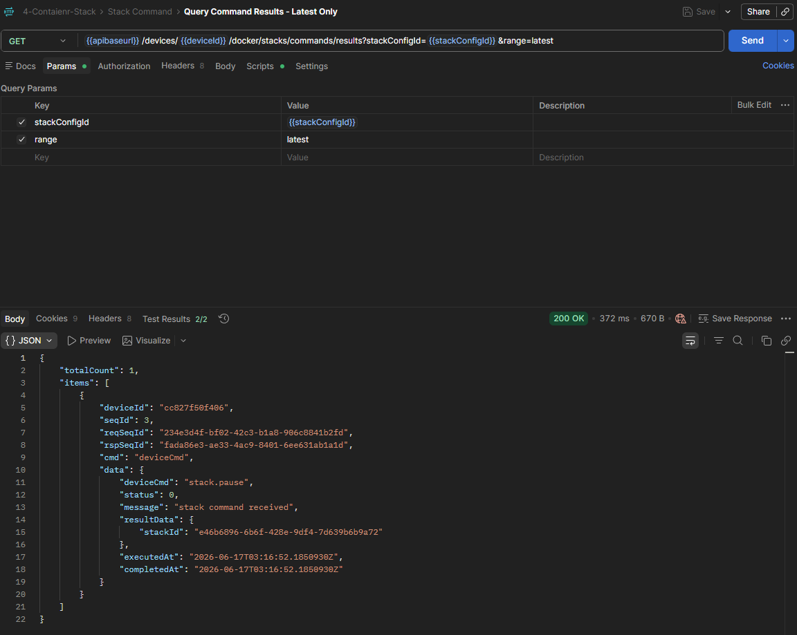

2. Query Command Execution Results
After executing a command, you can query the results to verify successful execution.
Postman Collection: 4-Container-Stack > Stack Command​
Query Command Results - Latest Only: Get the latest command execution result.
Expected result: WEDA Cloud returns 200 with totalCount and latest command result entries. The response includes deviceCmd, execution status, timestamps, and stack-level resultData.
Postman container command
curl --location --request GET 'https://{domain}/{tenantPath}/{appPath}/api/v1/devices/{deviceId}/docker/stacks/commands/results?stackConfigId={stackConfigId}&range=latest \
Example Response
"totalCount": 1,
"items": [
"seqId": 3,
"reqSeqId": "234e3d4f-bf02-42c3-b1a8-906c8841b2fd",
"rspSeqId": "fada86e3-ae33-4ac9-8401-6ee631ab1a1d",
"cmd": "deviceCmd",
"data": {
"deviceCmd": "stack.pause",
"status": 0,
"message": "stack command received",
"resultData": {
"stackId": "e46b6896-6b6f-428e-9df4-7d639b6b9a72"
"executedAt": "2026-06-17T03:16:52.1850930Z",
"completedAt": "2026-06-17T03:16:52.1850930Z"
