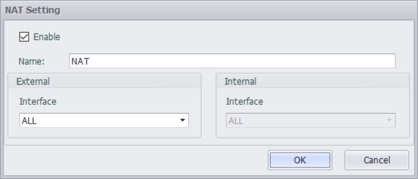

The user can configure the properties as follows:
  • Enabled: When enabled, this configuration will be added to nat.sh.
  • Name: You can choose to support only TCP or UDP or both protocols.
  • External network-network port: Select to allow the internal network device to access the external network through the specific network port of the gateway, or can access through all network ports.
