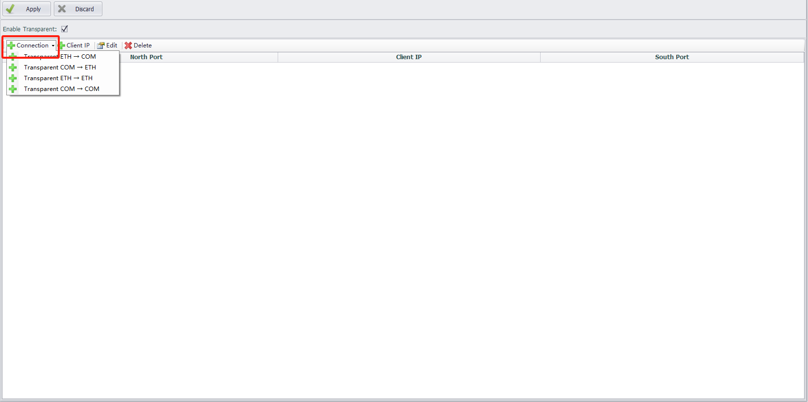

Connection Settings​
After enabling the transparent transmission function, select the appropriate connection.

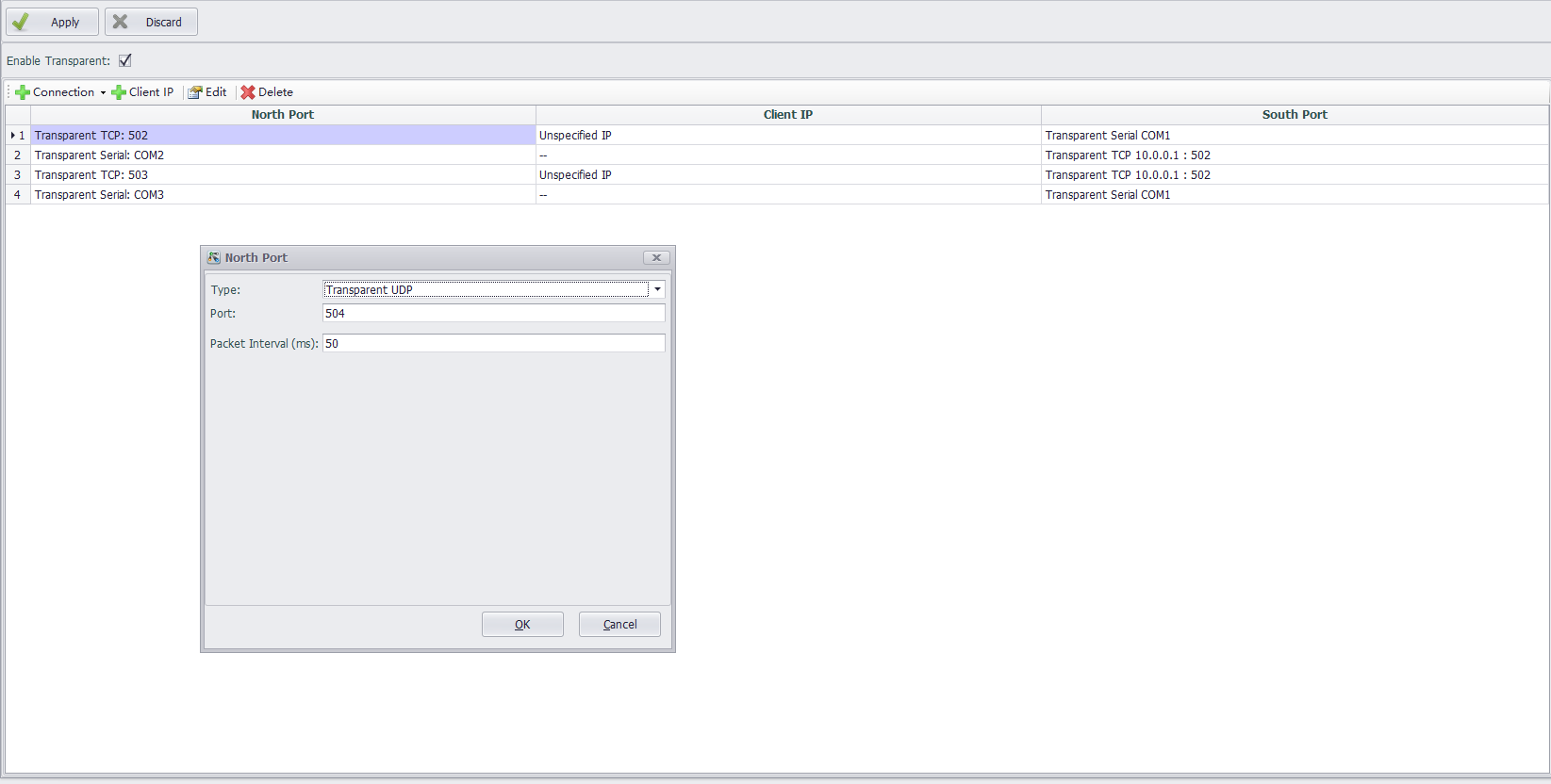

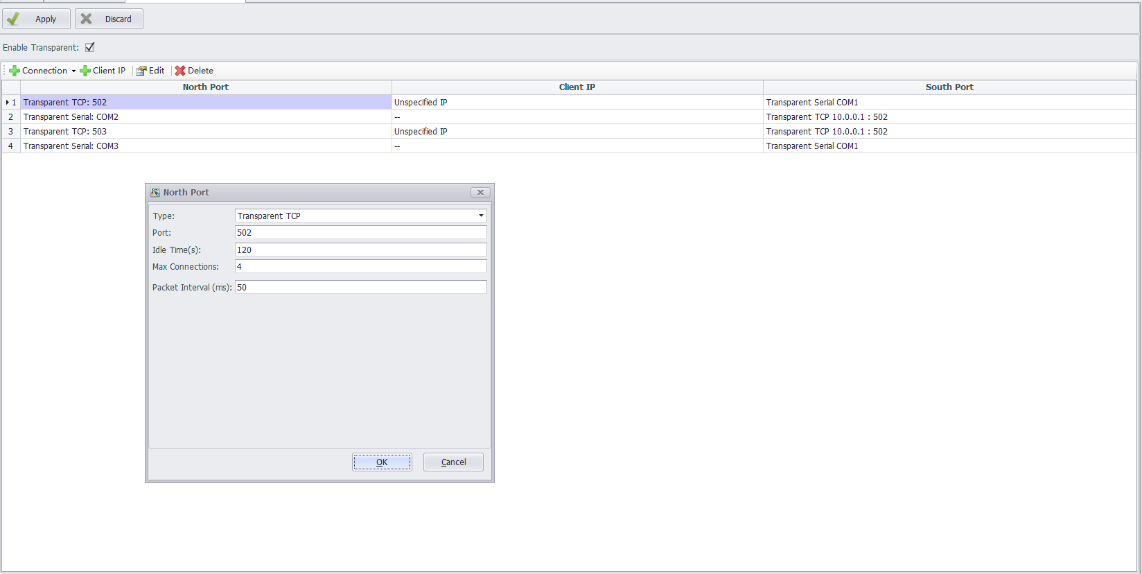

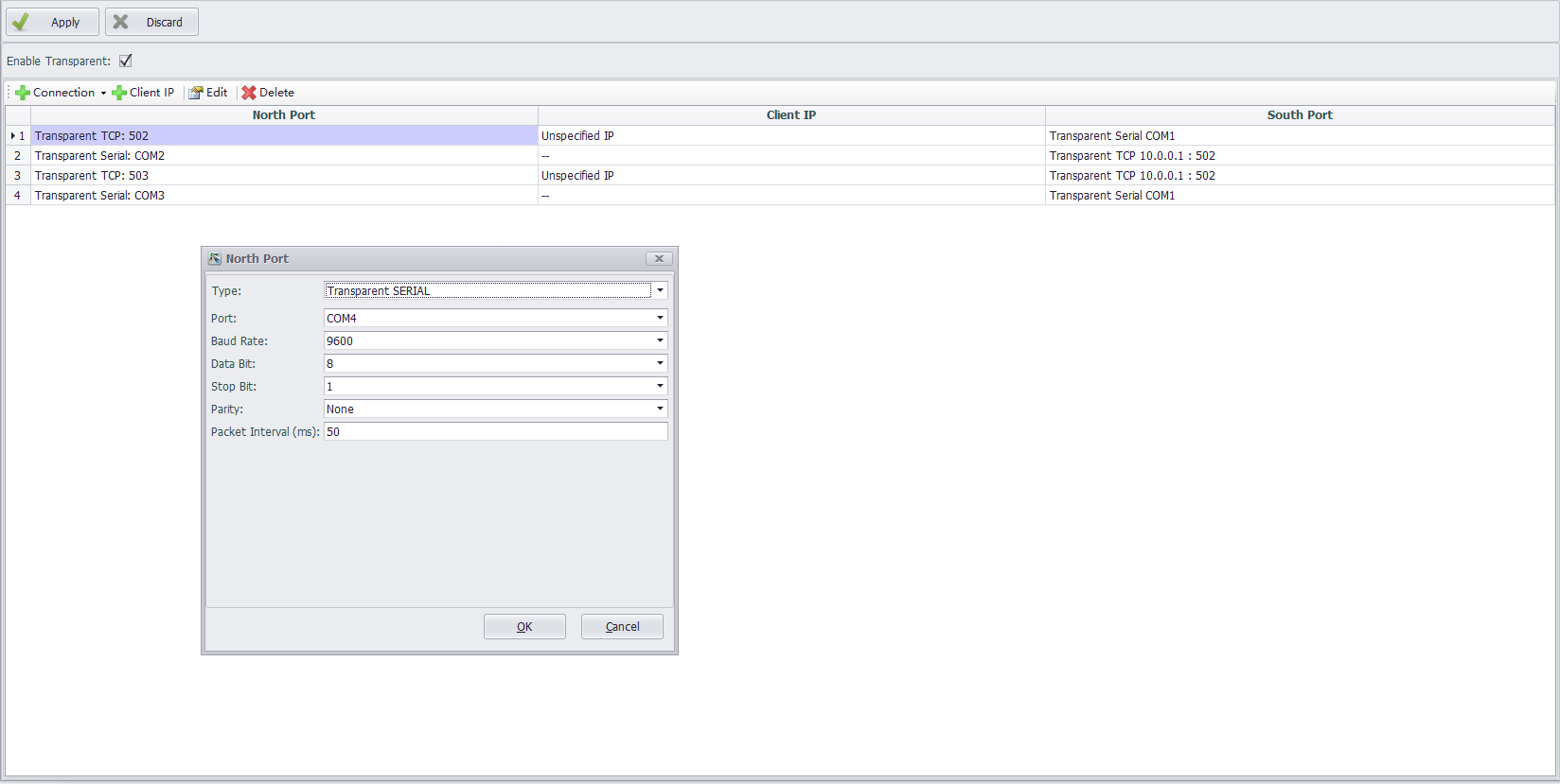

North Port Configuration​
Configure parameters for the northbound port, such as port number, baud rate, start bit, stop bit, etc.
COM Port: The serial port to which the northbound device connects. The dropdown list displays all available ports on the current device.
Baud Rate: Specifies the serial transmission baud rate. Default: 9600.
Data Bits: Specifies the number of data bits. Default: 8.
Stop Bits: Specifies the number of stop bits. Default: 1.
Parity Check: Specifies the parity check rule. Default: None (no parity check).
Idle Time (Default: 120 seconds): For TCP-type northbound ports, if the device sends no data within 120 seconds, the connection is deemed idle and terminated.
Idle Timeout: Specifies the maximum duration allowed for no read/write operations after a TCP connection is established. Default: 120 seconds. Setting it to 0 disables this check.
Packet Interval: Default: 50 ms. Used to separate frames between packets.

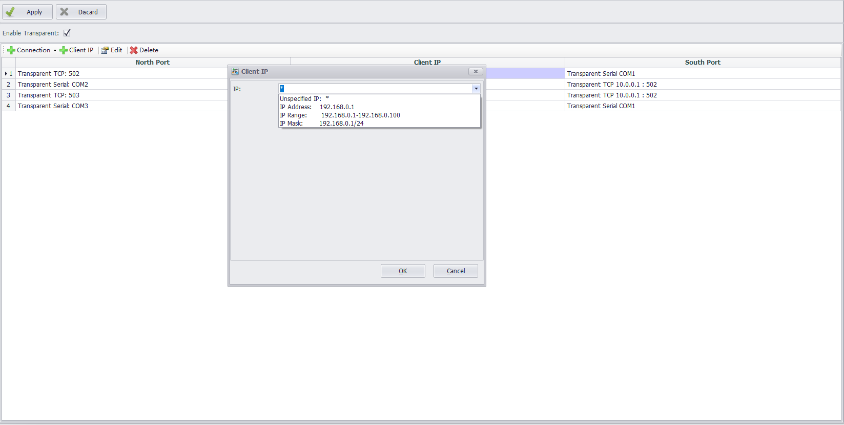

Client IP Configuration​
Select an IP whitelist option: allow all IPs (*), a single IP, an IP range, or a subnet mask.

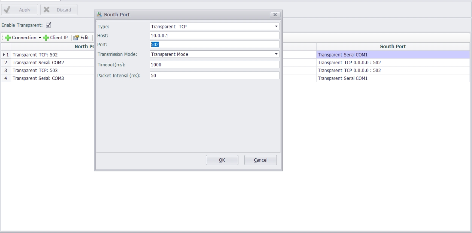

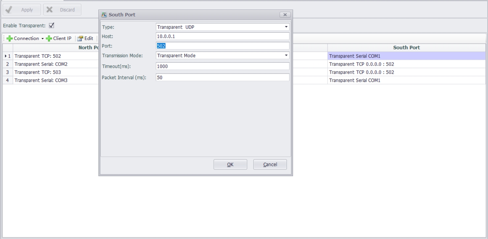

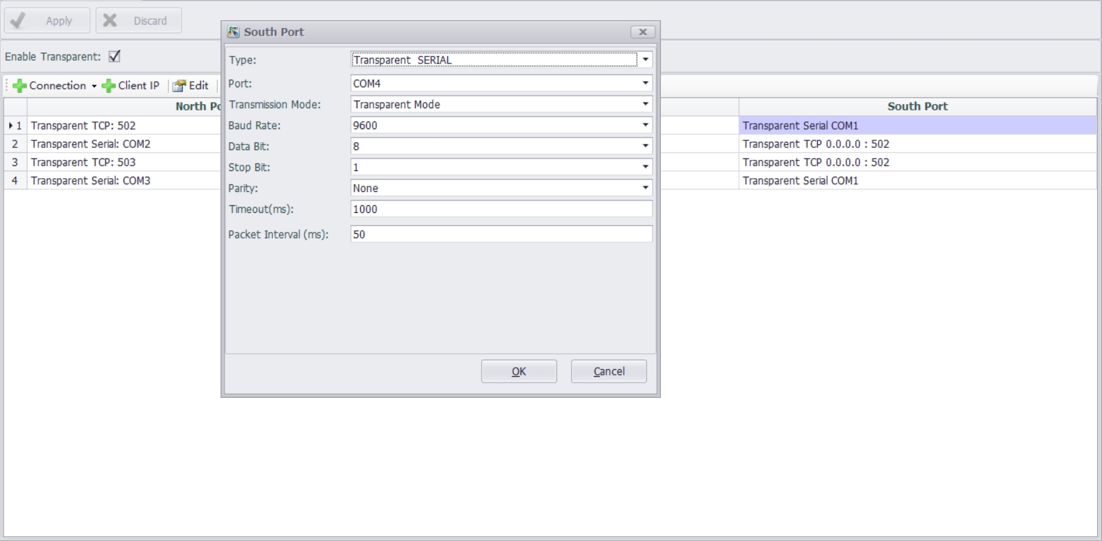

Southbound Port Configuration​
Configure parameters for the southbound port, such as port number, baud rate, start bit, stop bit.
COM Port: The serial port for the northbound device. If a port is unavailable, it may be occupied by another service and must be manually released in the data center.
Baud Rate: Default: 9600.
Data Bits: Default: 8.
Stop Bits: Default: 1.
Parity Check: Default: None.
Idle Time: Same as northbound configuration.
Timeout: Default: 1000 ms. In response mode, if the southbound device does not reply within 1000 ms after a request is forwarded, the system will deem it a timeout.
Transmission Mode:
Default: Transparent Mode.
Transparent Mode Selected: Southbound and northbound devices can communicate freely.
Listening Mode Selected: Data exchange is conducted in a free communication mode.
Response Mode Selected: The southbound device operates in response mode, meaning the northbound device actively sends requests to the southbound device and waits for a response before returning the data to the northbound device.
