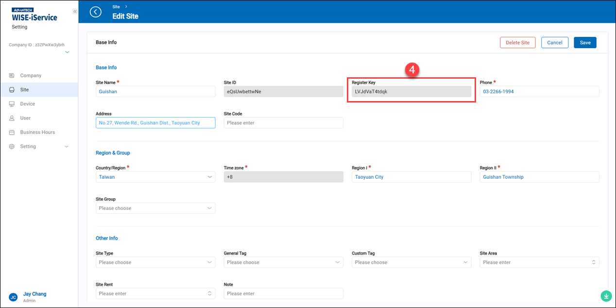

Step 1: How to obtain the "Register Key" information for the site.

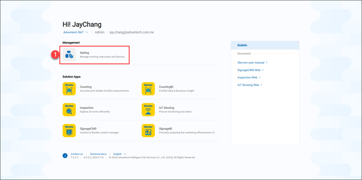

Quick Start_UCAM-130_VideoSource_1_Ori.png 1. Please log in to the WISE-iService platform (https://apps.wise-iservice.com/), and click on "Setting."

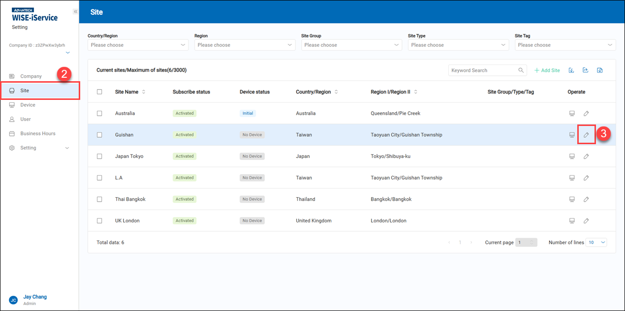

Quick Start_UCAM-130_VideoSource_2.png 2. Click on the "Site" page.
3. Click the edit icon on the site where the UCAM-130 is to be registered, for example, the "Guishan."
Quick Start_UCAM-130_VideoSource_3.png 4. Please copy or note down the alphanumeric string in the "Register Key" field. This string will need to be entered into the UCAM-130 camera settings later.

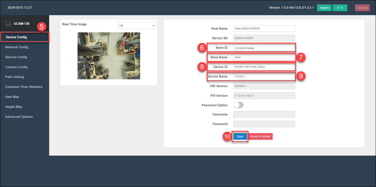

Quick Start_UCAM-130_VideoSource_4.png 5. Log in to the UCAM-130 camera management webpage and click on "Device Config" in the left-side function menu. 6. In the "Store ID" field, enter the "Register Key" for the site. 7. In the "Store Name" field, enter any name that is easy for users to recognize for the site. 8. In the "Device ID" field, enter the 16-character serial number of the UCAM-130 camera (which can be found on the serial number sticker on the camera's casing). 9. In the "Device Name" field, enter any name that is easy for users to recognize for this specific UCAM-130 camera. 10. Click "Save" to apply the settings.

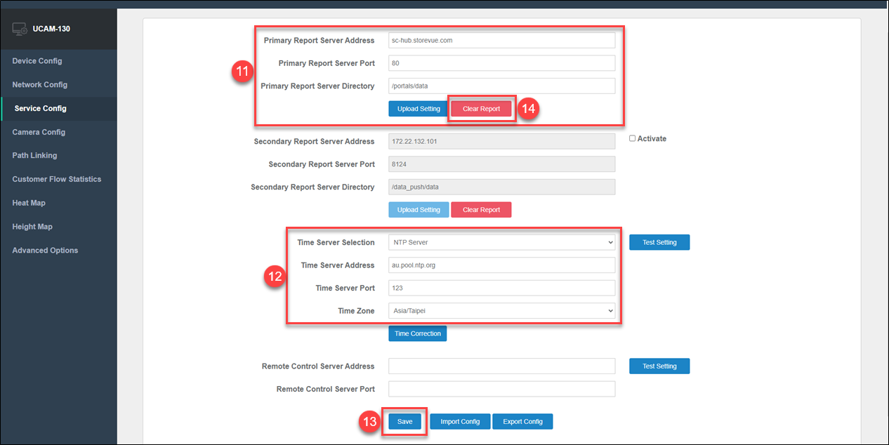

click on "Service Config" in the left-side function menu. UCAM-130_影像來源_5.png 11. Fill in the relevant information for the 《CountingBI》 service platform, following the example below:
  • Primary Report Server Address: sc-hub.storevue.com
  • Primary Report Server Port: 80
  • Primary Report Server Directory: /portals/data
12. Enter the valid NTP server address to enable the UCAM-130 camera to automatically synchronize the system time.
13. Click "Save" to apply the settings.
14. Click "Clear Report" to clear the temporary people flow records.

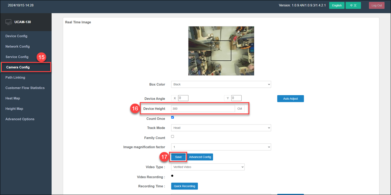

UCAM-130_影像來源_6.png 15. Click on "Camera Config" in the left-side feature list. 16. In the "Device Height" field, enter the actual installation height of the UCAM-130 camera from the ground. (Height unit: centimeters) 17. Click "Save" to apply the settings.

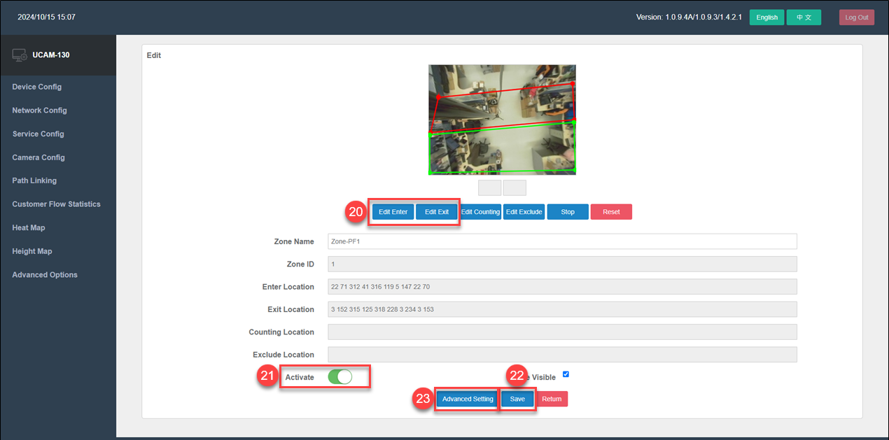

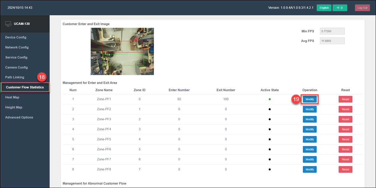

UCAM-130_影像來源_7.png 18. Click on "Customer Flow Statistics" in the left-side feature list. Next, you will need to define the detection areas for "Entrance" and "Exit." 19. In the first set of settings (Zone PF-1), click "Modify" to proceed to the next step.
UCAM-130_影像來源_8.png 20. Click "Edit Enter" and "Edit Exit" in sequence to define the detection areas for "Entrance" and "Exit." 21. Click "Activate" to enable this setting. 22. Click "Save" to apply the settings. 23. Click "Advanced Setting" to proceed to the next step.

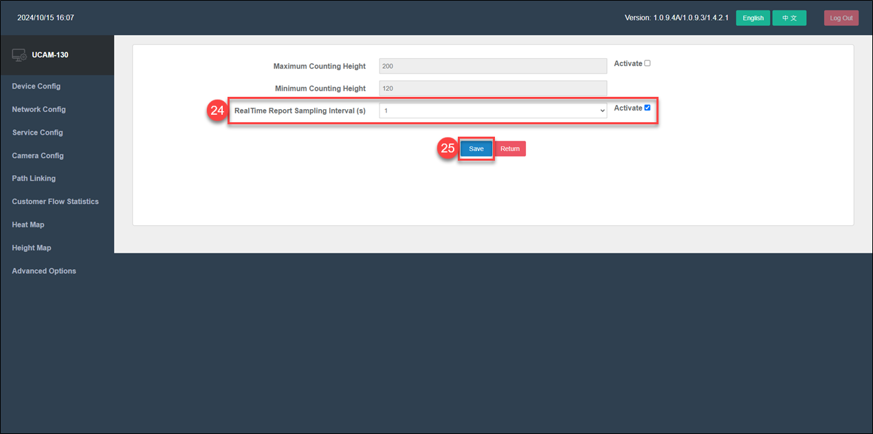

UCAM-130_影像來源_9.png 24. Check "Activate" for the RealTime Report Sampling Interval (s).
25. Click "Save" to apply the settings.

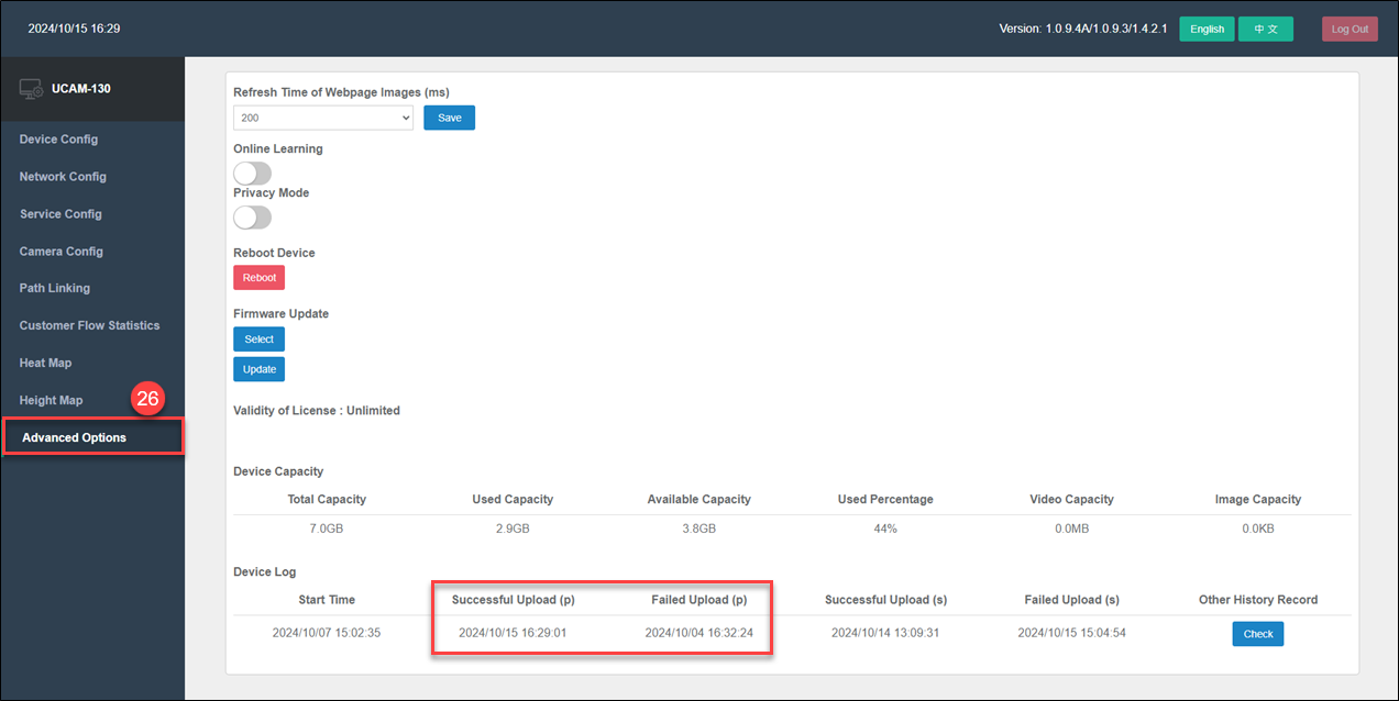

UCAM-130_影像來源_10.png 26. Select "Advanced Options" from the menu on the left, and check whether the time for Successful Upload (p) is later than the time for Failed Upload (p). If so, it indicates that the UCAM-130 camera is correctly configured to upload traffic data.
> Reminder: After this stage is complete, the UCAM-130 camera has been successfully registered to the designated site in the CountingBI service. Next, go to the "Subscription service website" to activate the UCAM device. Once activated, you can proceed to the CountingBI service to configure counting units related to the UCAM-130.

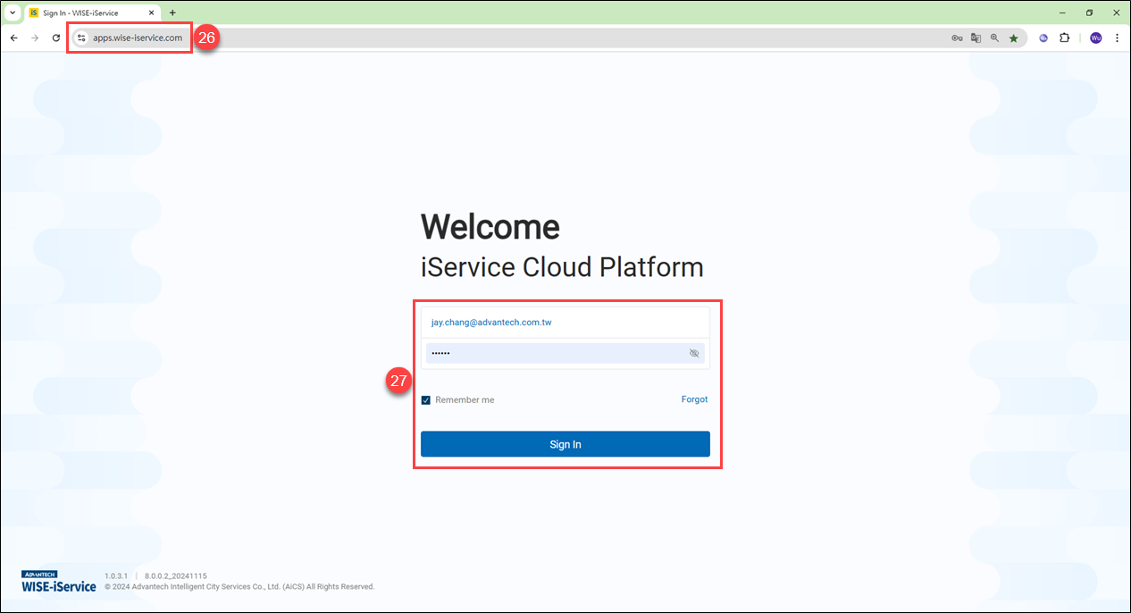

WISE-iService_Login.png 26. Open Chrome on any PC and connect to the WISE-iService cloud platform at https://apps.wise-iservice.com.
27. Enter your username and password, then click "Log In."

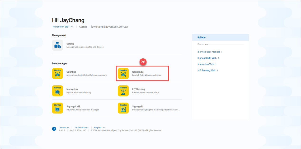

WISE-iService_CountingBI_1.png 28. Click on the "CountingBI" service entry.

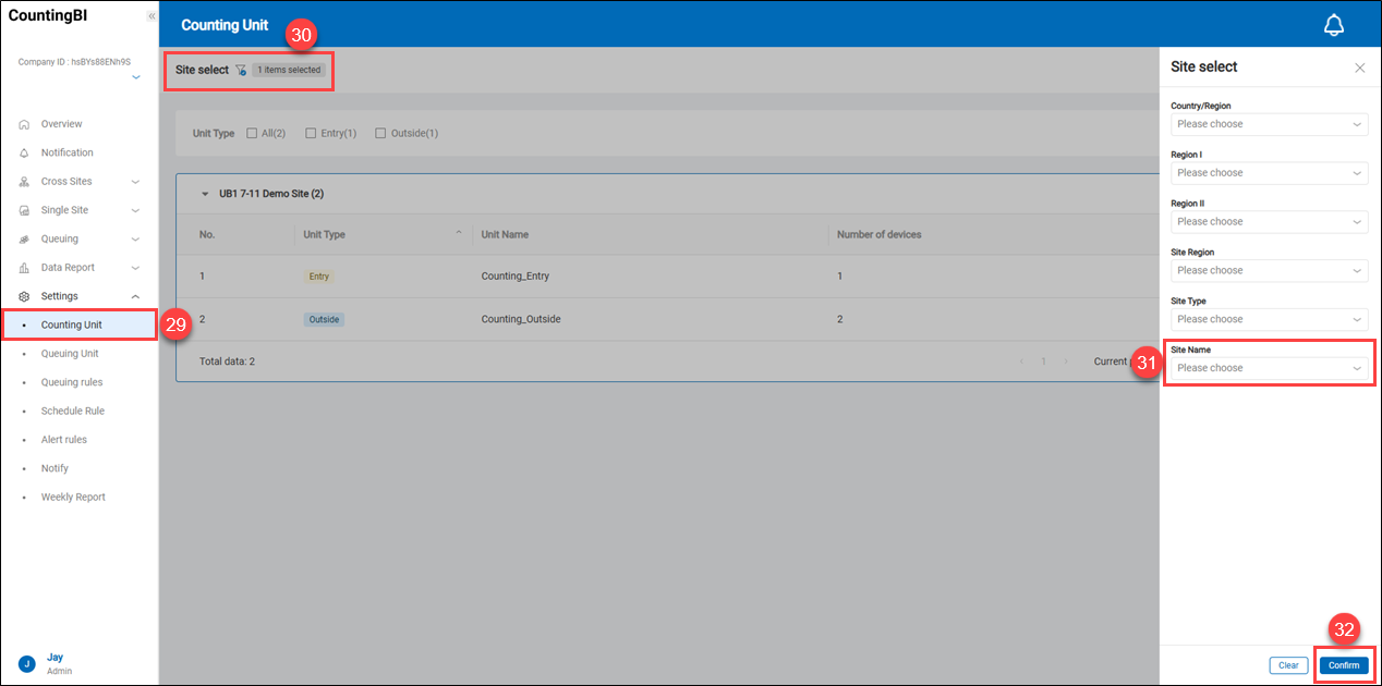

WISE-iService_CountingBI_2.png 29. Click on "Counting Unit." 30. Click on the filter icon icon_filter.png to open the filter menu. 31. Select the site where you want to add a counting unit. 32. Click "Confirm" to proceed to the next step, then click "+ Add Unit."

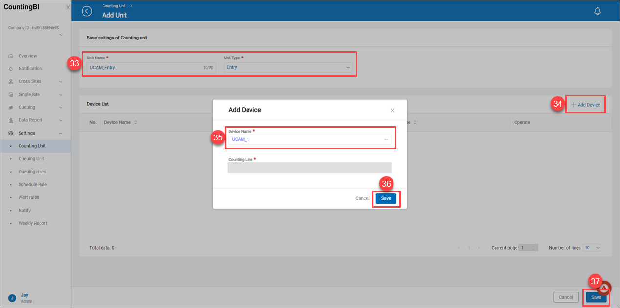

Quick Start_UCAM-130_VideoSource_11_Ori.png 33. Enter a unit name that allows users to easily identify this counting unit. In this example, select "Entry" as the "Unit Type" to count in-store foot traffic. 34. Click "+ Add Device." 35. In the "Device Name" dropdown menu, select the UCAM_1 device, which is the already registered UCAM-130 camera. 36. Click "Save" to apply the settings. 37. Click "Save" to confirm the settings.
At this step, the addition of the counting unit for "People Counting" in the《CountingBI》service is complete.

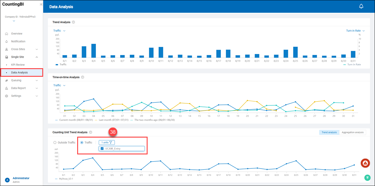

Quick Start_UCAM-130_VideoSource_12.png 38. Users can quickly view statistical data by selecting "Traffic" and the chosen counting unit under "Single Site -> Data Analysis" in the "Counting Unit Trend Analysis" section.
