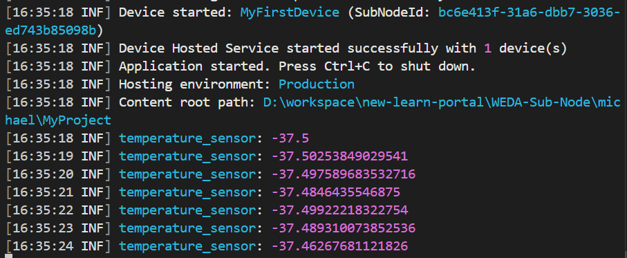

Advanced: Transform
Transform is the first processing stage in the Data Pipeline, responsible for performing numerical transformations on raw sensor values. SubNode includes three built-in transforms: linear/curve calibration, unit conversion, and large data chunking. Each transform can be configured via JSON or code and supports dynamic parameter updates from the cloud. Find out for more details at SubNode Github. Here is an example of how to configure a linear calibration transform for a temperature sensor:
1. devicecfg.json
"SubNode": {
"Name": "MyModbusDevice",

2. Run the application
dotnet run
Expected output:
subnode transform
Event Subscription for Transform Verification
The SubNode SDK provides two events for data pipeline monitoring:
  • DataReceived - Triggered before Transform, passes raw sensor data
  • DataProcessed - Triggered after Transform, passes transformed data

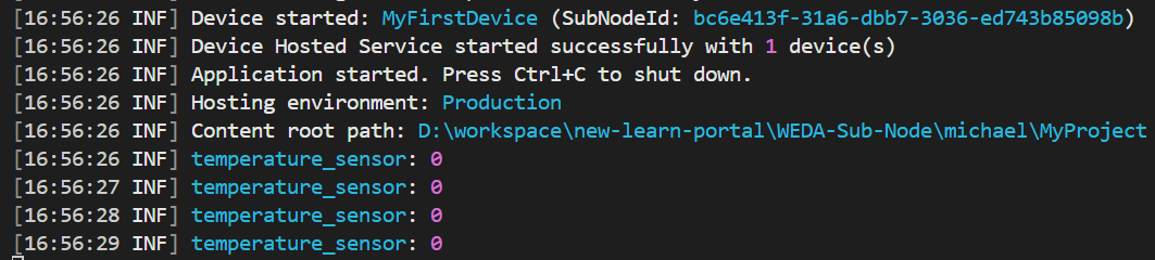

Advanced: DspFilter
DSP (Digital Signal Processing) Filter is the second processing stage in the Data Pipeline, executed after Transform. Unlike Transform, DSP Filters are typically stateful—they retain historical data to compute results (for example, a moving average requires previous values). SubNode includes three built-in DSP Filters, each maintaining independent state per sensor. Find out for more details at SubNode Github. Here is an example of ReluFilter configuration:
1. devicecfg.json

"DspPipeline": [
"Type": "relu",
"Enabled": true,
"Parameters": {}
dotnet run
Expected output:
subnode DSP

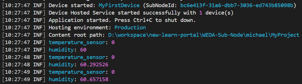

This tutorial demonstrates how to extend the WEDA Sub-Node framework by adding a humidity sensor. You will learn how to configure a new device, register it in the application, and simulate sensor data for testing purposes.
1. devicecfg.json
Add a humidity device configuration to the devicecfg.json file.
Editing content: devicecfg.json
"SubNode": {

// Add a new sensor configuration for humidity
"Name": "humidity",
"SensorGroup": "AI",
"Parameters": {
"RegisterType": "HoldingRegister",
"RegisterAddress": 2,
"RegisterCount": 2,
"DataType": "Float32"
2. appsettings.json configure simulator
"Name": "HumiditySensor",
"Type": "Humidity",
"StartAddress": 2,
"RegisterCount": 2,
"DataType": "Float32",
"SimulationParams": {
"MinValue": 40.0,
"MaxValue": 80.0,
"InitialValue": 60.0,
"ChangeRate": 0.5,
"NoiseLevel": 0.2
3. Run the application
dotnet run
Expected output:
Add a new sensor
