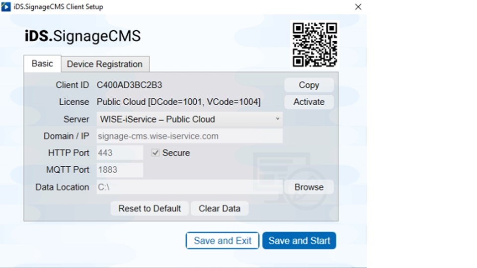

  • Domain/IP: The Public Cloud URL.
  • HTTP Port: By default, it is set to 443 (cannot be modified).
  • Secure: By default, it is selected (cannot be modified).
  • MQTT Port: By default, it is set to 1883 (cannot be modified).
  • Data Location: By default, it is set to C:\ (cannot be modified).
  • Reset to Default button: Restore to default settings.
  • Clear Data button: Remove all data.
  • Save and Exit button: Save changes and exit.
  • Save and Start button: Save changes and launch the signage software.

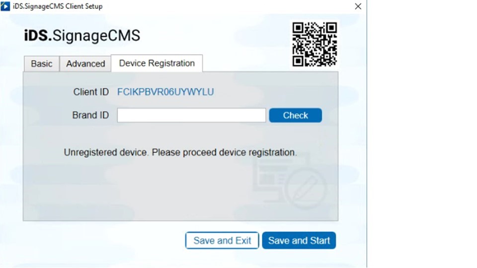

  • Client ID: The ID generated upon the first execution of Signage Client Setup.
  • Brand ID: The brand name to be filled in when registering the player to the public cloud.
  • Check button: After entering the Brand ID, click the “Check” button to verify its correctness. > Note: For detailed steps on public cloud registration, please refer to the quick guide.
