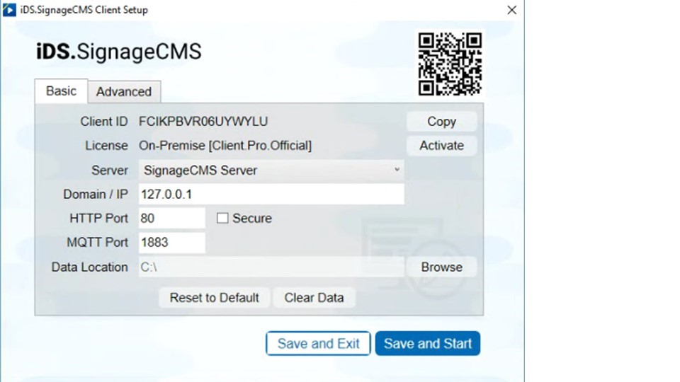

  • Domain/IP: Enter the URL of the private cloud, which can be either the hostname or the IP address.
  • HTTP Port: By default, it is set to 80.
  • Secure: Encryption option. When selected, changes the Port to 443. Default is unselected.
  • MQTT Port: By default, it is set to 1883.
  • Data Location: By default, it is set to C:\
  • Reset to Default button: Restore to default settings.
  • Clear Data button: Remove all data.
  • Save and Exit button: Save changes and exit.
  • Save and Start button: Save changes and launch the signage software.
> Note: The SignageCMS Server option will only be displayed after registering the serial number. After changing the player's connection port, please adjust the corresponding port in the server setup.
