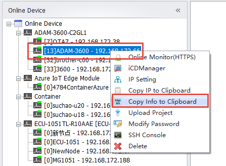

  1. In EdgeLink Studio, select the online page for the gateway you want to add to EdgeSync 360/EdgeHub, right-click, and choose "Copy device information to clipboard"

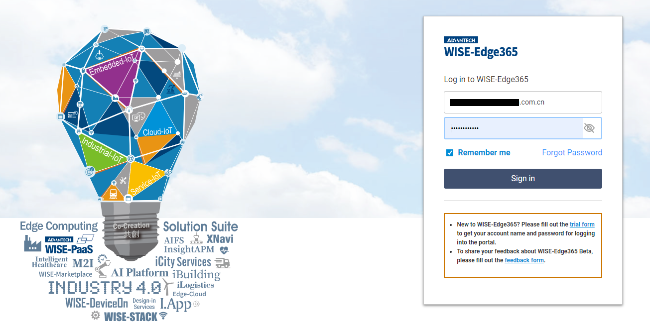

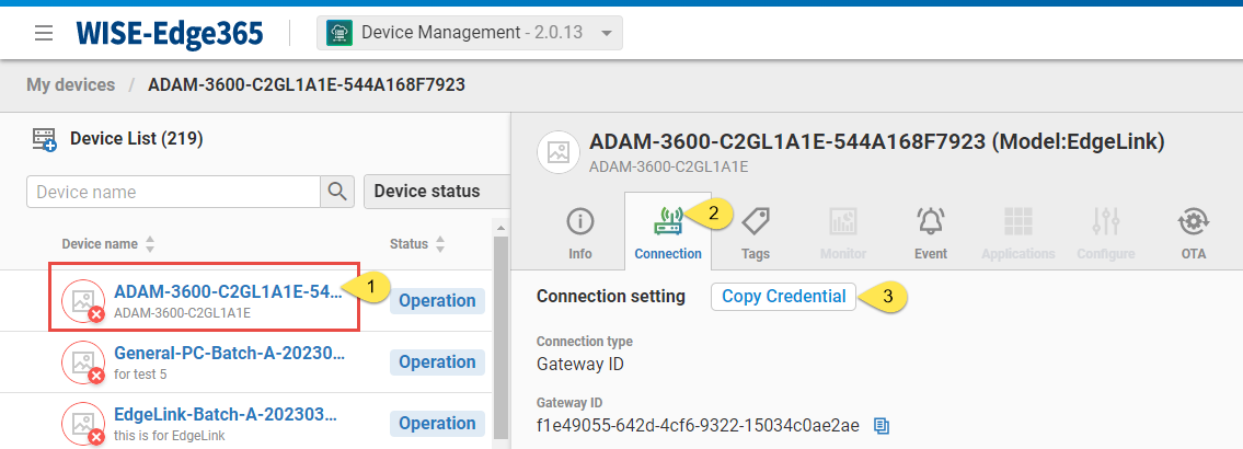

  1. Open the EdgeSync 360/EdgeHub login page, enter your username and password to log in

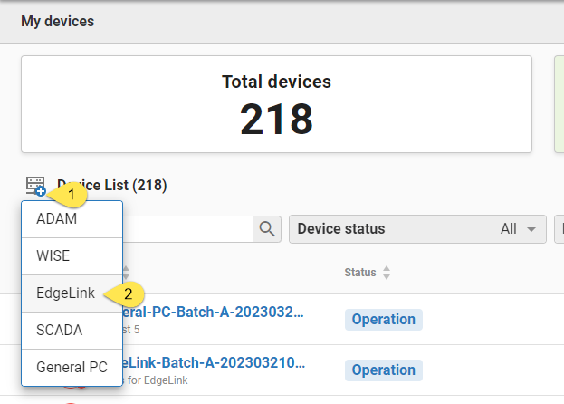

  1. Device Management

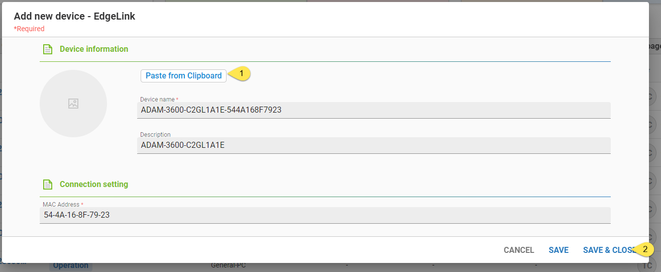

  1. Select the option to add an EdgeLink device
  1. Paste from Clipboard
  1. Click on the newly added device, and the device information will appear on the right side. Copy the "Credential" to the clipboard

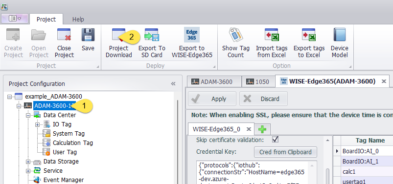

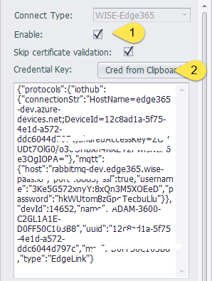

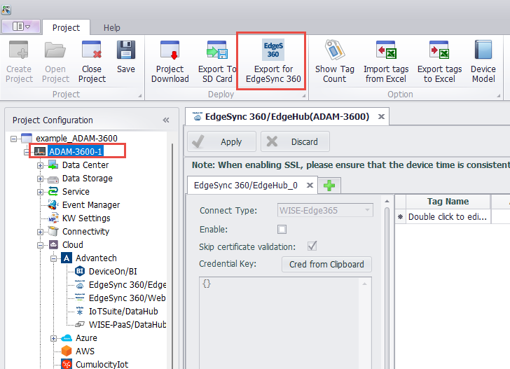

  1. Open the EdgeLink Studio project configuration page for EdgeSync 360/EdgeHub by selecting "Project" > "Cloud Service" > "Advantech" > "EdgeSync 360/EdgeHub", and enable the connection
  2. Paste the "Credential Key" into the corresponding field

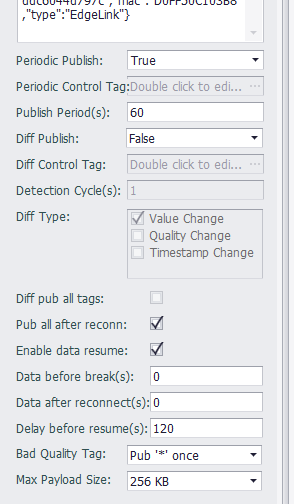

  1. Configure connection parameter, parameter description

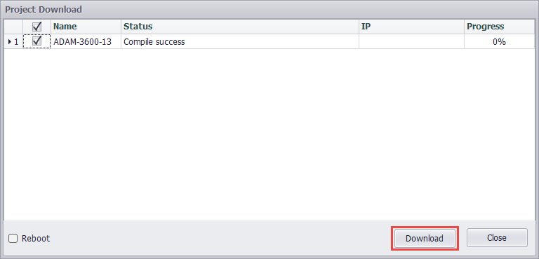

  1. Download the project file to the gateway

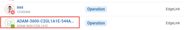

  1. View the device as online in EdgeHub

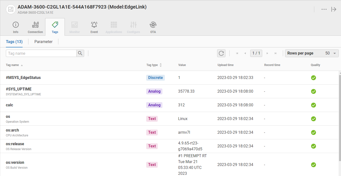

Uploading data to EdgeHub​
$\qquad$ The gateway is already online in EdgeSync 360/EdgeHub
  1. Click the online gateway---> Tags

    Method 1:Uploading project files to EdgeSync 360/EdgeHub through EdgeLink Studio

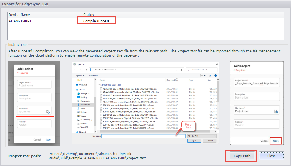

    step 1. Save the project and click "Export for EdgeSync 360"
    step 2. After seeing the "Compile success" message, click "Copy Path"
    step 3. Navigate to the project loading interface in EdgeSync 360/EdgeHub

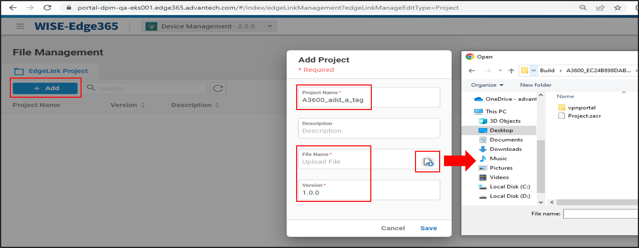

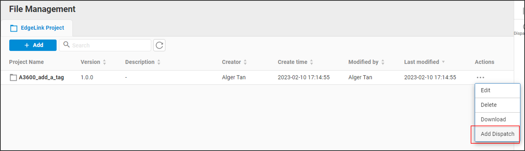

    Method 2:Directly add the project file generated by EdgeLink Studio to EdgeSync 360/EdgeHub
    step 1. Click on "File Management" in the EdgeSync 360/EdgeHub interface
    step 2. Add the project file

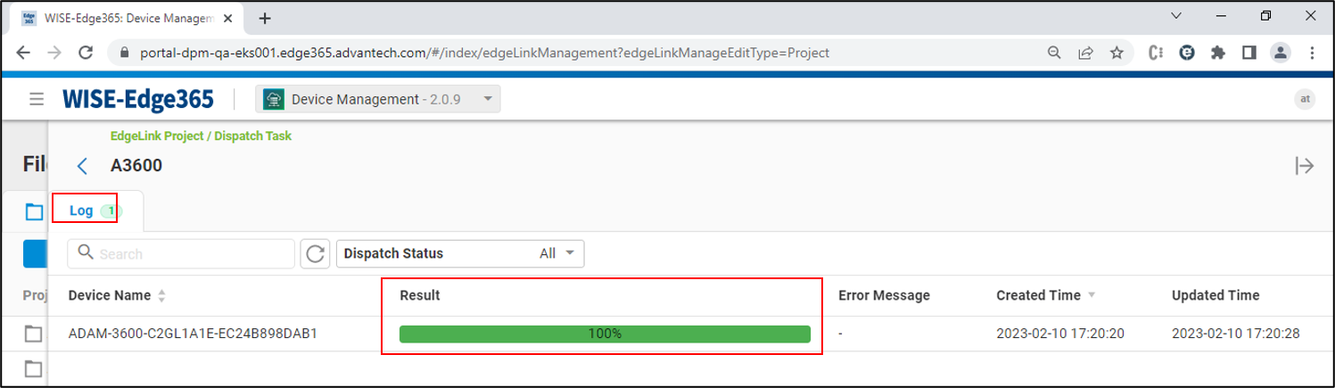

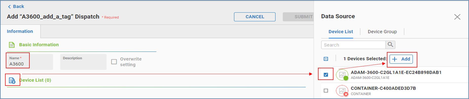

  2. Find the corresponding project file in EdgeSync 360/EdgeHub and click Add Dispatch

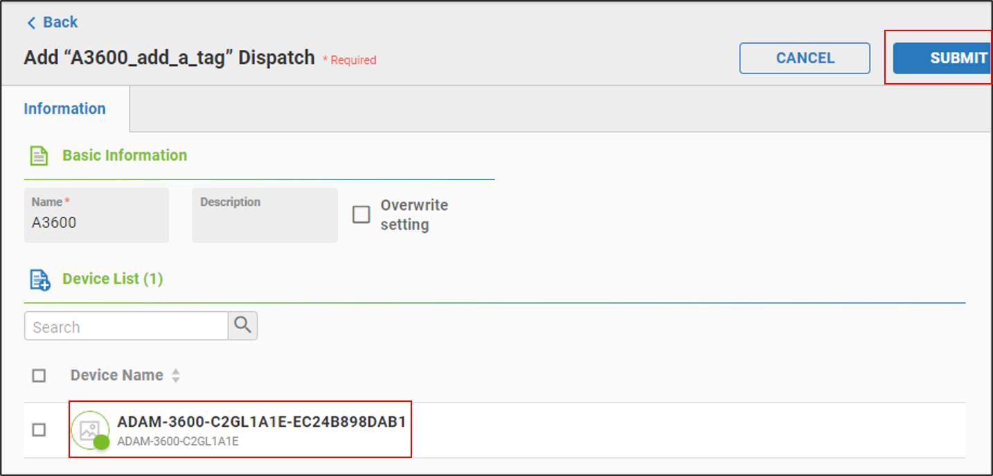

  3. Add a Dispatch, enter a dispatch name, and select the corresponding device
  4. Click "Submit" to confirm and submit the dispatch
  5. View the dispatch results

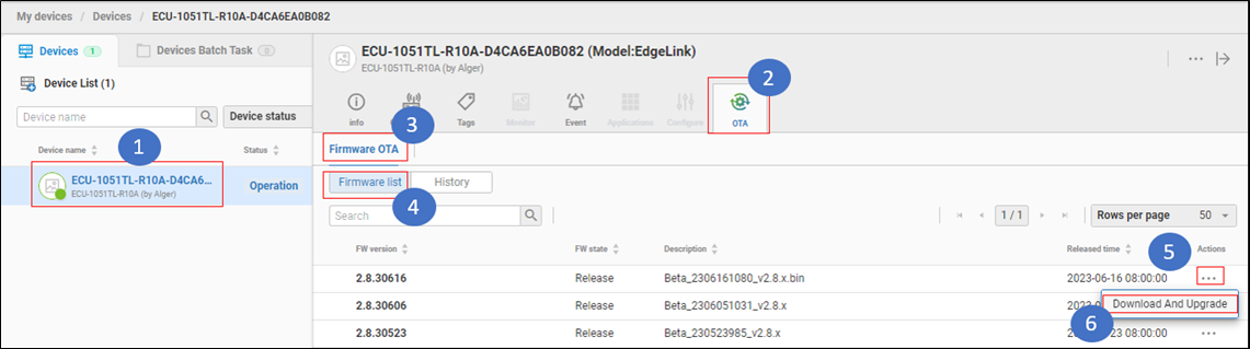

Upgrading the image on the gateway through EdgeHub​
  1. Confirm that the device is online and click to enter the functional page.
  2. Select the "OTA" feature
  3. Click on "Firmware list" under "Firmware OTA" to view all files available for upgrade
  4. Click on the "..." behind "2.8.30616" and select "Download And Upgrade"
  5. You will see the message "Set firmware download success..."

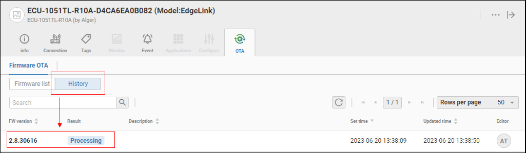

  6. At this point, the user can click on "History" under "Firmware OTA" to view the current upgrade status

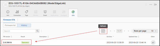

  7. Click on the "Refresh" button to refresh the current upgrade status until you see "Success", which means the upgrade was successful
parameter description​
parameterparameter description
Connection TypeMQTT type
EnableCheck the box to activate the connection for the current page, and the current page configuration will take effect
skip certificate validationCheck the box to skip the certificate validation
Periodic PublishPeriodic Upload Mode: Enable, Disable, and start by tag
Periodic Control TagSelect the periodic upload control tag. Upload data when the value of the point is not 0; do not upload data when the value of the point is 0
Publish PeriodPeriodic Upload Period, units seconds
Diff PublishTrigger Upload Mode: Enable, Disable, and start by tag Upload
Diff Control TagSelect the trigger upload control tag. Upload data when the value of the point is not 0; do not upload data when the value of the point is 0
Detection CycleDetection Period for tag Change Detection
Diff Typethe type of Diff Publish
Diff pub all tagspub all tags in list when Diff Publish
Pub all after reconnWhen EdgeLink establishes a connection with the cloud, does it upload the current values of all points once to the cloud, with enabling sending and disabling not sending? The default setting is enabling sending
Enable data resumeEnable switch for resume upload from break
Data before breakDefault: 0, resume uploading data from the most recent n seconds before the disconnection
Data after reconnectDefault: 0, resume uploading data until the most recent n seconds after the reconnection
Delay before resumeDefault: 120, resume uploading data after an interval of n seconds after the reconnection
Bad Quality TagUpload mode for Tag Quality not equal to 0 (GOOD):Pub * once; Pub * always; Still pub value; Don't pub

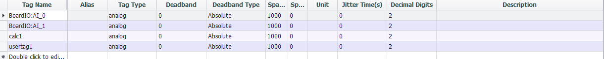

  • Tag Name: Double-click this field to add or select a tag in the device.
  • Alias: Set the name when uploading data. Use the tag name as the data name when the alias is empty.
  • Tag Type: Displays the data type of the tag. This item is a read-only item and cannot be modified in this tag table. If you need to modify it, please modify the original tag attribute in the data center.
  • Deadband Type: Used to configure the change detection method of tag values. There are two ways: absolute value and percentage. When the type is configured as an absolute value, the difference between the current tag value of the tag and the last uploaded tag value is taken as an absolute value and compared with the Deadband, and if it is exceeded, the tag is considered to have changed; When the type is configured as a percentage, the difference between the current tag value of the tag and the last uploaded tag value is taken as an absolute value and compared with the last uploaded tag value. If the change exceeds the Deadband, the tag is considered to have changed.
  • Deadband: Used to specify the Deadband value of the tag detection. The value change of the tag does not trigger the tag value change within the threshold.
  • Unit: Read-only item, when the Deadband type is percentage, a percent sign is displayed to distinguish it from the absolute value.
  • Jitter time: The unit is second. When the detected tag value exceeds Deadband, verification of jitter time will start. When the tag value is detected as exceeding the Deadband within the specified jitter time, it will be finally judged as a little value change, and the changed value will be uploaded at this time, otherwise it will be judged as tag value jitter. Not uploaded.
  • Decimal Digits: The number of digits after the decimal tag for specifying the analog tag value. The default is 2. When the actual tag value has only one integer value, you can set this field to 0 to save data traffic.
  • Description: The description of the tag. This item is a read-only item and cannot be modified in this tag table. If you need to modify it, please modify the original tag attribute in the data center.
