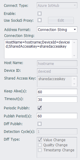

When connecting to the Microsoft Azure cloud, the connection type must be Azure IoTHub, and the client needs to configure the connection string provided by the cloud.
Users can directly edit the connection string, or generate a connection string by setting the attributes: Host Name, Device ID, and shared Access Key.
Since v2.8.1, the bottom layer of EdgeLink uses the Microsoft Azure IoT SDK to connect to the Azure IoT Hub, so the communication-related parameters other than the connection string do not need to be set.
If you are using this plugin in the environment of an IoT Edge-launched EdgeLink Container, you do not have to enable resumable uploads, as IoT Edge will cache the transferred data.
