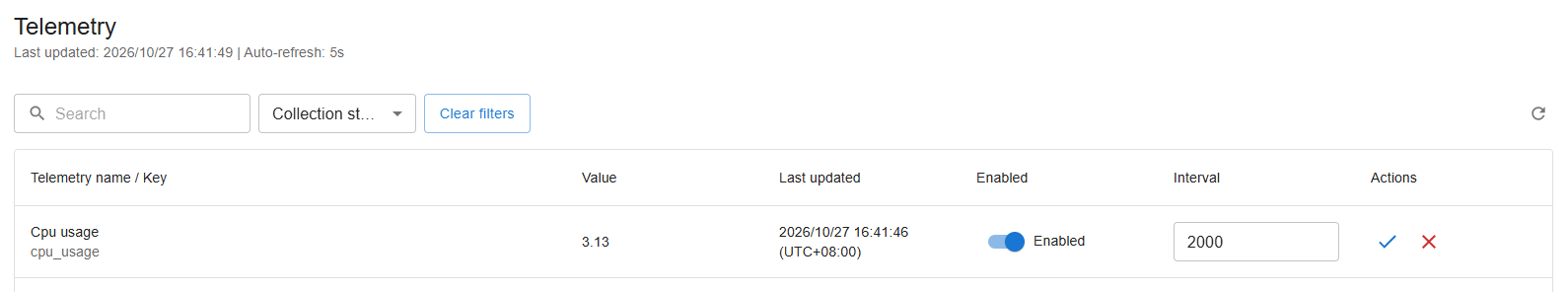

In WEDA Console, for the WEDA Node shown here: In its Telemetry tab, select the sensor row's edit icon, adjust Enabled and Interval, then use the checkmark to save or the cross to cancel. Follow the configuration and apply-result checks below to verify the requested behavior.
CPU usage telemetry row in edit mode, with Enabled switched on, Interval set to 2000, and checkmark and cancel controls.
Edit the selected sensor row. The reporting interval uses milliseconds; 2000 represents two seconds.
