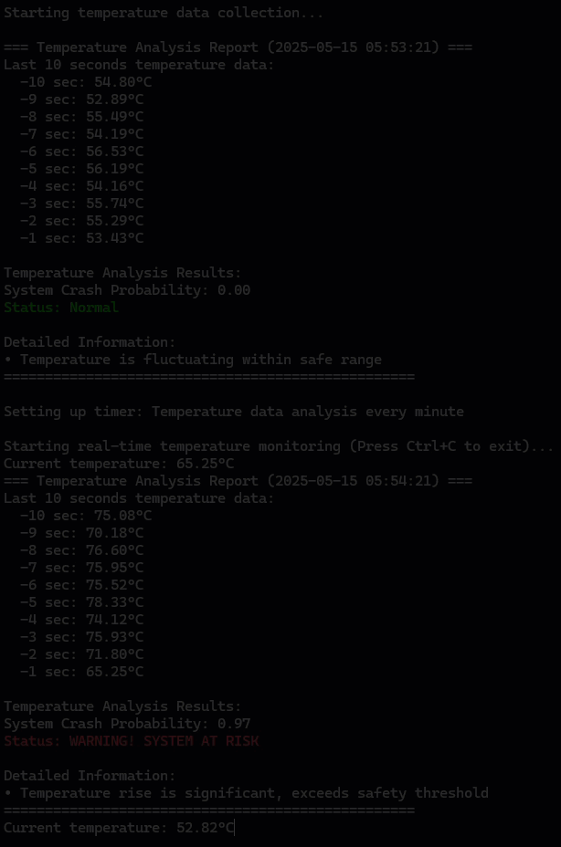

  8. Run the monitoring system.
    python3 ai.py
    Monitoring
Summary of the Demo
This demo serves as a simple proof-of-concept to demonstrate how you can:
  1. Utilize GPU Resources: Verify that our container effectively accesses and utilizes GPU hardware resources
  2. Train Models on GPU: Show that AI models can be trained using GPU acceleration within the container
  3. Perform Inference: Confirm that predictive functionality can run efficiently with GPU support
The temperature monitoring scenario is a straightforward example chosen to illustrate these capabilities, not to represent a production-ready monitoring system.
