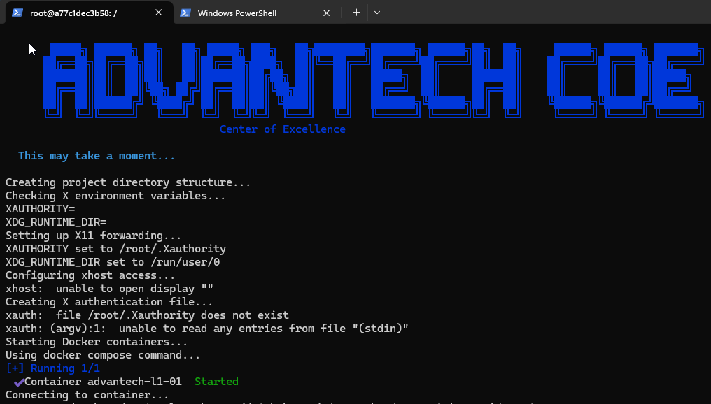

Run the container
  1. Visit the x86 EdgeSync Base Container website to review container details, and system requirements.
  2. Download the required Docker Compose file and build script from GitHub
  3. Place both files (build.sh and docker-compose.yml) in the same directory on your device.
  4. Run the build script with the following commands:
    chmod +x build.sh
    sudo ./build.sh
  5. After running build.sh, you will enter the container with a bash UI After the build.sh

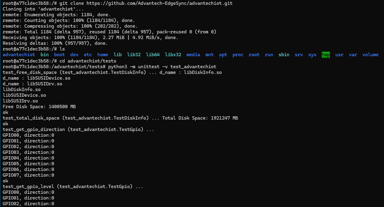

  6. (Option) You can download the test sample code and run the test code in the container
    git clone https://github.com/Advantech-EdgeSync/advantechiot.git
    cd advantechiot/tests
    python3 -m unittest -v test_advantech_edge
    Run the test code

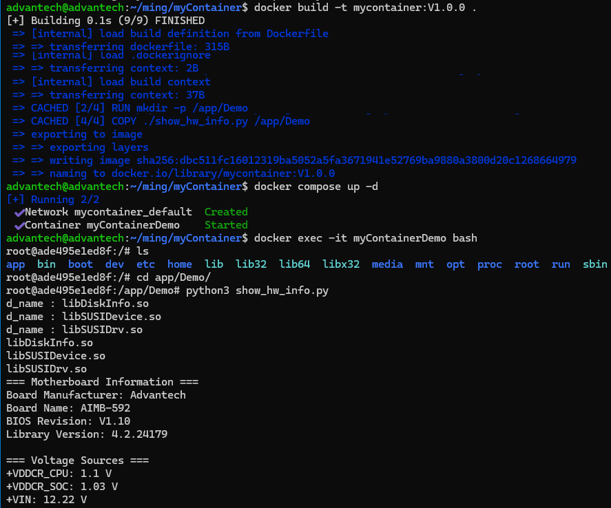

  4. Build your own container
    docker build -t mycontainer:V1.0.0 .

  7. Testing the application, make sure you are in the myContainer directory
    docker compose up -d
    docker exec -it myContainerDemo bash
  8. In the container, execute the application
    cd app/Demo/
    python3 show_hw_info.py
    Sample result:
    === Motherboard Information ===
    Board Manufacturer: Advantech
    Board Name: AIMB-592
    BIOS Revision: V1.10
    Library Version: 4.2.24179
    === Voltage Sources ===
    +VDDCR_CPU: 1.1 V
    +VDDCR_SOC: 1.03 V
    +VIN: 12.22 V
    +V5SB: 5.04 V
    +VBAT: 3.06 V
    === Temperature Sources ===
    CPU Temperature: 51.9 °C
    System0 Temperature: 46.2 °C
    System1 Temperature: 46.7 °C
