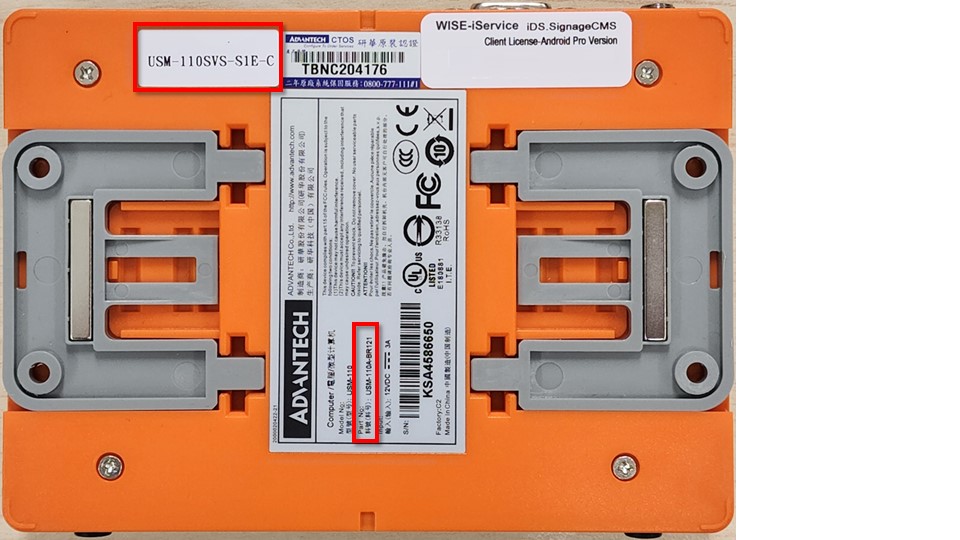

Check Model on back side

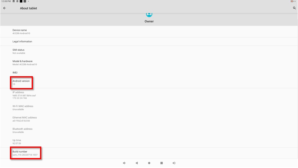

Check build number & system version in system
Go to Settings --> About Tablet --> Check incuding Build Number & Android version. 投影片5.JPG

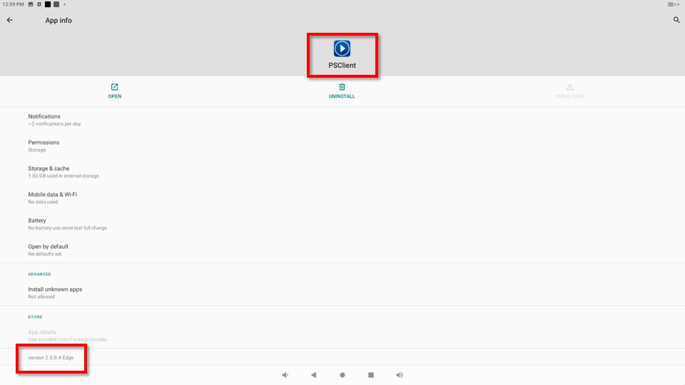

Check iDS.SignageCMS version

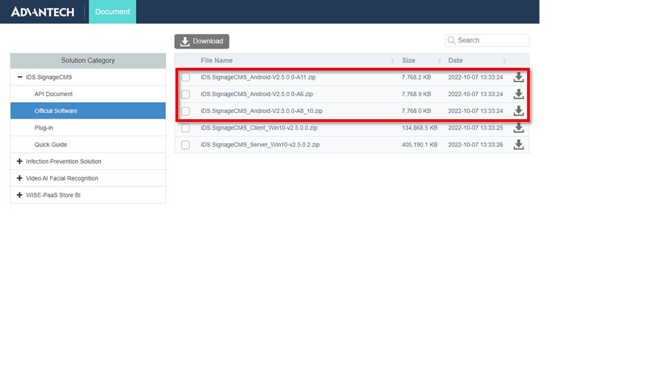

Software Download
Step 1. Open Chrome or Edge browser, input , find file in iDS.SignageCMS-->Official Software cateory, you may find latest version. Please base on model table to download correct version. 投影片7.JPG

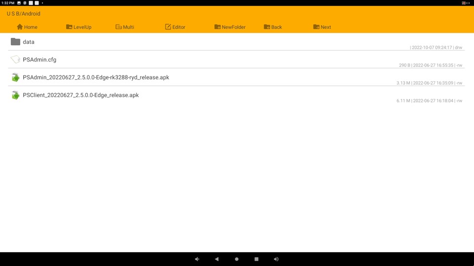

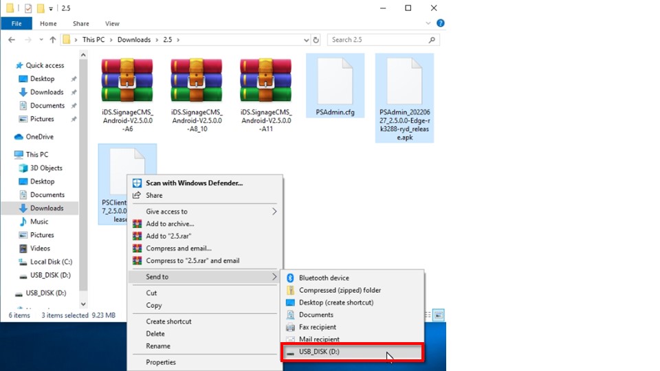

Step 2. When the file has been downloaded, please unzip the file and copy it to USB drive(FAT32). 投影片8.JPG

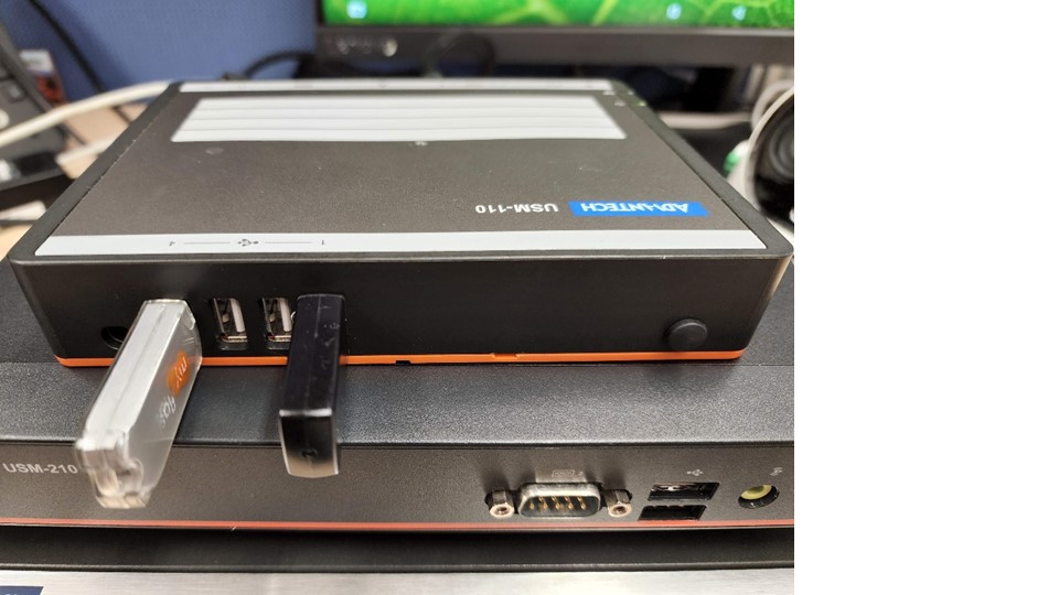

Step 4. Click Explorer APP, then go to unzip path on USB drive, install PSAdmin and PSClient apk files. >- please accept the permission if popup the message.

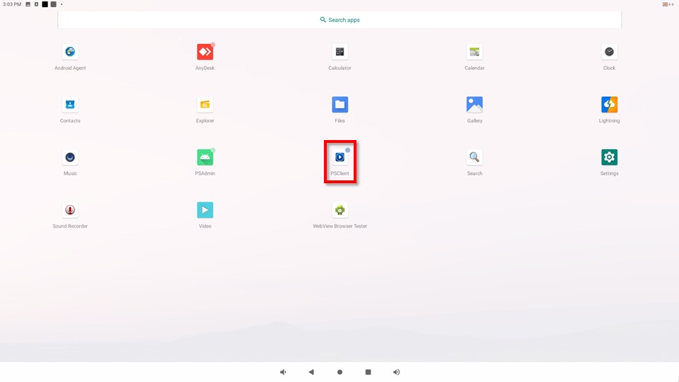

Step1. Click on the SignageCMS Client App icon to access the main program for digital signage management. IDS Client9.png

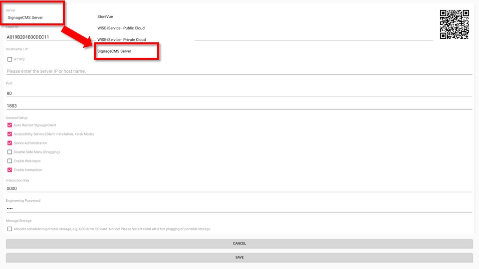

Step2. Click "Advanced setting" to enter the traditional setting mode. IDS Client10.png

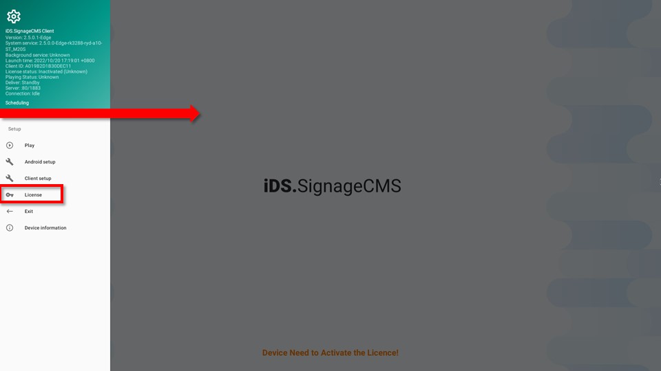

Step3. Move mosue cursor to left side on SignageCMS screen, hold mouse left button and move to right side, the menu bar will show on left side, then select Advanced Setting. IDS Client11.png
Step 5. Move mosue cursor to left side on SignageCMS screen, hold mouse left button and move to right side, the menu bar will show on left side, then select license. >- Press keyboard menu button has same function.

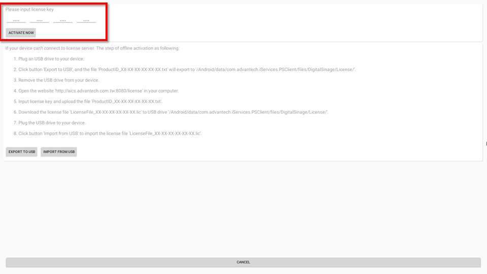

Step 6. Please input 16 digit code license, press Activate Now button, it will show success message. 投影片16.JPG

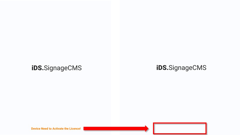

Step 7. When activate successful, the screen "Device Need to Activate the License" will disappear. 投影片17.JPG
