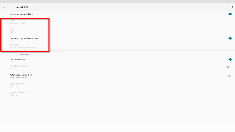

Step1. Switching Time Zone and Setting the Time > Time zone and time settings are crucial for the player. Incorrect settings may affect playback timing and sequence.

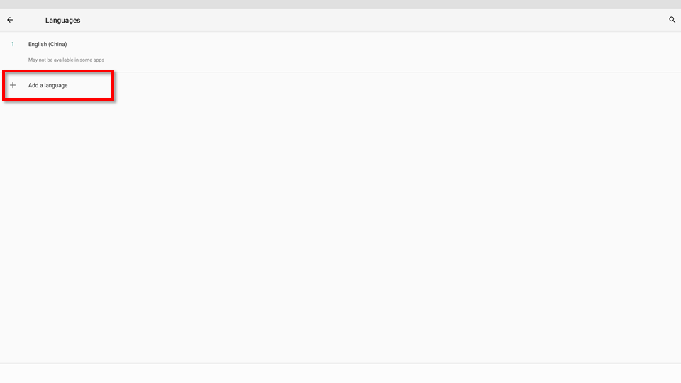

Step2: Changing Language(options) By default, the system is set to English. Please add the corresponding language based on your region. Settings --> System --> Languages & Input --> Languages --> Add a language Languages.png

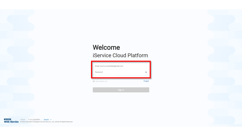

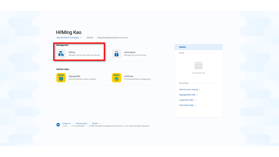

Step1: Opening the Browser Launch Chrome or Edge browser. , Entering Username and Password to Log In > If you do not have an account or password, please contact the brand manager to create one.
Step2: Click on Settings IDS Client41.png

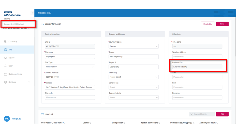

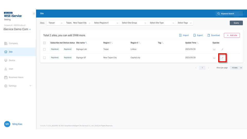

Step3: Location Management, In the Location Management section, select the store where you want to register the device. Click on the 編輯.jpg"Edit" button. > If you cannot find the desired store for registration, please contact the administrator to add it.
Step4: Record Company ID and Device Registration Code,Take note of the Company ID and Device Registration Code. You will need to input these details on the player later.

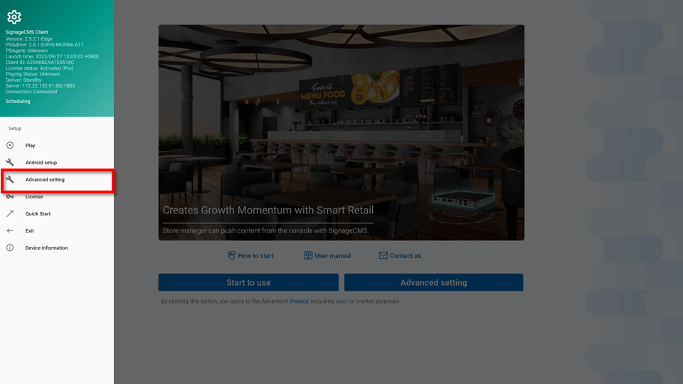

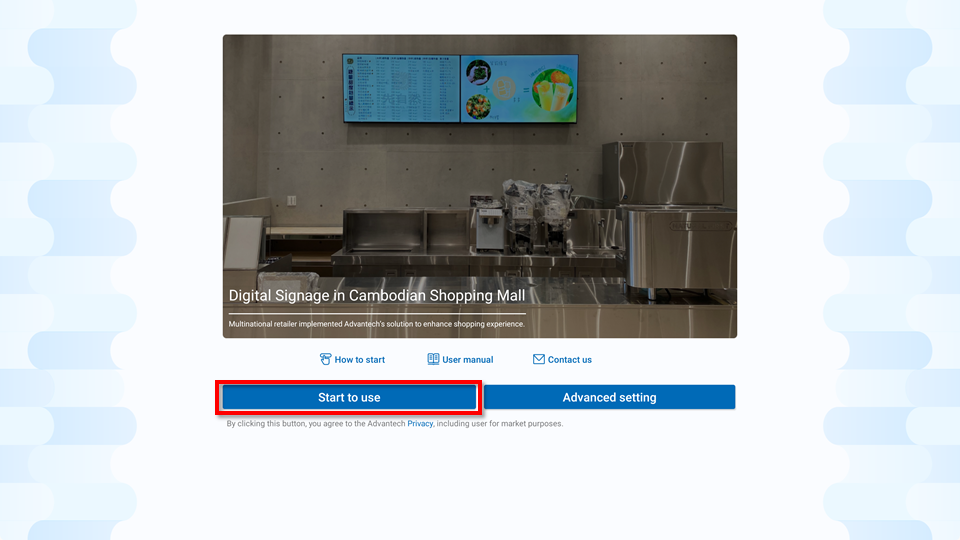

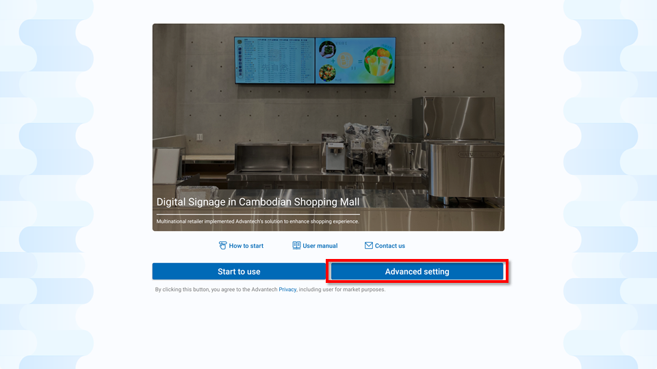

Step2. Click "Start to use" proceed to the next step. If you wish to use traditional settings, click on "Advanced Settings" and go to section 2.1.2 Advanced Setting Mode for further configuration.

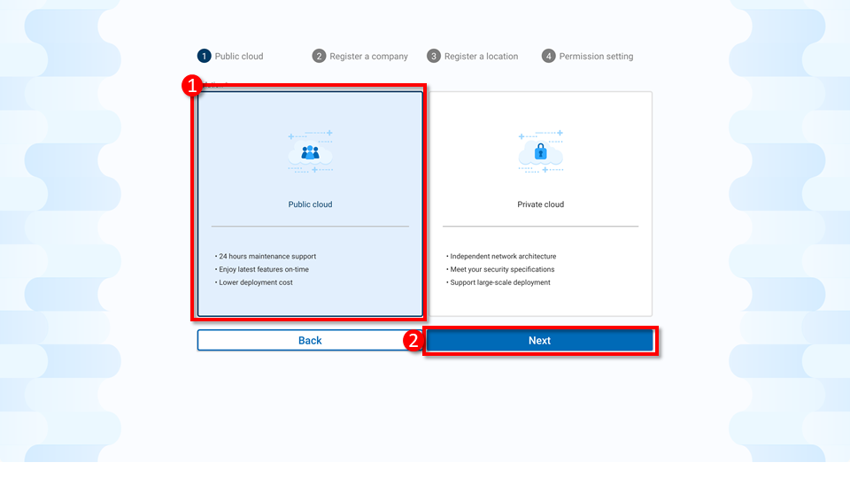

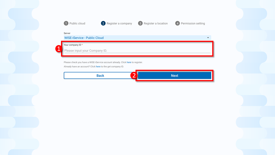

Step4. After entering the recorded Company ID value into the Company ID field, click "Next". IDS Client4.png

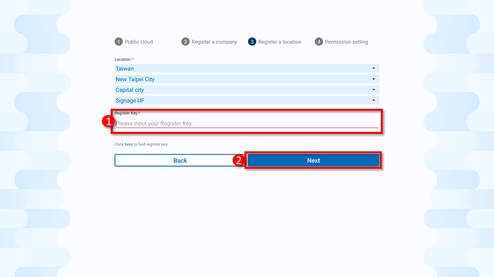

Step5. Choose the location where you want to register the device. Then, enter the Device Registration Key value into the Registration Key field and click "Next". IDS Client5.png

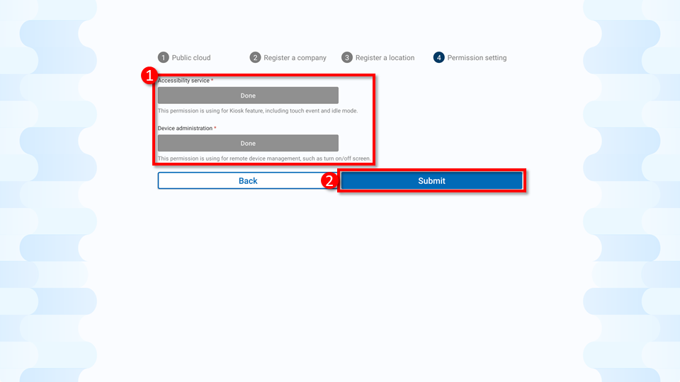

Step6. In this step, you will need to enable the relevant services. Gray buttons indicate that the service has already been enabled. Please click "Submit" to proceed to the next step. > If a button appears in blue, it means the service is not yet enabled. Please click to grant the necessary permissions in sequence.

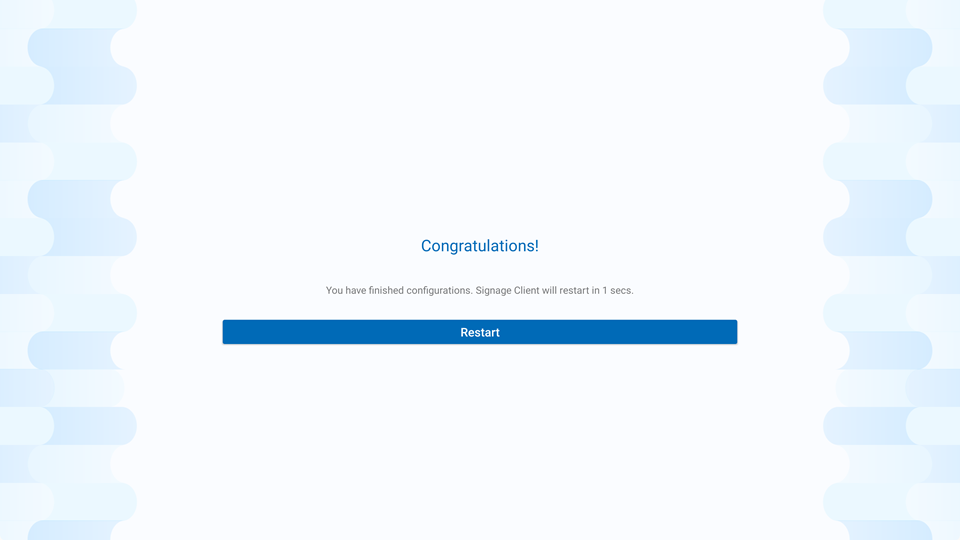

Step7. Initialization setup is complete. The player will start in three seconds, or you can press the "Restart" button. IDS Client7.png

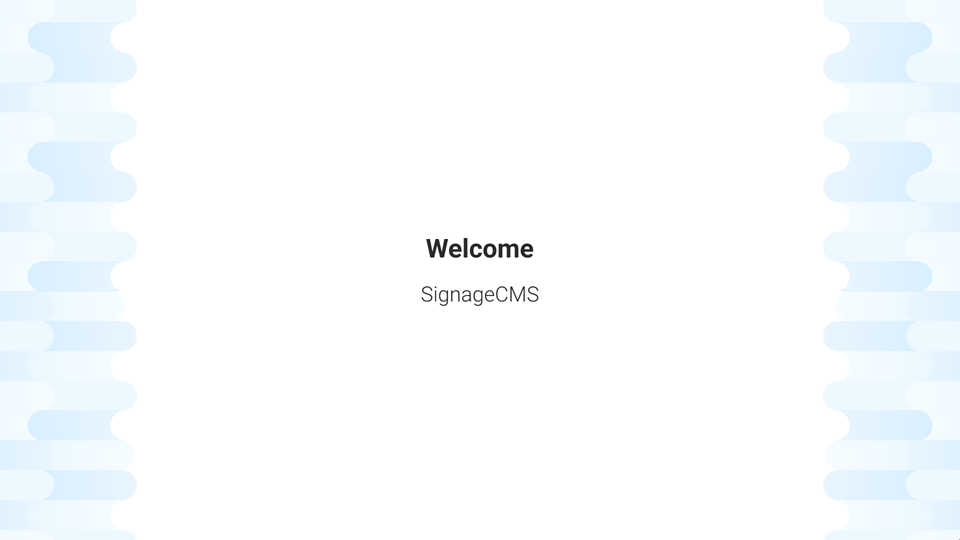

Step 8. After completion, the SignageCMS main screen will appear. IDS Client8.png

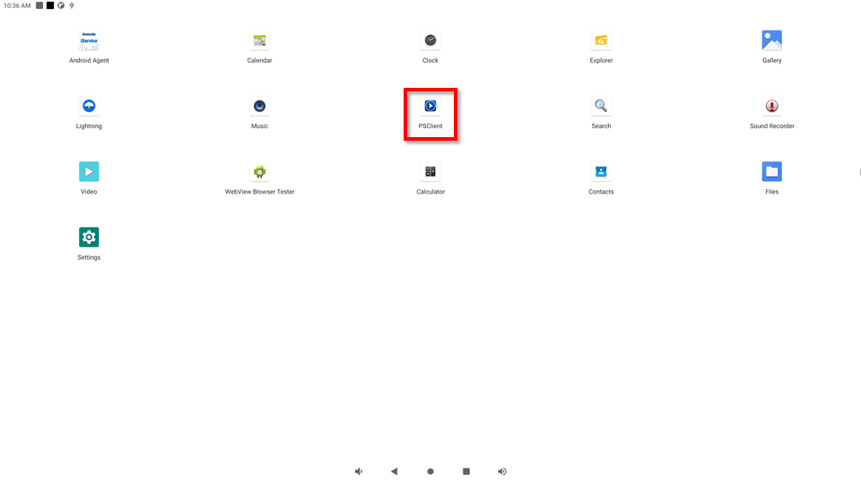

Step1. Click on the SignageCMS Client App icon to access the main program for digital signage management. IDS Client9.png
Step2. Click "Advanced Settings" to enter the traditional setting mode. IDS Client10.png

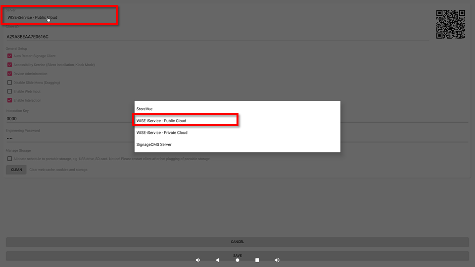

Step4. Select "WISE-iService - Public Cloud", then click the "SAVE" button to complete. IDS Client12.png

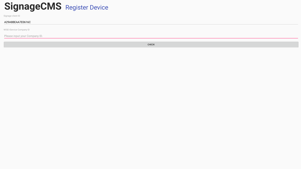

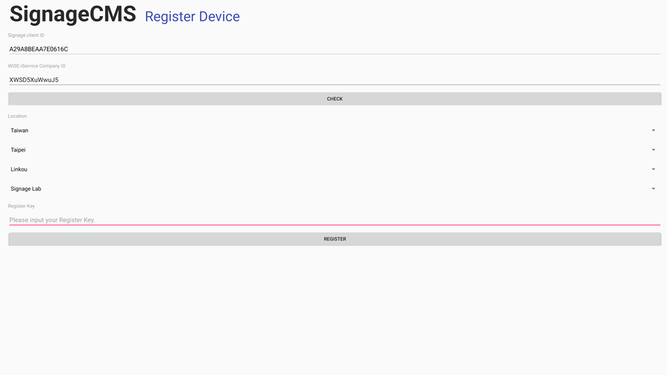

Step6. Enter the Company ID value that you just recorded into the Brand ID field. Afterward, click the "Check" button. IDS Client14.png

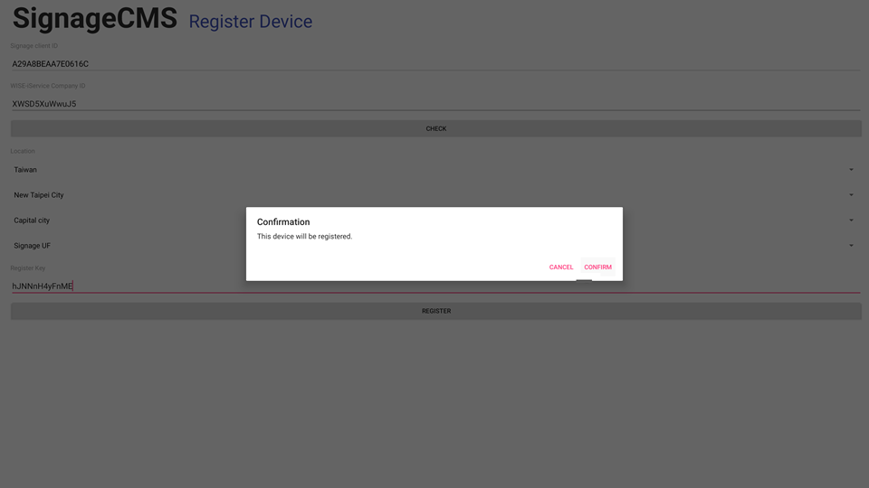

Step7. Select the store where you want to register the device. Then, enter the Device Registration Key value into the Register Key field and click the "Register" button. IDS Client15.png
Step8. Click the "Confirm" button to proceed with the registration process. IDS Client16.png

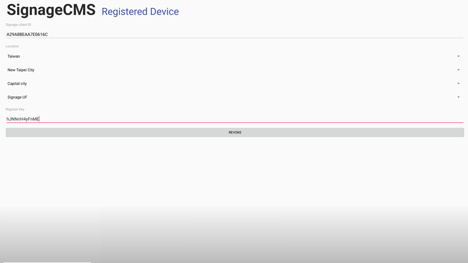

Step9. If you see this screen, it means the registration was successful. IDS Client17.png

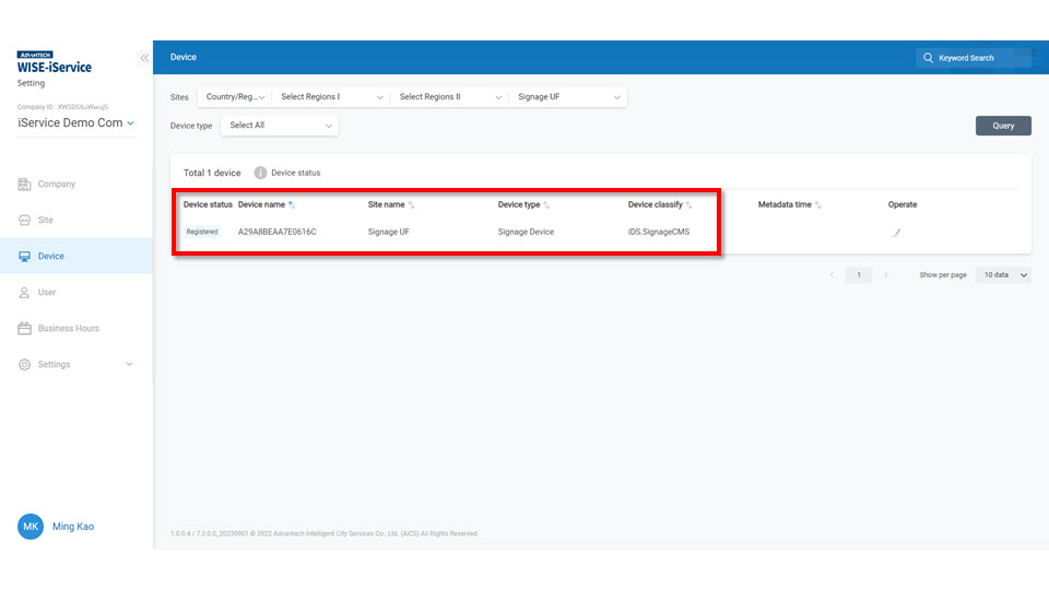

Step 1. Go to the device management section where you can see that the device has been successfully registered and it shows as "Registered". IDS Client18.png

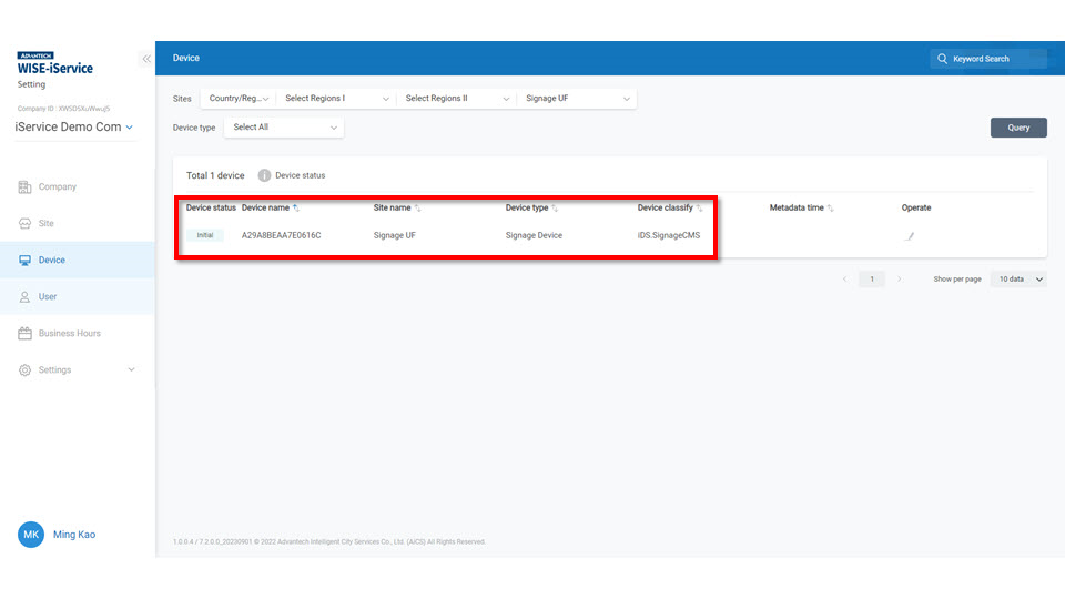

Step 2. Contact OP (Operator) and have them assist in activating the cloud serial number. Once completed, the device status will change from "Registered" to "Initial," indicating that programs can now be sent to the player. IDS Client19.png

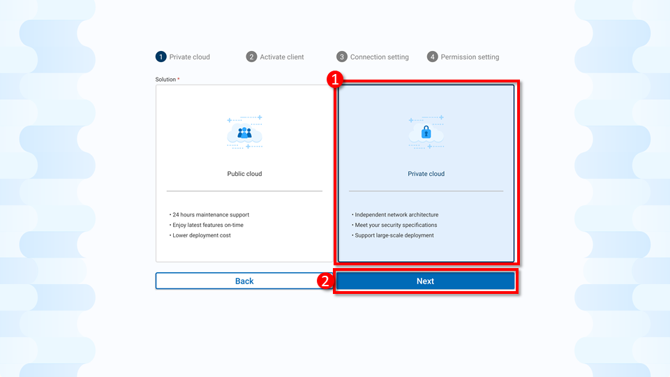

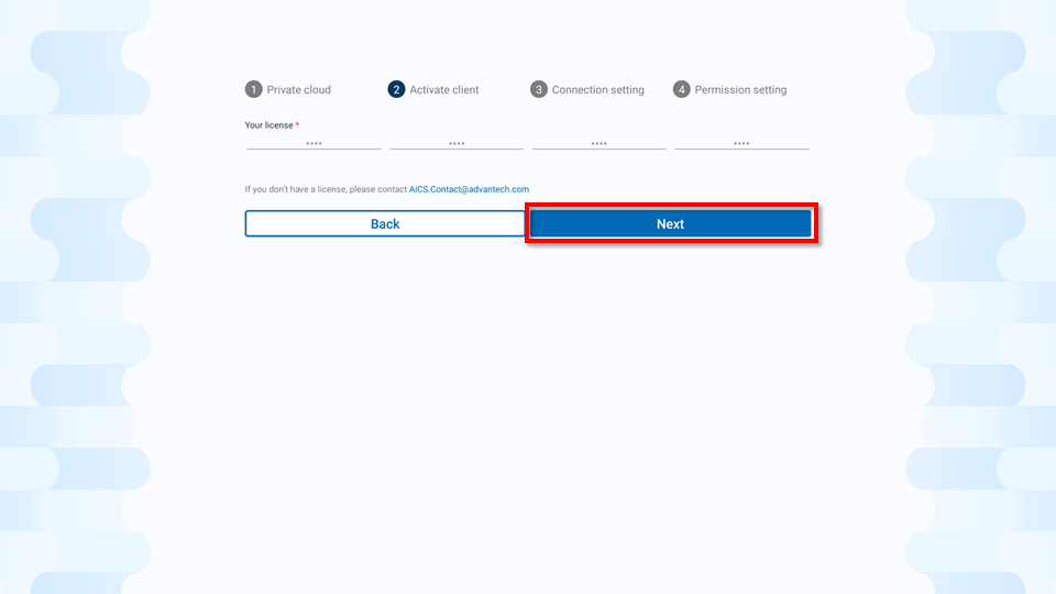

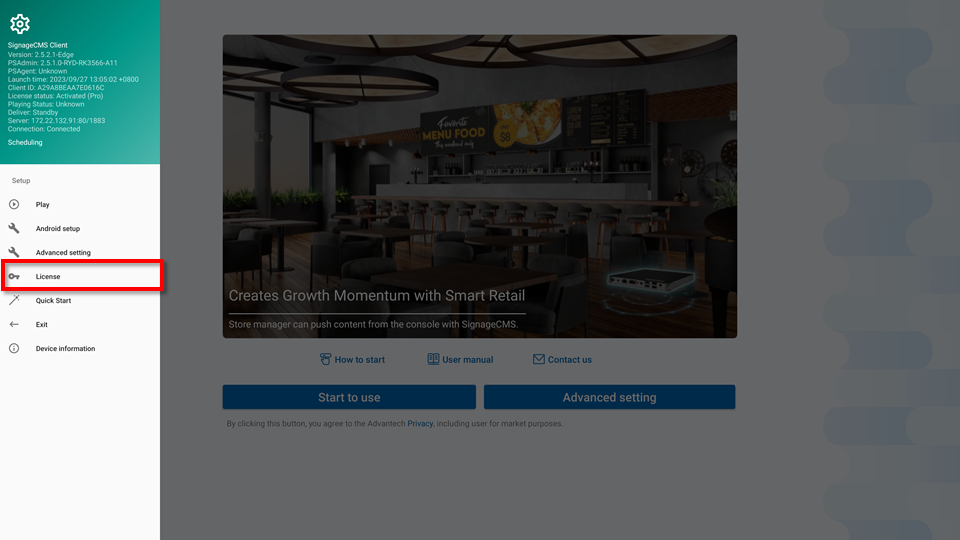

Step4. If you see a dot symbol above the serial number, it means it has already been activated. Please click "Next" to proceed. > If you do not see a dot symbol, please enter the authorization code and click "Next" to activate the serial number.

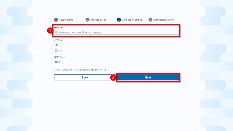

Step5. Please enter the SignageCMS server's IP address or domain name. Once completed, click the "Next" button. IDS Client24.png

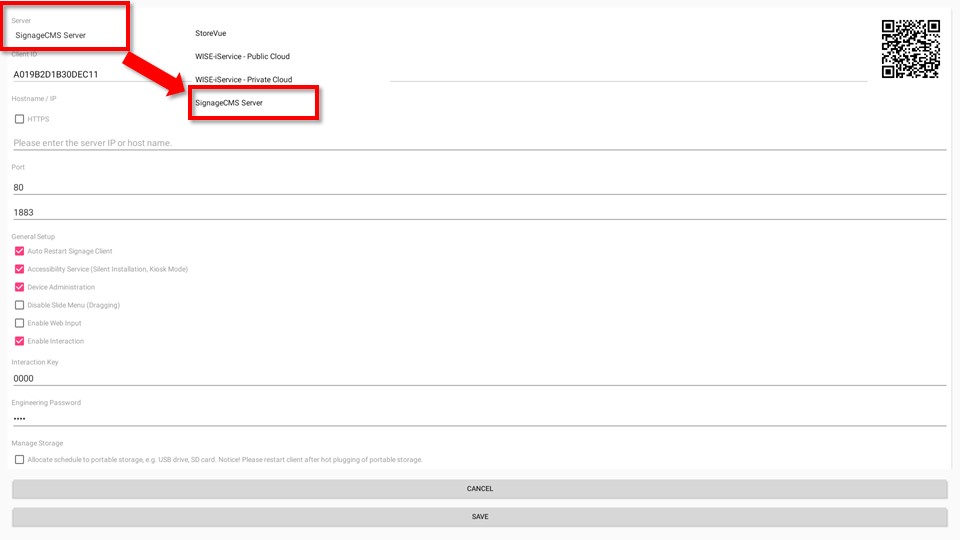

Step4. Confirm the server location by selecting "SignageCMS Server". > f you cannot choose "SignageCMS Server," it means that this device has not been activated with a serial number. Please go back to "Step 2: Serial Activation."

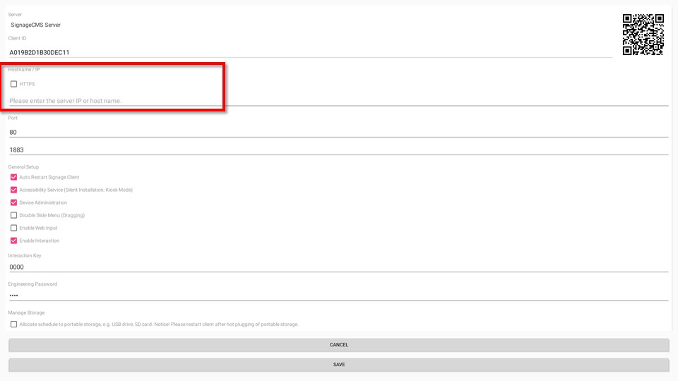

Step5. Set the server location as either the Domain or IP address. 投影片24.JPG

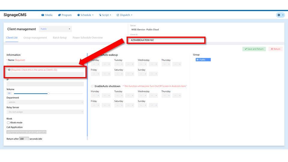

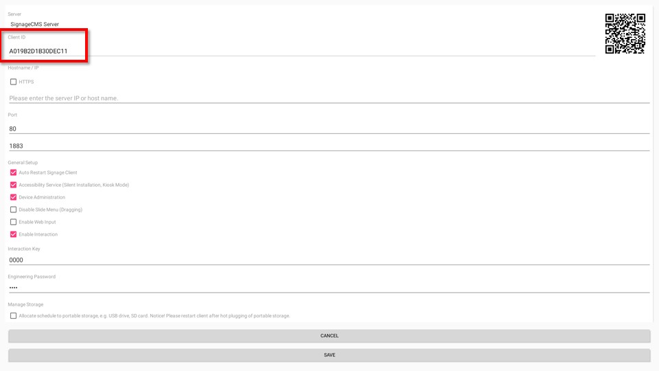

Step6. Record the Client ID, then click "SAVE" to return to the main screen. 投影片25.JPG

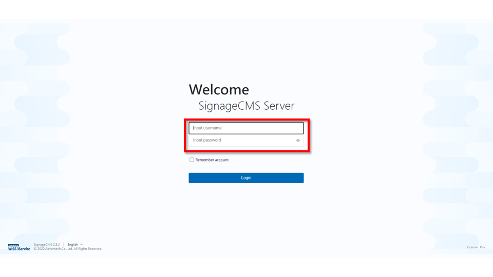

Step7. Open Chrome or Edge browser, enter the server's location (http://IP.ADDRESS/PSN), for example, http://127.0.0.1/PSN. Input your login credentials. At the bottom left corner, you can select the preferred language for display. > Enter the login credentials, with the default username and password for SignageCMS server being admin/admin.

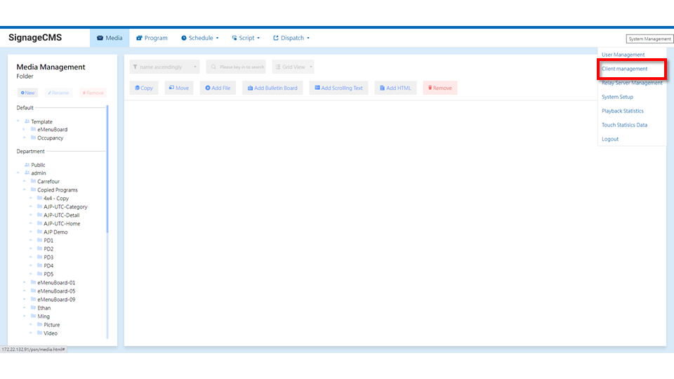

Step8. Click on the gear icon, then select "Client Management". IDS Client36.png

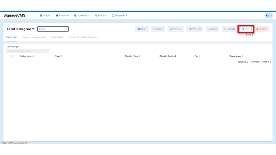

Step10. Enter the name and ID of the player you want to add. The ID can be found in the player's Client Setup. After entering the information, please click the "Save and Exit" button. IDS Client38.png

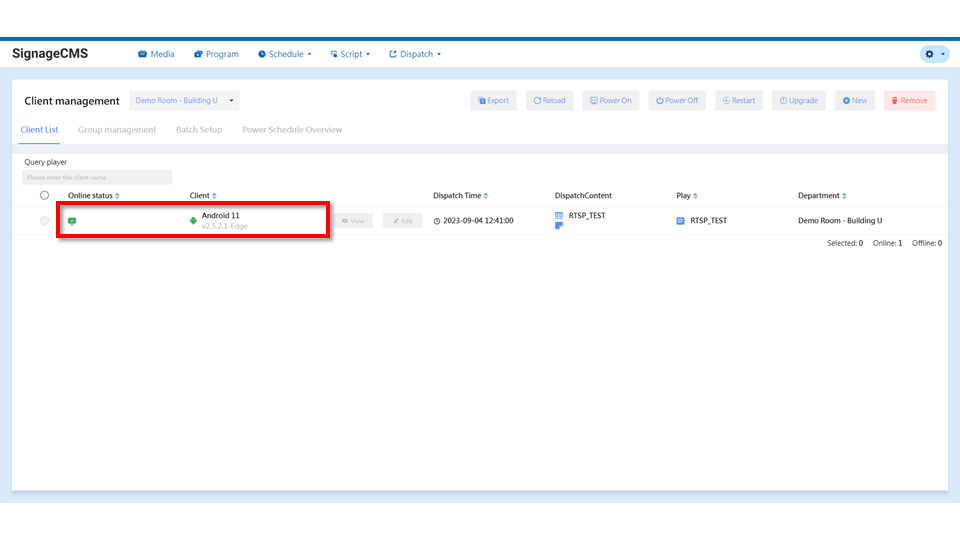

Step 11. Return to the device list page and check if the status of the device is online. > If you see a red light, please click on "Refresh" to update the client status. If it still shows a red light (offline), please confirm if the software is running or if the Client ID is correct.
