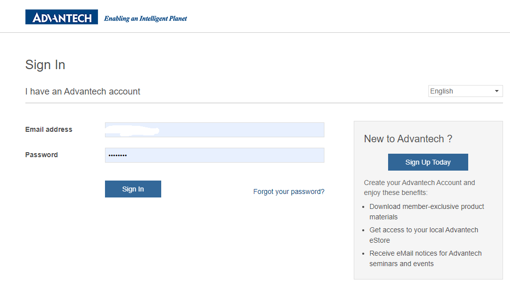

  1. Log in to Marketplace

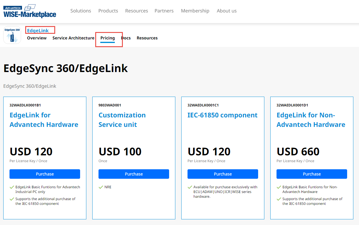

  1. Search for EdgeLink, select the pricing plan, and place your order based on requirements
Part NumberDescriptionNotes
32WAEDLK0001B1EdgeLink for Advantech HardwarePurchase this part number when the customer has already bought Advantech hardware and needs to deploy EdgeLink (IEC-61850 can be added later or purchased subsequently)
32WAEDLK0001C1IEC-61850 componentFor Advantech factory-installed EdgeLink devices (e.g., ECU, ADAM, WISE, UNO, ICR) with only Basic Functions by default. Requires separate purchase of IEC-61850 service.
32WAEDLK0001D1EdgeLink for Non-Advantech HardwarePurchase this part number when deploying EdgeLink on non-Advantech hardware (IEC-61850 can be added later or purchased subsequently)
9803WAD001NRE FeeFor custom requirements. NRE fees will be assessed by the product team before purchase.

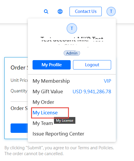

  1. After Purchase, check pending activation orders in the "My Software Licenses" section of your account (multiple EdgeLink licenses can be purchased but must be activated individually).

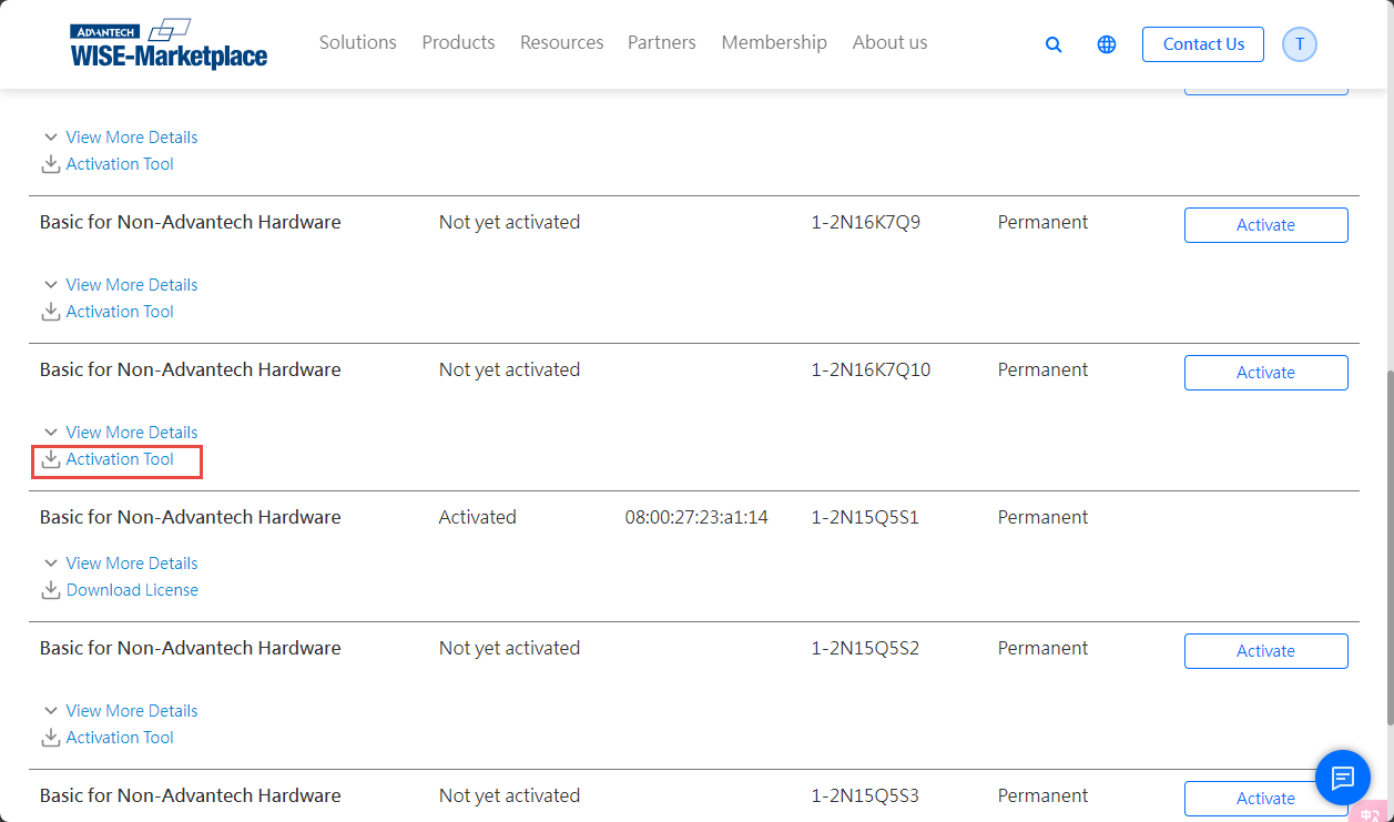

If purchased via Marketplace, download the "Activation Tool" (EdgeLink Studio) from the "My Software Licenses" page. Alternatively, download it from the EdgeLink Studio Official Link. Skip this step if already installed.

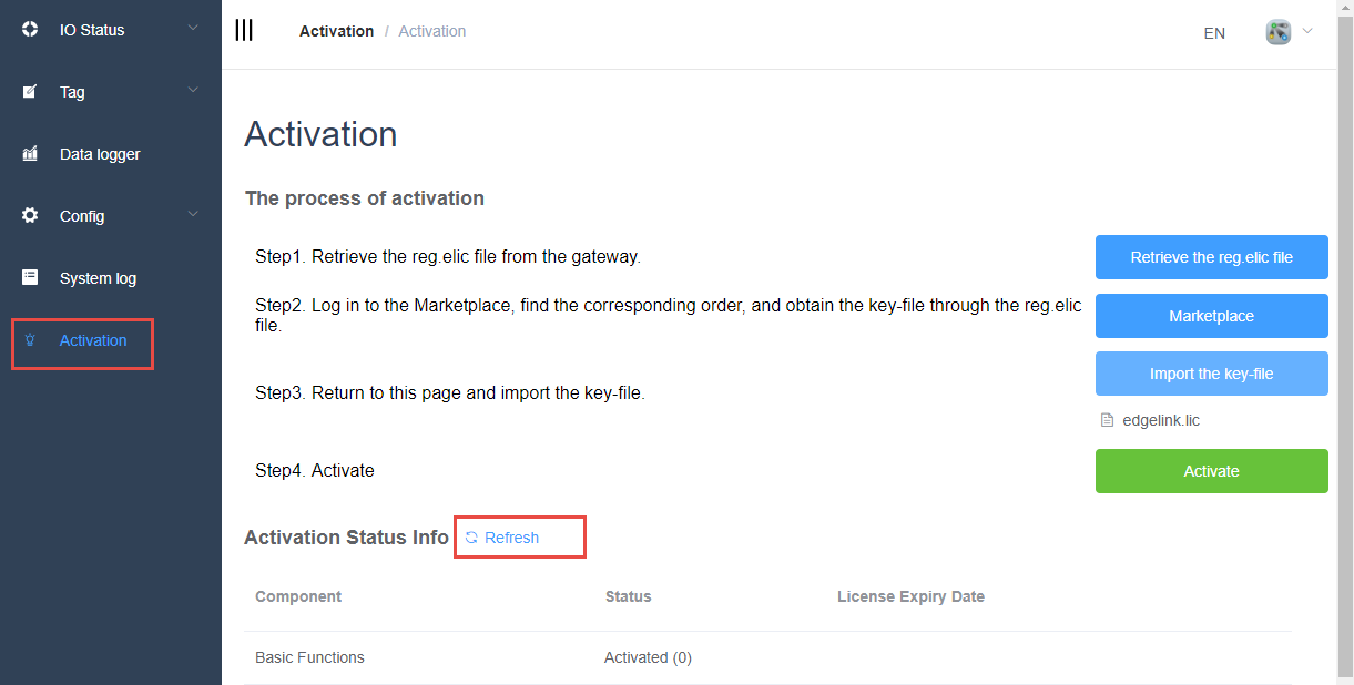

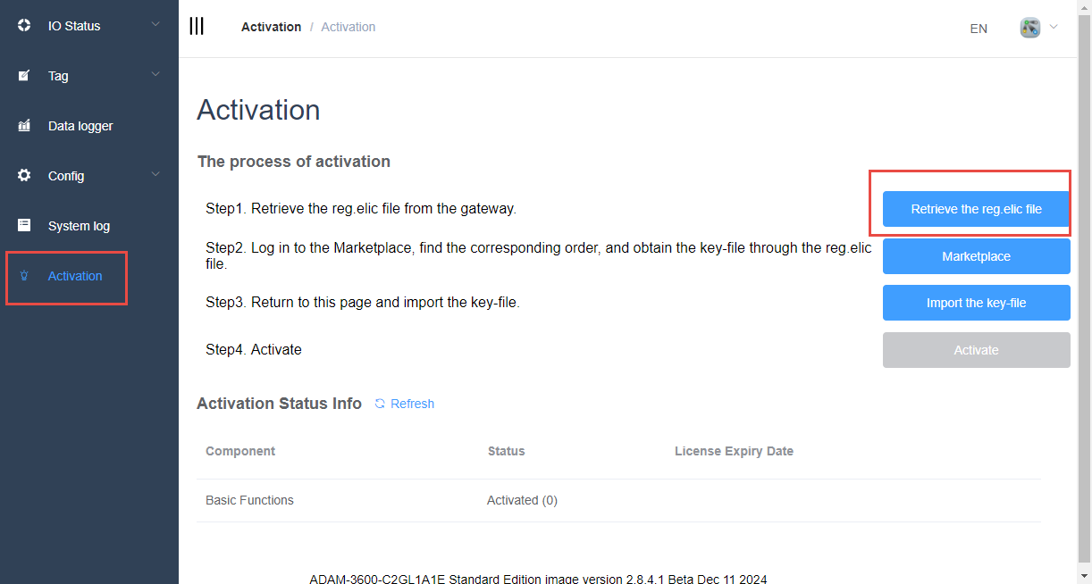

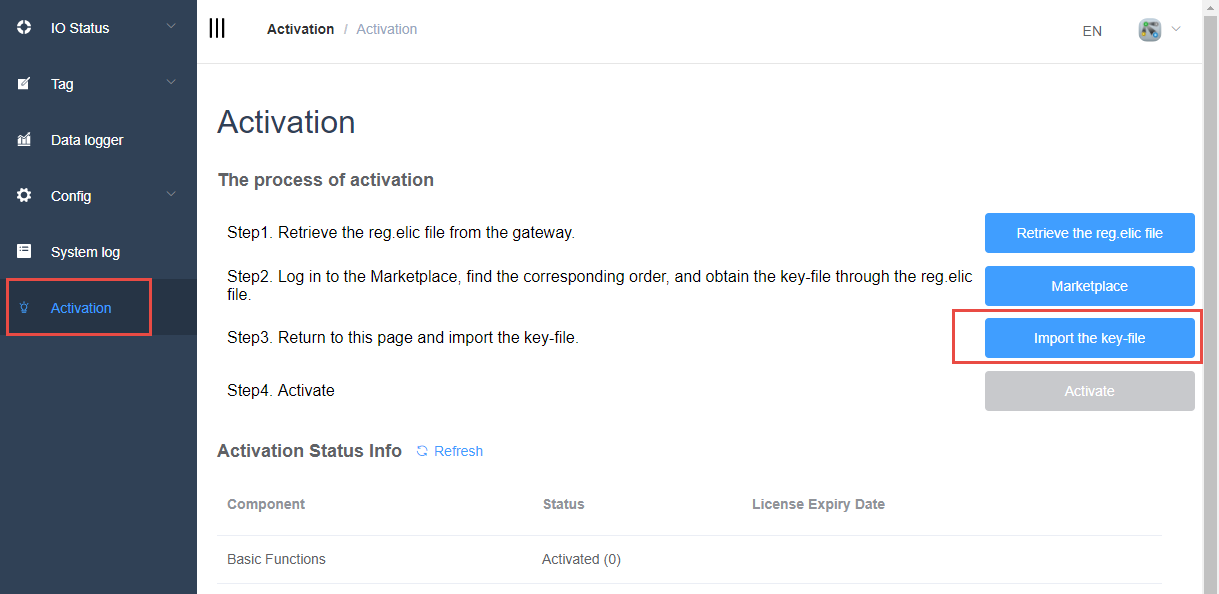

Obtain the Device's reg.elic File and Save Locally
Open EdgeLink Studio on a PC connected to the same network as the target device. Locate the device in Studio's online device list, log in, and navigate to the Activation page.

For Marketplace Purchases:

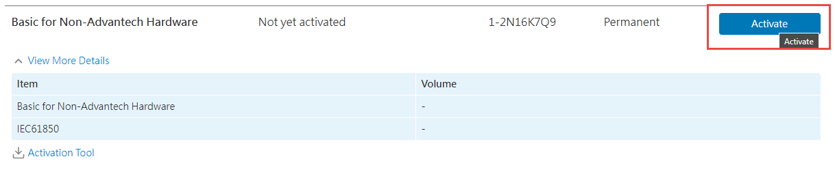

Go to the "My Software Licenses" page on Marketplace.

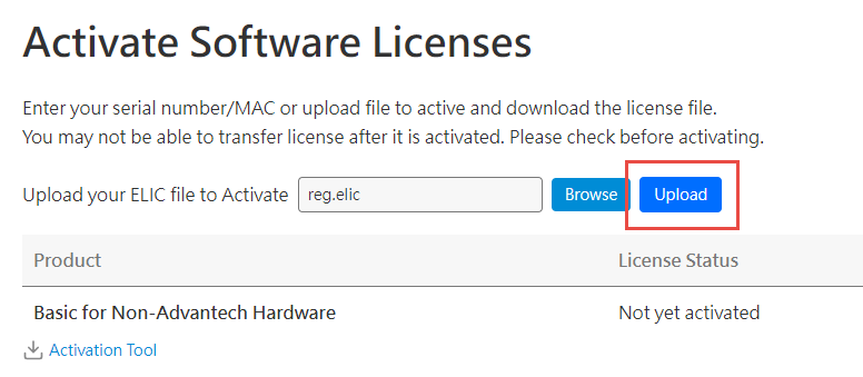

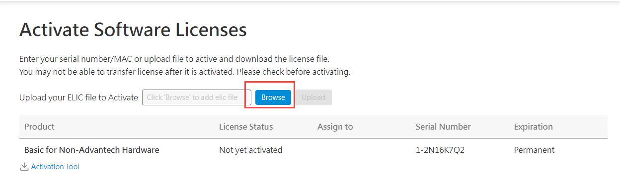

  1. Click the Activate button
  2. Click Browse to import the reg.elic file
  3. Click Upload to complete authorization

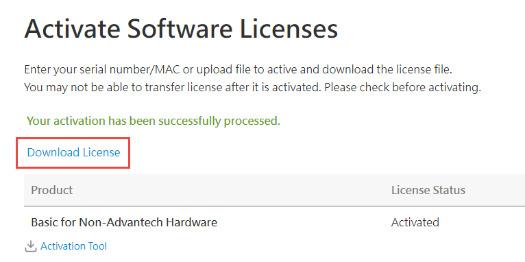

  4. Download the license key after successful authorization
  5. Unzip the downloaded file to extract edgelink.lic

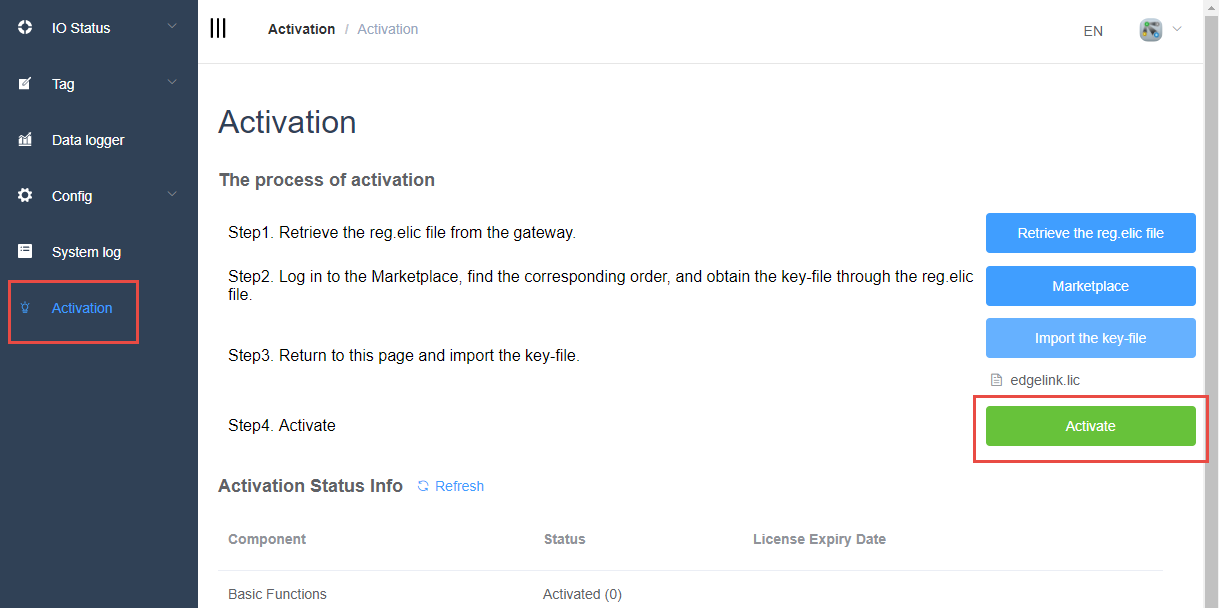

Activate
Click Refresh to Check Activation Status
