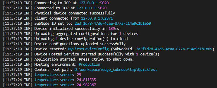

Expected output:
Template Wedabuilder quick test
🎉 If the log continuously outputs temperature measurements, it indicates that the template project is running successfully and the device integration is functioning as expected.
