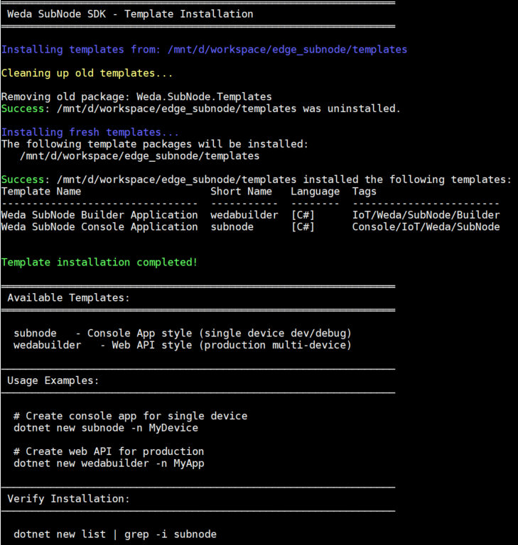

Navigate to the SDK repository root and run:
bash scripts/install-templates.sh
Expected output:
WEDA SubNode Install Script

Verify Installation
Check that all templates are installed:
dotnet new list | grep -i subnode
Expected output:
Template Name                         Short Name   Language  Tags
Weda SubNode Console Application subnode [C#] Console/IoT/Weda/SubNode
Weda SubNode Web API Application wedabuilder [C#] Web/WebAPI/IoT/Weda/SubNode
If you see both templates listed, installation was successful! ✅
