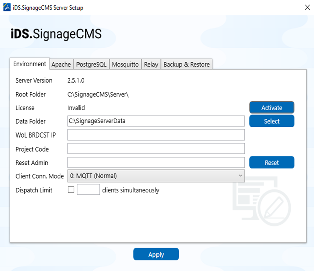

Environment Configuration.png Configure the fundamental information and settings of the SignageCMS server.Here are the detailed explanations for these settings:
  • Server Version: Displays the current version number of the SignageCMS server.
  • Root Folder: Displays the installation path of the SignageCMS server software.
  • License: Displays the status of the installed SignageCMS software license.
  • There are three license versions available. If you need to input a license serial number, please click on the Activate button, enter the serial number, and then click on the Activate button to enable it.
Version TypeLicensePlayer Connection Count
StandaloneTrial Version10 devices
StandardStandard Version400 devices
ProProfessional Edition400 devices
  • Data Folder: Displays the storage location of the SignageCMS server-related files. The default location is C:\SignageServerData. If you need to change the location, click on the Select button to choose a storage path.
  • WoL BRDCST IP: The IP address of the network wake-on-LAN (WoL) broadcast for the main device, such as the router. This option is used to reset the default password for the SignageCMS administrator, "admin".
  • Reset Admin: After entering the "signagesuperadmin" password, click on the Reset button to proceed with the reset.
  • Client Conn. Mode: The communication mode between the server and the player. Options include MQTT (Normal), Polling (Legacy), and Polling (Restricted Bandwidth). Polling is used for specific projects. The default setting is 0: MQTT (Normal).
  • Dispatch Limit: Limits the number of schedules simultaneously dispatched to players by the server. The default setting is unchecked.
