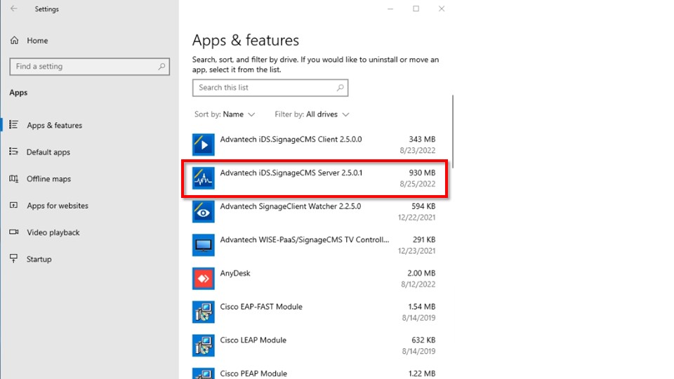

Windows 102.5.3.9
Check iDS.SignageCMS version​

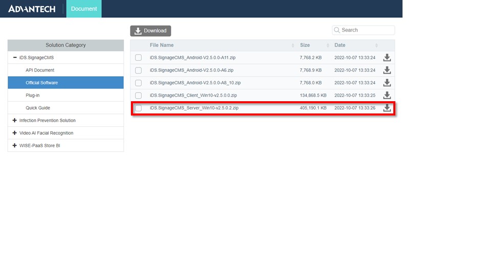

Step 1. Open Chrome or Edge browser, input , find file in iDS.SignageCMS-->Official Software cateory, you may find latest version. Please base on model table to download correct version. 投影片5.JPG

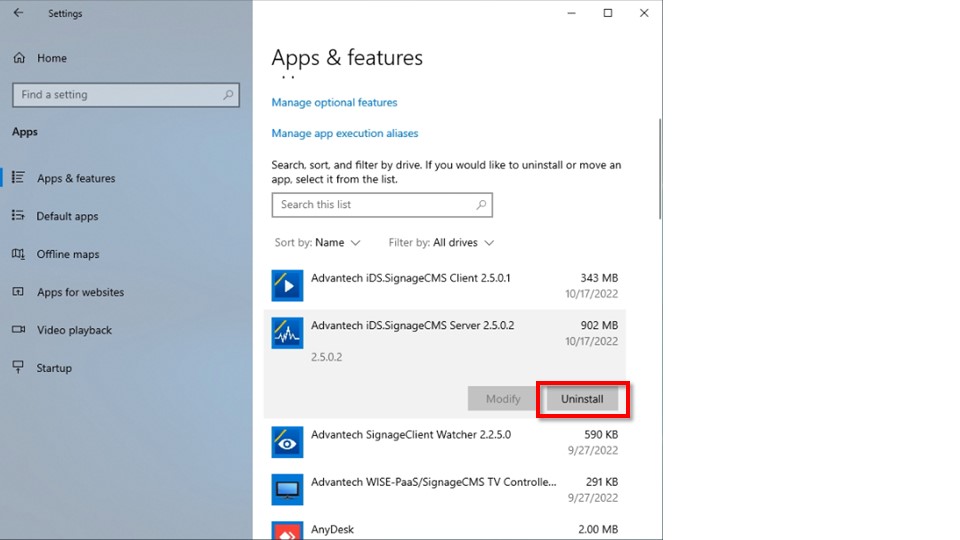

>- If the server already installed software, please confirm signage version is latest one.
Software installation​
>- If you want to upgrade signagecms software, uninstall the signage software first.

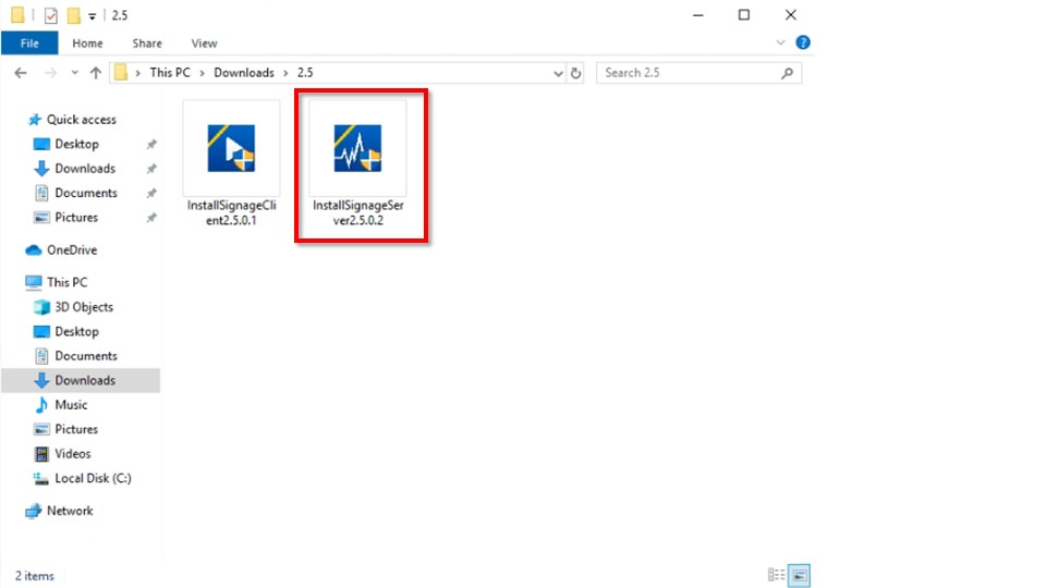

When the file has been downloaded, please unzip the file and install it. 投影片6.JPG

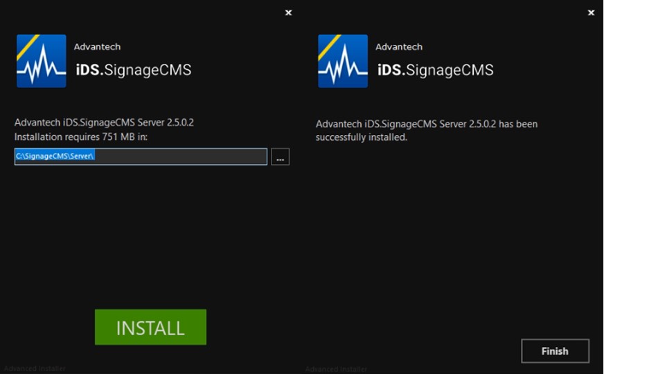

Please ensure the install path, we don't recommand change the install path. 投影片7.JPG

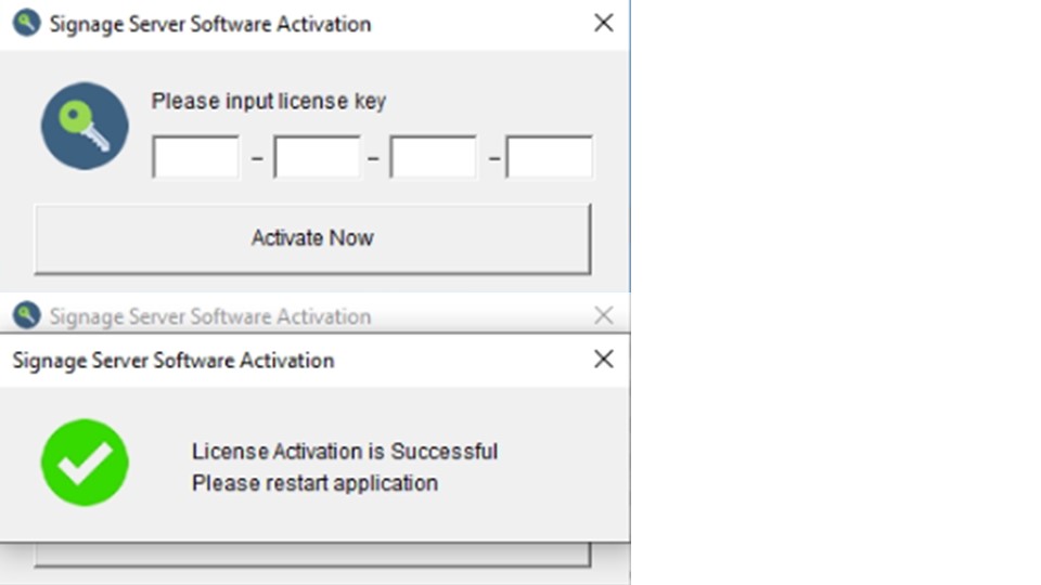

>- Server can access control 10 players for free, you can ignore it. >- The step is online activateation, please connect the lan cable to player and make sure it can connect to internet. >- If you are using trail license, please adjust the timezone, date and time first. >- If you already purchased system with sigangeCMS software, please ignore this step.
Step 1. Click Start--> iDS.SignageCMS--> Signage Server Activation go to setting page. 投影片9.JPG
