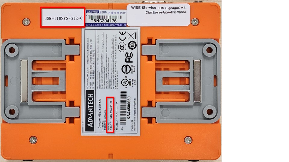

Check Model on back side​

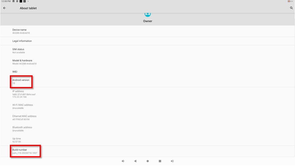

Check build number & system version in system​
Go to Settings --> About Tablet --> Check incuding Build Number & Android version. 投影片5.JPG

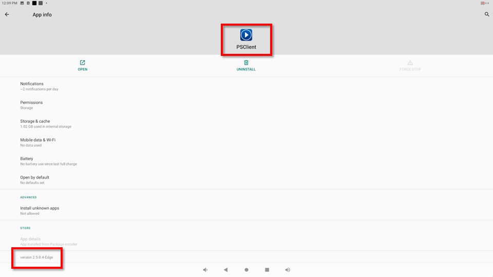

Check iDS.SignageCMS version​

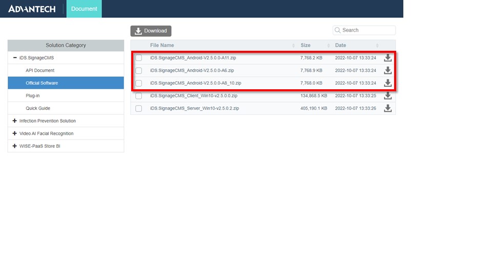

Software Download​
Step 1. Open Chrome or Edge browser, input , find file in iDS.SignageCMS-->Official Software cateory, you may find latest version. Please base on model table to download correct version. 投影片7.JPG

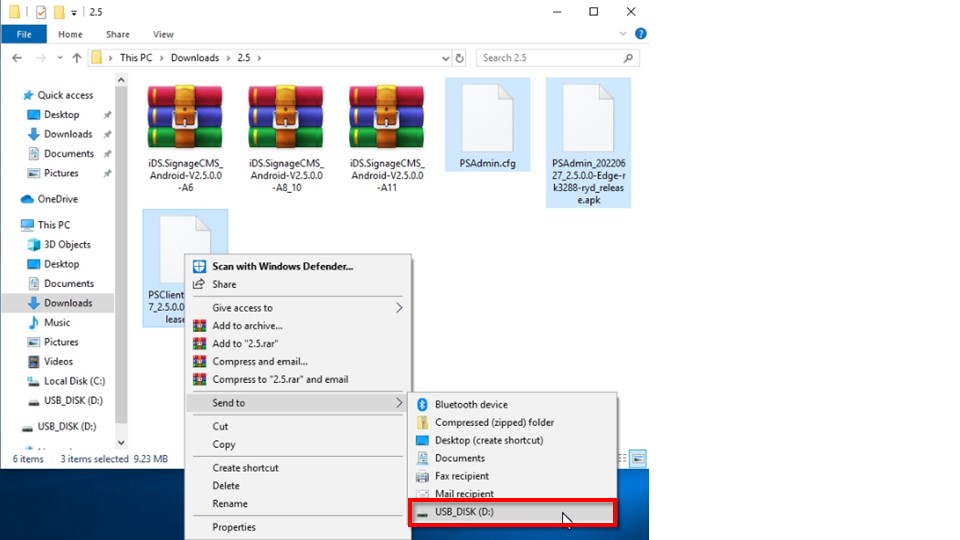

Step 2. When the file has been downloaded, please unzip the file and copy it to USB drive(FAT32). 投影片8.JPG

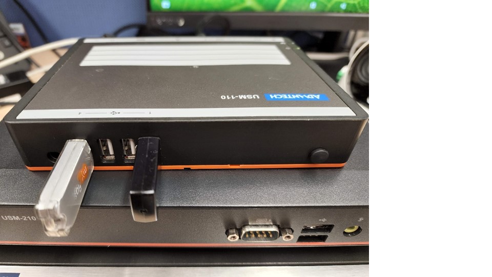

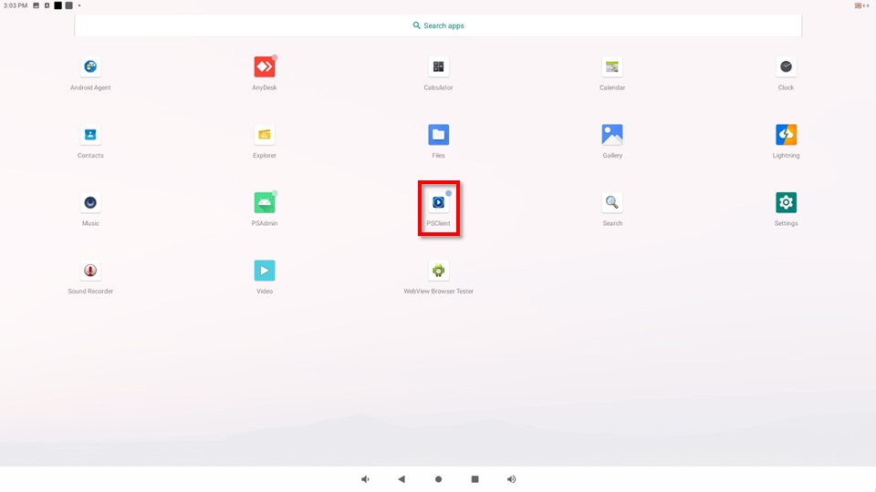

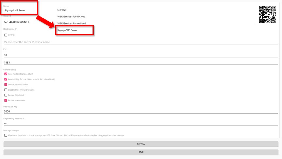

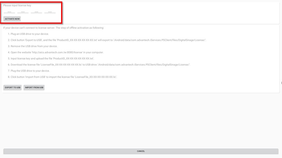

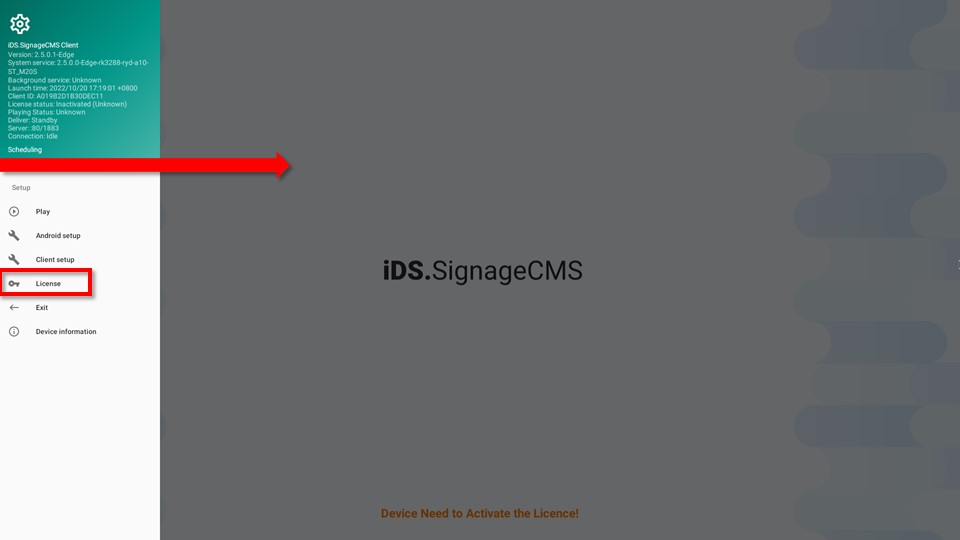

Step 5. Move mosue cursor to left side on SignageCMS screen, hold mouse left button and move to right side, the menu bar will show on left side, then select license. >- Press keyboard menu button has same function.
Step 6. Please input 16 digit code license, press Activate Now button, it will show success message. 投影片16.JPG

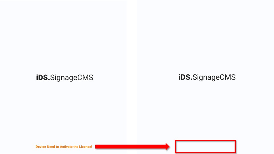

Step 7. When activate successful, the screen "Device Need to Activate the License" will disappear. 投影片17.JPG
