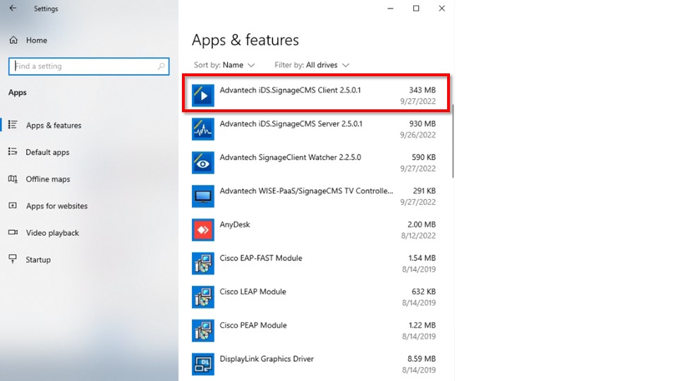

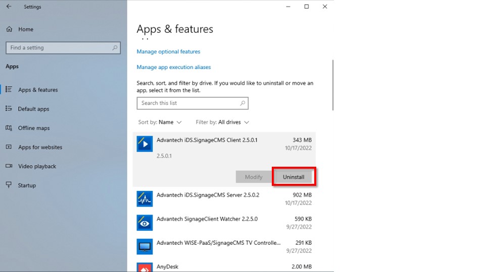

Check SignageCMS version​

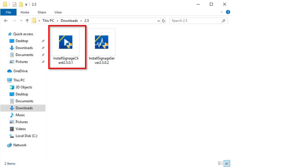

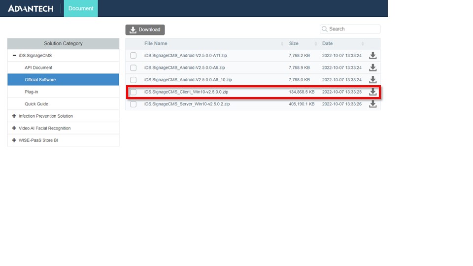

Software download​
Step 1. Open Chrome or Edge browser, input , find file in iDS.SignageCMS-->Official Software cateory, you may find latest version. Please base on model table to download correct version. 投影片5.JPG

>- If you want to upgrade signagecms software, uninstall the signage software first.

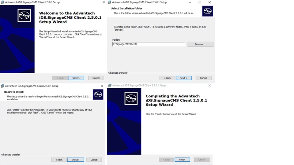

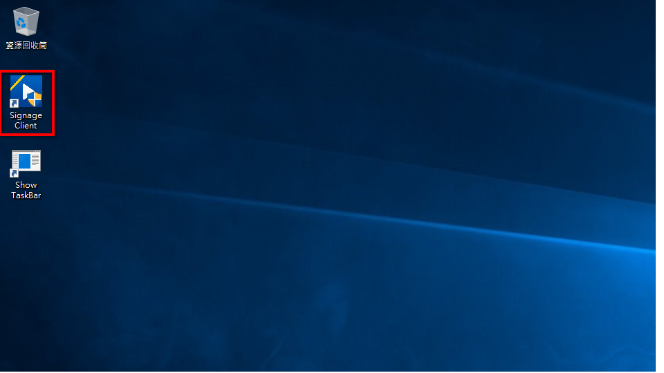

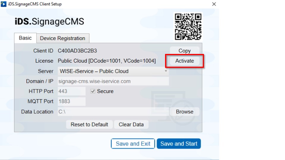

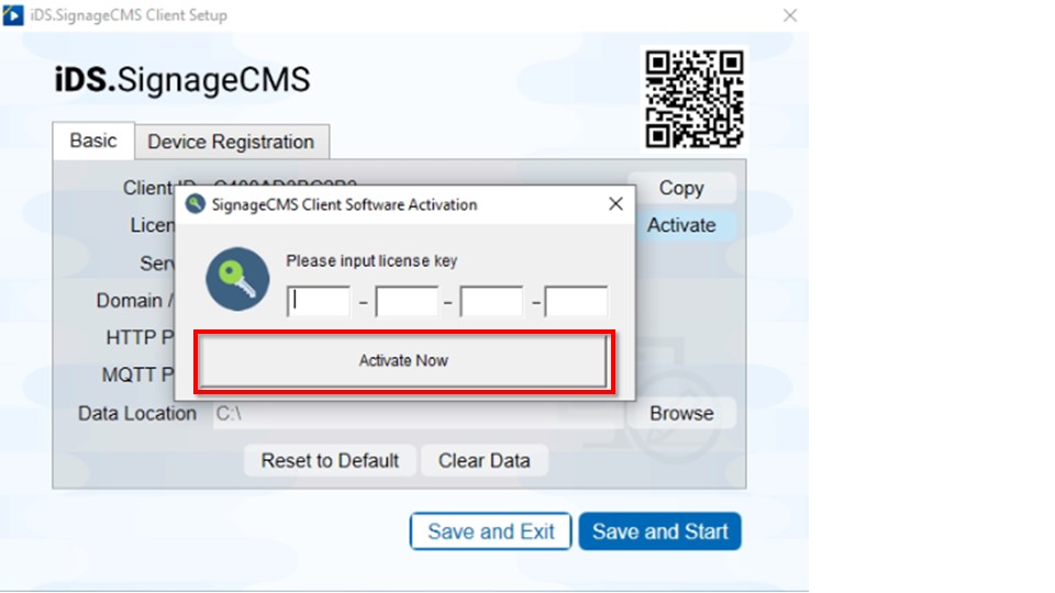

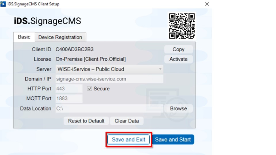

When the file has been downloaded, please unzip the file and install it. 投影片6.jpg
Please ensure the install path, we don't recommand change the install path. 投影片7.jpg
