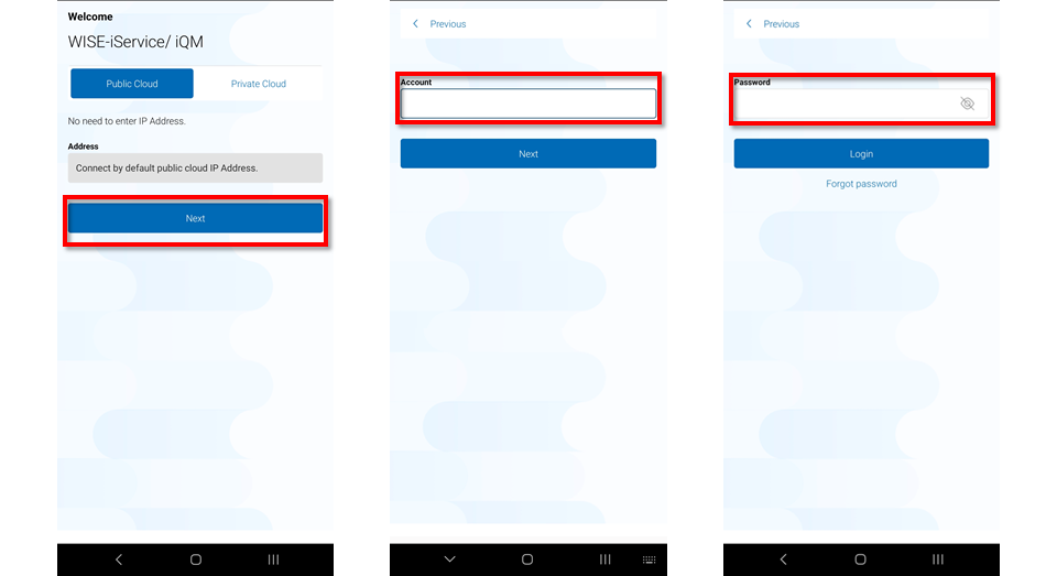

1.Open ColdChain App in mobile phone. 2.Select Public Cloud, then press Next button. 3.Input e-Mail Account and Password, press login button. 41.png

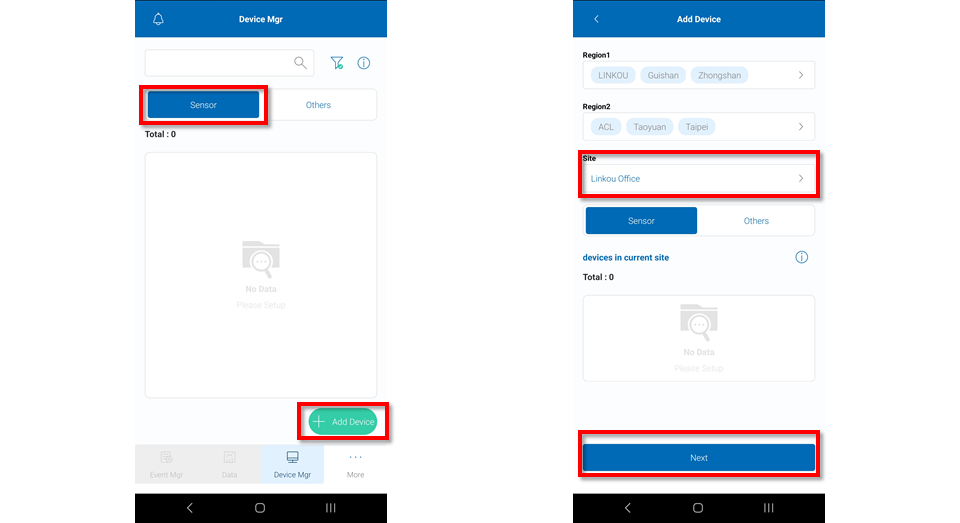

4.Go to device manager, press Add Device button. 5.Select Site, then press Next button. 42.png

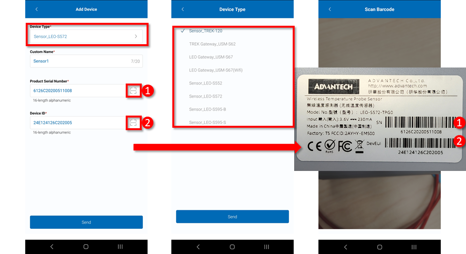

6.Click Device Type, then choose device to register, then press send button. 7.Press scan icon, then scan the QR-Code to add the number. Press Send button to finish. 43.png

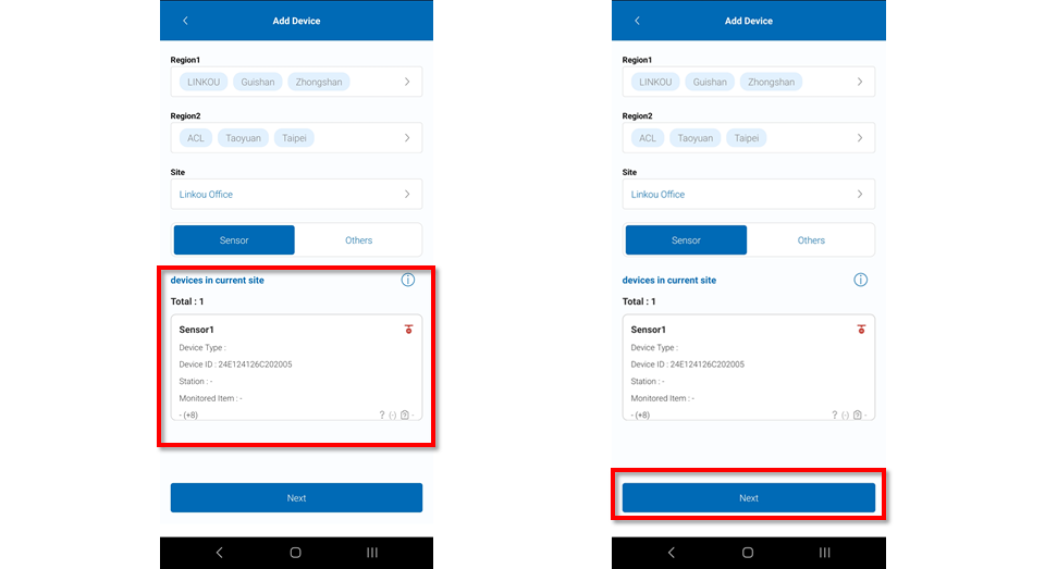

8.The sensor has been added. 9.To add more sensor, press Next button follow step6. 44.png
