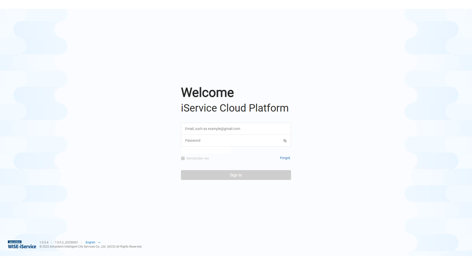

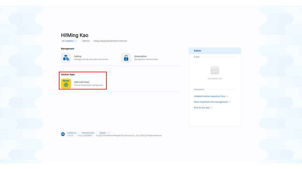

1.Visit https://apps.wise-iservice.com/, login to main page by Chrome or Edge Browser. 11.png

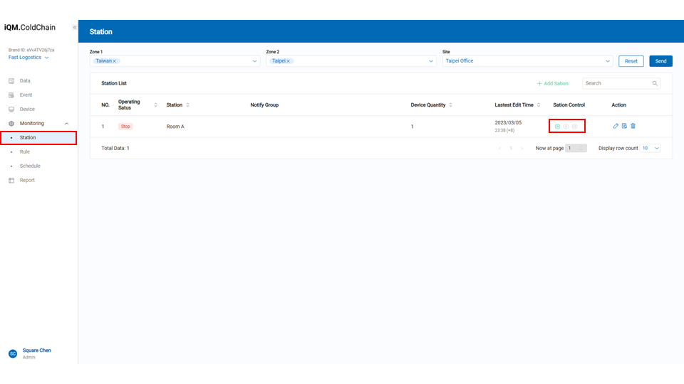

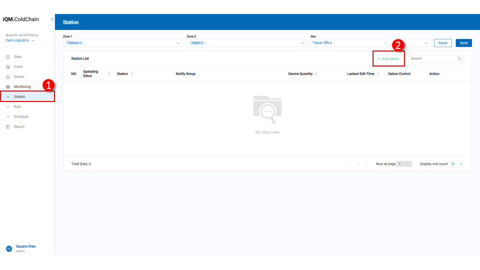

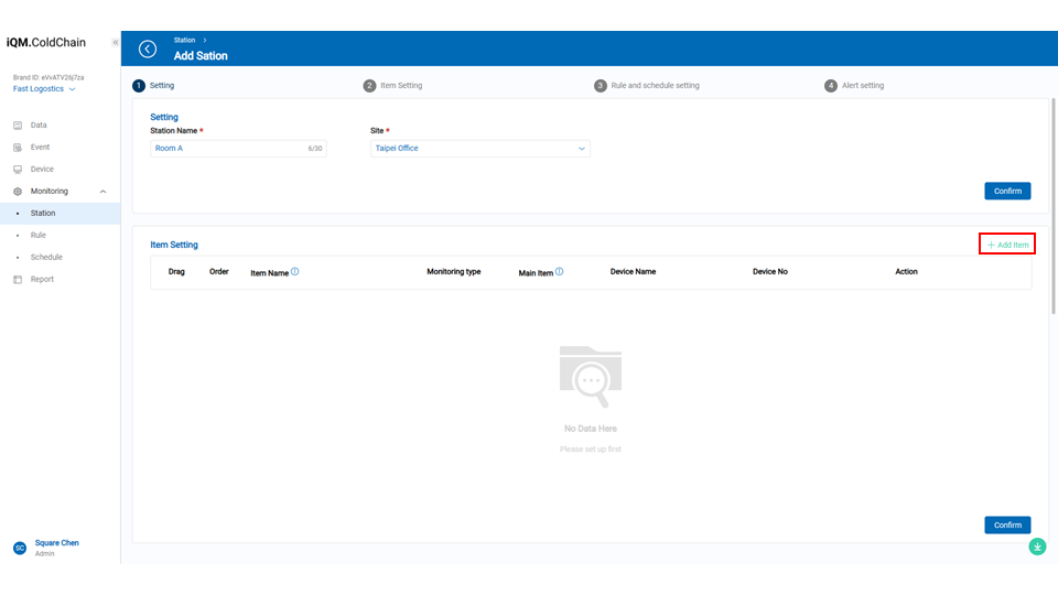

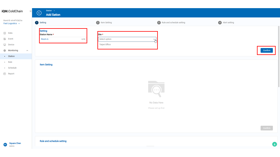

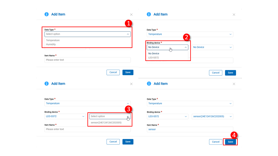

6.Select Data Type→Binding device→Sensor→Item Name. Press Save button. 136.png

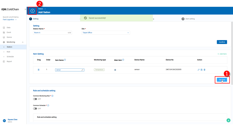

7.The Item has been created, press Confirm button first, then press back button. 137.png
8.Press start button to start operating. > data will be update every 10 minutes. 138.png

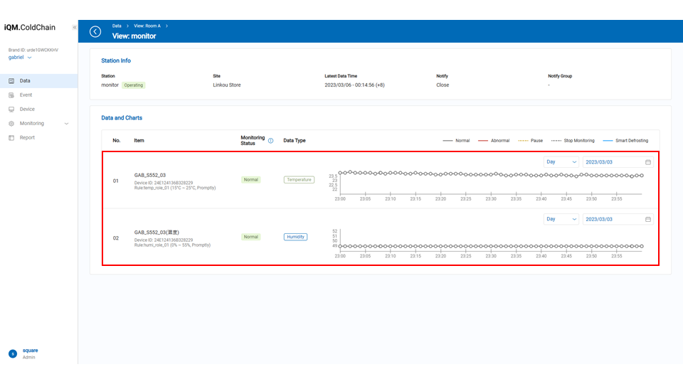

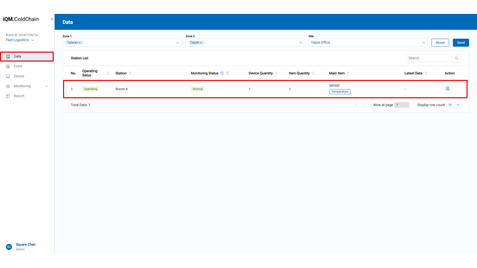

9.Go to Data page, make sure the status shows green light, press view icon. 139.png
