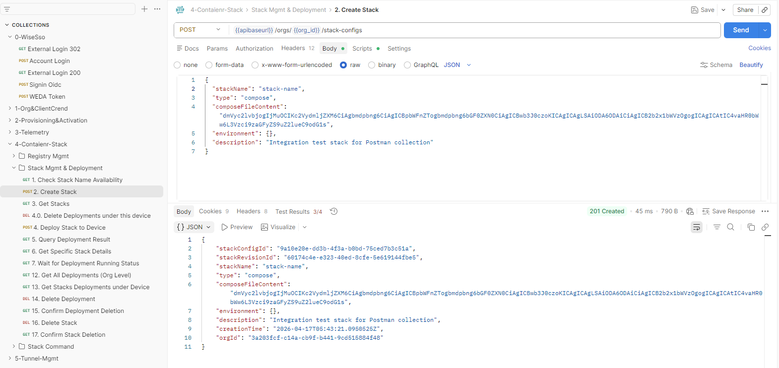

1.3 Create a Container Stack
Use the following API to create a container stack. Put the Base64-encoded Compose file in composeFileContent. The system will automatically assign a revision number.
Endpoint
POST /api/v1/orgs/{orgID}/docker-settings/stack-configs
Example Request
curl --location --request POST 'https://{domain}/api/v1/orgs/3a1d40ed-4f97-aed8-c727-57704d3d5d2e/docker-settings/stack-configs' \
--header 'Content-Type: application/json' \
--header 'Authorization: Bearer {access-token}' \
--data '{
"stackName": "stack-name1",
"type": "compose",
"composeFileContent": "{Base64-encoded}",
"environment": {},
"description": "this is description"
Example Response
"stackConfigId": "e700312d-18e9-4a93-b291-0108596b0a91",
"stackRevision": "70e1771a-0fd3-4e85-9a17-6ea752f92d0b",
"type": "compose",
"environment": {},
"description": "this is description",
"creationTime": "2025-10-30T09:42:39.014305Z"

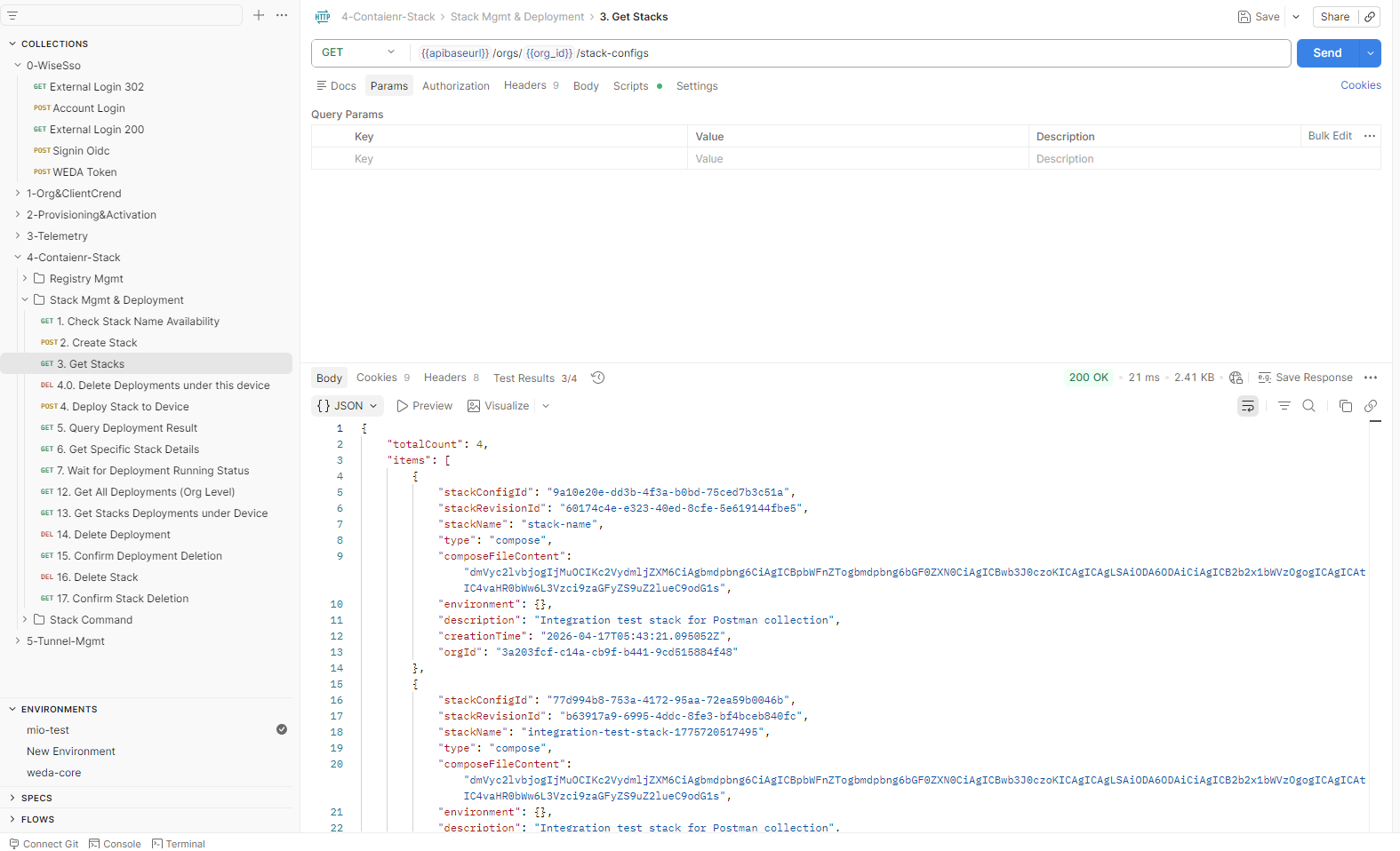

1.4 List Stack Configurations
After a stack is created, use the following API to list all stack configurations in the organization to confirm the active stack deployments.
Endpoint
GET /api/v1/orgs/{orgID}/docker-settings/stack-configs
Example Request
curl --location --request GET 'https://{domain}/api/v1/orgs/3a1d40ed-4f97-aed8-c727-57704d3d5d2e/docker-settings/stack-configs' \
Example Response
"totalCount": 1,
"items": [
"type": "compose",
"environment": {},

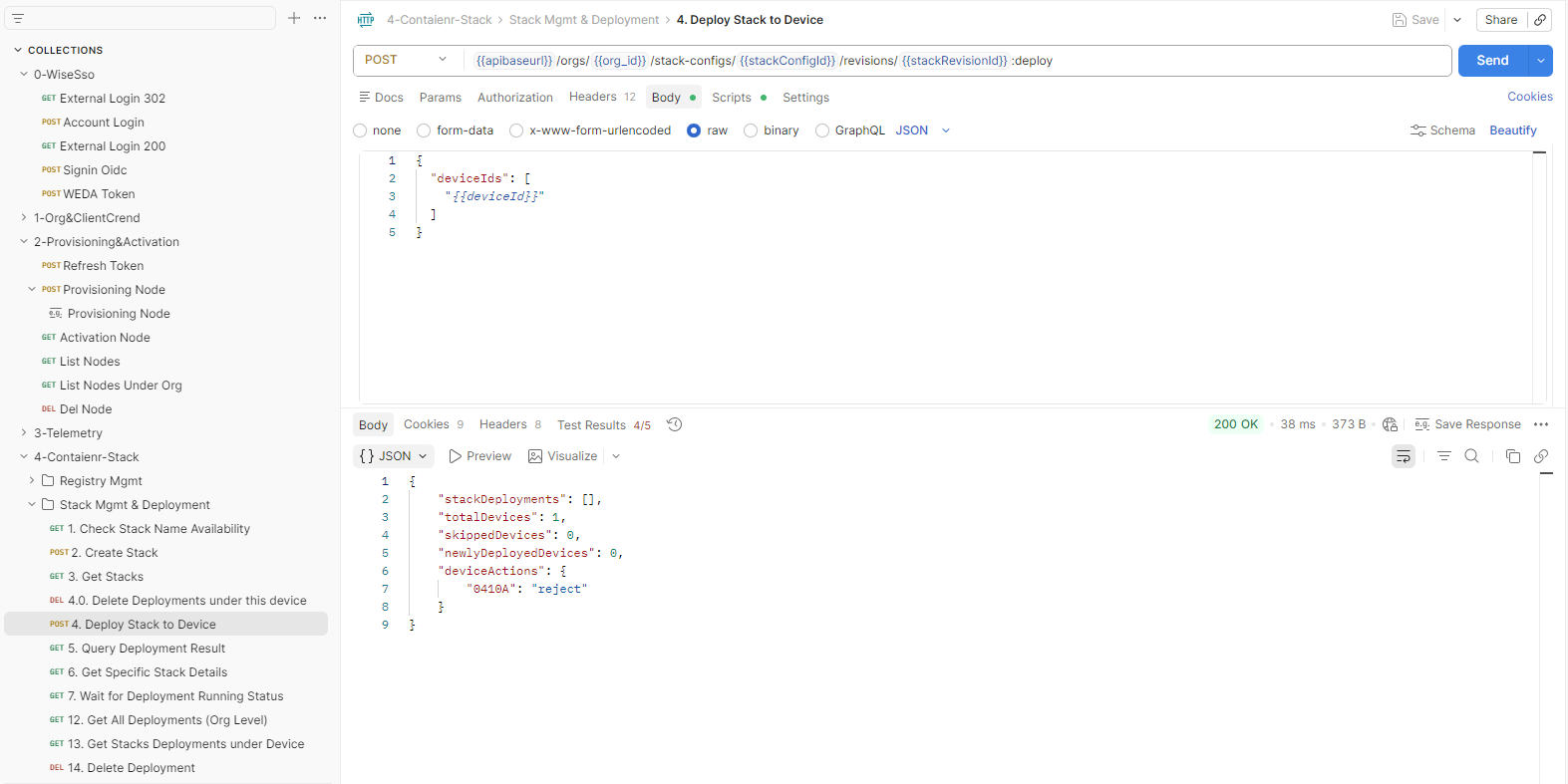

STEP 2: Deploy the Container Stack to the Device
2.1 Deploy the Container
Use the following API to deploy the container stack to an edge device. You can deploy the same stack to multiple devices by providing a list of deviceIds.
Endpoint
POST /api/v1/orgs/{orgID}/docker-settings/stack-configs/{stackConfigId}/revisions/{stackRevision}:deploy
Example Request
curl --location --request POST 'https://{domain}/api/v1/orgs/3a1d40ed-4f97-aed8-c727-57704d3d5d2e/docker-settings/stack-configs/e700312d-18e9-4a93-b291-0108596b0a91/revisions/70e1771a-0fd3-4e85-9a17-6ea752f92d0b:deploy' \
--data '{
"deviceIds": [
"48b02d8861de"
Example Response
"stackDeployments": [
"deploymentId": "b4833ebb-ac6c-4a77-a075-e7ad0e036790",
"taskId": "c0383dfc-e918-41f3-997e-4f5fa1ace7d8",
"deviceId": "48b02d8861de",
"status": "deploying",
"containers": [],
"error": {},
"active": true
"totalDevices": 1,
"skippedDevices": 0,
"newlyDeployedDevices": 1,
"deviceActions": {
"48b02d8861de": "add"

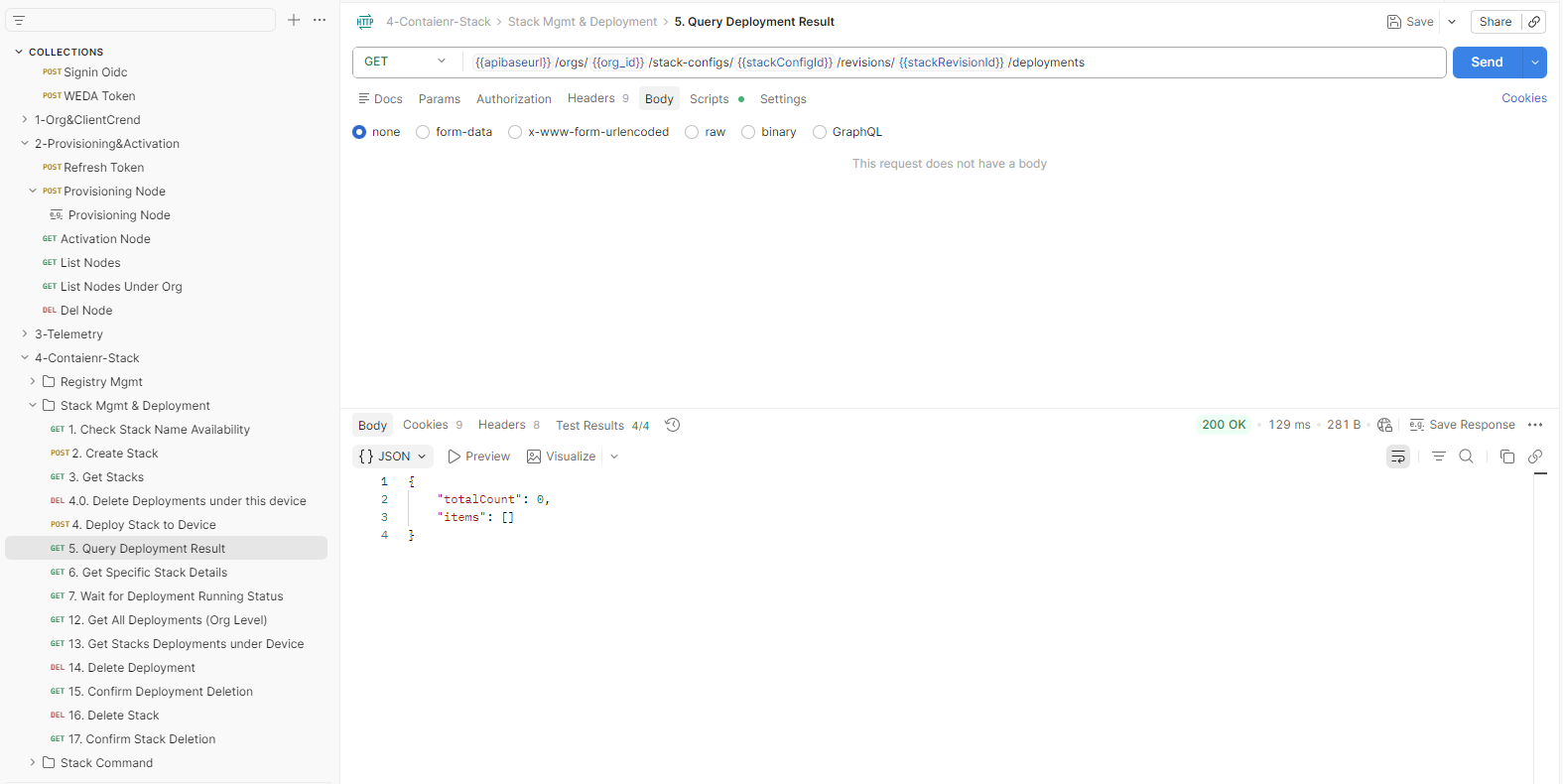

2.2 Check Stack Deployments
Use the following API to view active stack deployments and verify the stack status on the edge device.
Endpoint
GET /api/v1/orgs/{orgID}/docker-settings/stack-configs/deployments
Example Request
curl --location --request GET 'https://{domain}/api/v1/orgs/3a1d40ed-4f97-aed8-c727-57704d3d5d2e/docker-settings/stack-configs/deployments' \
Example Response
"totalCount": 1,
"items": [
"status": "running(1)",
"containers": [
"id": "586e6eb9-5f0c-4173-9c9e-937a50c45fa7",
"name": "advantech-yolo-vision",
"state": "",
"restartCount": 0,
"created": 1761891735912,
"errors": []
"error": {},
"active": true
If the response shows "status": "running", the container is successfully running on the edge device.
