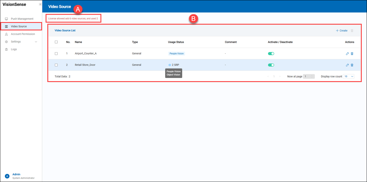

A.【Number of Licenses】 ⇒ The tip displays how many cameras can be added and how many cameras are used.
B.【Video Source List】 ⇒ Users can quickly search for a people-counting unit's history by following conditions.
- Name: It displays the name of the added counting unit.
- Type: It displays the type of video source. 'General' refers to an IP camera, while 'Webcam' refers to a webcam.
- Usage Status: It displays which application service is using the video source. If multiple application services are using it, click the 'view' to view details.
- Comment: (optional) Users can input any string for notes.
- Activate/Deactivate: Users can activate or deactivate this video source profile. If users deactivate the video source, the counting unit will stop working until it is activated again.
- Action: Users can edit and delete the added video source.
- + Create/Delete: Users can click
'+ Create' to add a video source and click
'Delete' to remove multiple video sources at a time.

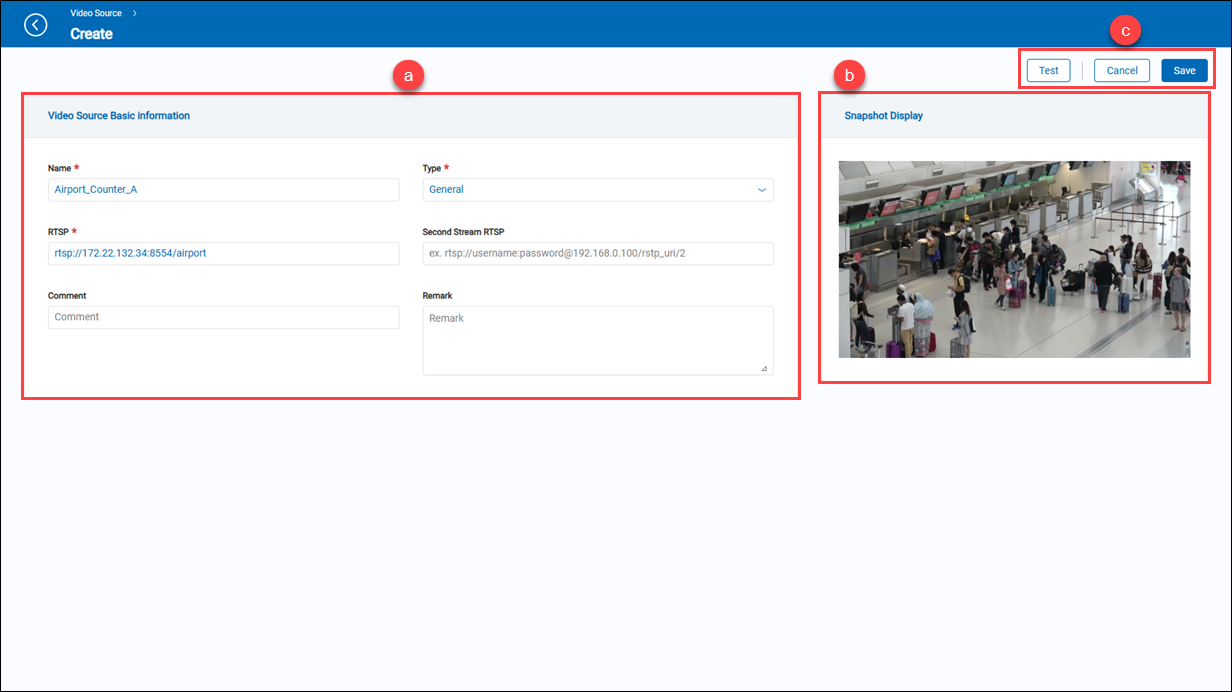

a.【Create Video Source】 ⇒ Video Source Basic Information
- Name: A user-friendly name for identifying this camera.
- Type: Allows users to add an IP camera or a webcam. 'General' refers to an IP camera, while 'Webcam' refers to a webcam.
- Webcam: Existing webcam options list.
- RTSP: The main stream of the IP camera's full RTSP URL path, including the device’s username and password. (i.e.: rtsp://root:pass@192.168.100.66:554/axis-media/media.amp)
- Second Stream RTSP: The sub stream of the IP camera's full RTSP URL path, including the device’s username and password. (i.e.: rtsp://root:pass@192.168.100.66:554/axis-media/media.amp)
- Reamrk: (optional) Users can input any string for notes.
b.【Snapshot Display】 ⇒ This is the live stream snapshot field. c.【Operation】 ⇒ To save or cancel those settings. Once users have done these settings, they can click the 'Test' to get a live snapshot from the video source. If successful, the live snapshot will be displayed in the snapshot field.
