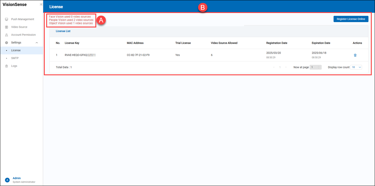

The device registration and licensing feature ensures that video devices operate within the authorized scope and effectively manage available resources. Users must register a license for each device to activate its video source and perform data analysis.
Settings_License.png A.【License usage count】 ⇒ The tip displays how many video sources are used. B.【License List】 ⇒ It displays the license information.
  • License Key: The added license key.
  • MAC Address: The network adapter bound to the license key.
  • Trial License: If the license key has an expiration date, it will be 'Yes.'
  • Video Source Allowed: It displays the number of video sources that can be added with this license key.
  • Registration Date: It displays the registration date of the license key.
  • Expiration Date: It displays the expiration date of the license key.
  • Action: Users can delete the added license key.

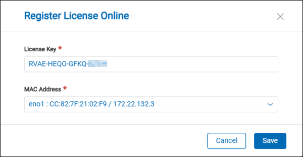

  • Register License Online: To register the license key online, internet access is required. Settings_License_1.png
