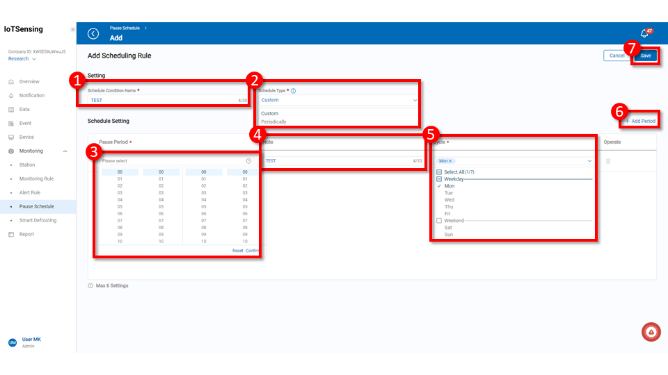

Custom​
  • Must be set on a daily basis.
  • Each schedule can have up to 6 pause periods.
Step1. Enter the schedule name. Step2. Select the custom of schedule type. Step3. Select the pause period by selecting the start and end times. Step4. Enter the name or remarks for the rule. Step5. Select the cycle type. Options include single day, weekdays, weekends, or all. Step6. If there are multiple periods, click "Add Period" and repeat steps 1 to 5. Step7. Click the "Save" button. Pause Schedule2.png

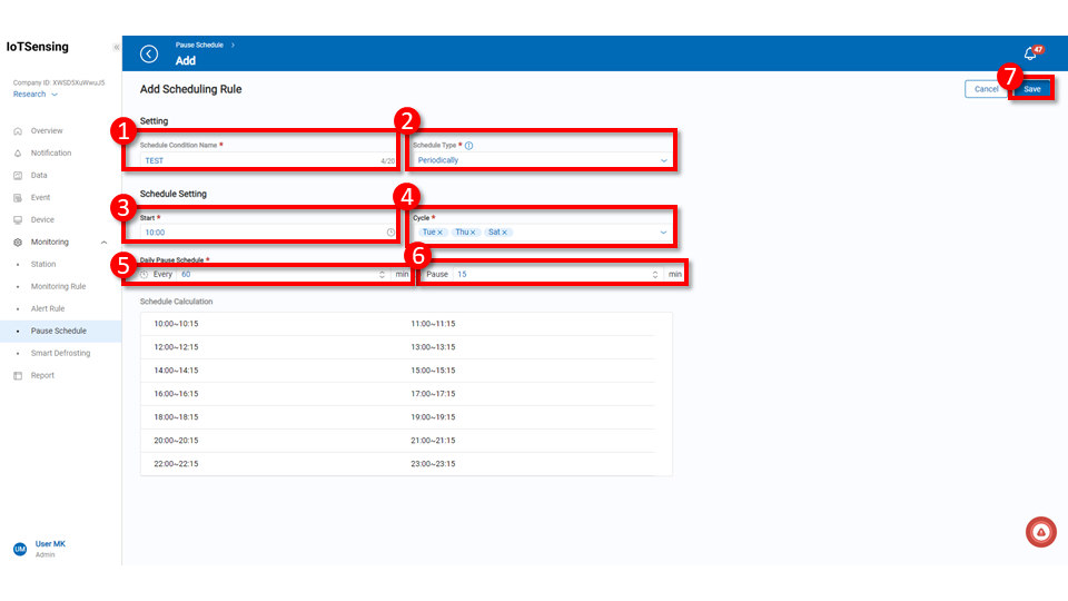

Periodically​
Step1. Enter the schedule rule name. Step2. Select the Periodically. Step3. Choose the start time. Step4. Select the cycle type. Options include single day, weekdays, or weekends. Step5. Select the daily pause schedule in minutes. Step6. Enter the pause time in minutes. Once completed, the time calculation result will appear below. Step7. Click the "Save" button. Pause Schedule3.png

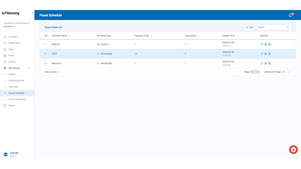

Once the condition is created, return to the main pause schedules screen, where all established pause schedules are displayed. Pause Schedule4.png

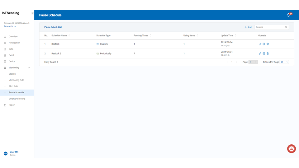

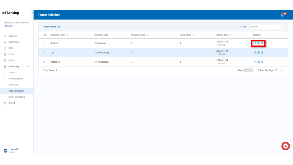

After confirmation, the system displays the list of established pause schedules. Users can view detailed information about each schedule on the main screen and perform further actions such as edit2023-04-23_18-50-42.png, view2023-04-23_18-04-19.png, or delete2023-05-05_12-02-49.png. Pause Schedule5.png

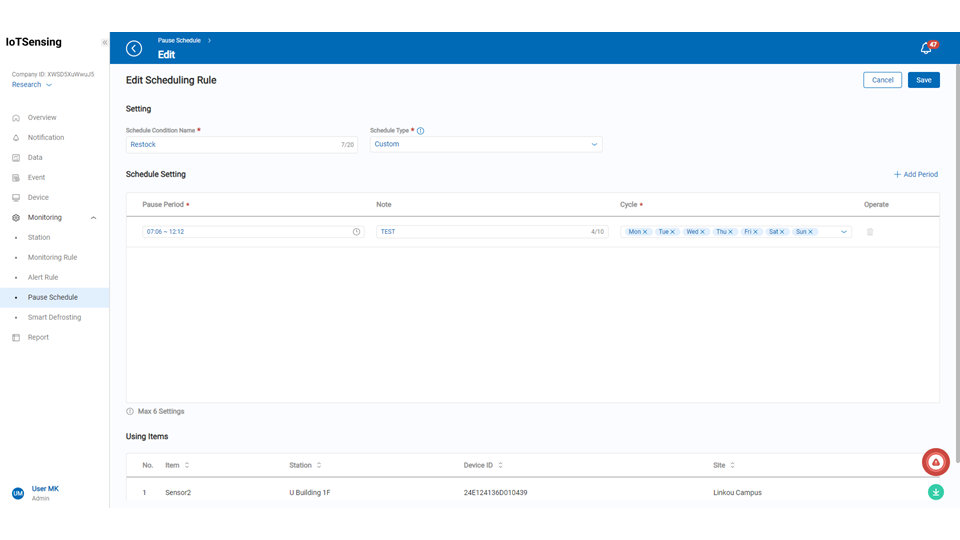

Edit 2023-04-23_18-50-42.png icon: Users can use this button to modify the pause schedule for the corresponding item. Pause Schedule6.png
View 2023-04-23_18-04-19.png icon: This button allows users to inspect detailed information about the pause schedule. Pause Schedule7.png
Delete 2023-05-05_12-02-49.png icon: After deleting a pause schedule, monitoring stations that were using this schedule will also remove this setting. If re-binding is needed, please go to the monitoring station and make a new selection. Pause Schedule8.png
