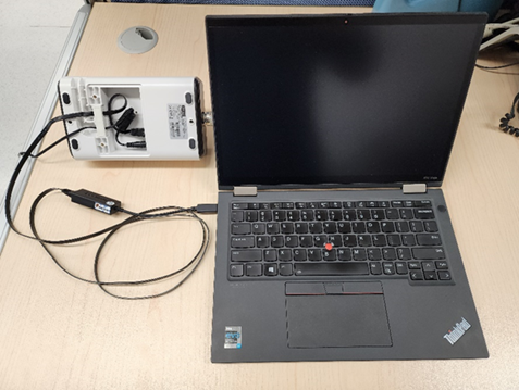

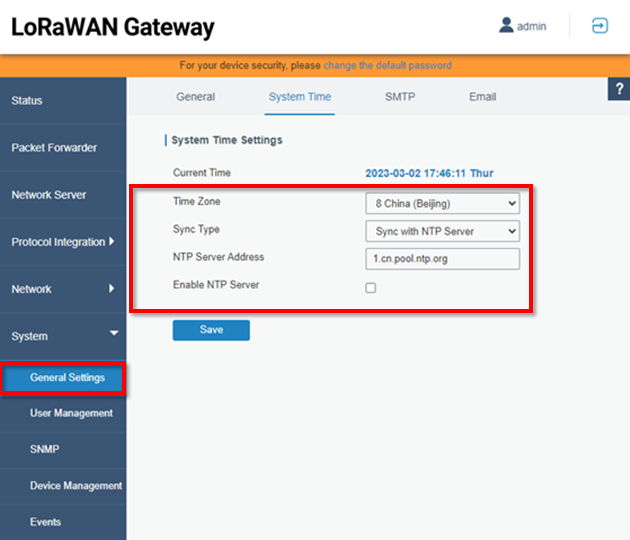

4.Input domain/IP in NTP server address, then change time zone to current location of System→General Settings→System Time page, then press save button. Gateway Configuration4.png

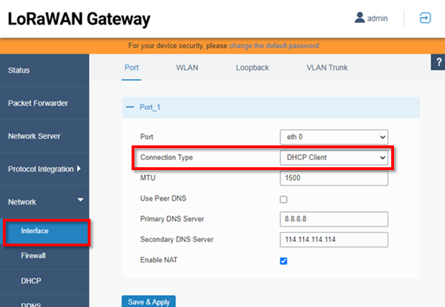

5.Select DHCP Client in Connection Type of Network→Interface→Port page, then press save & apply button. Gateway Configuration5.png

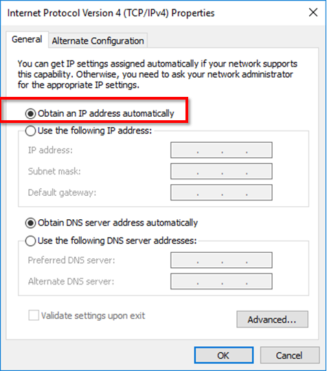

6.Remove Lan cable from device, and change back to Obtain an IP address automatically in Windows. Gateway Configuration6.png

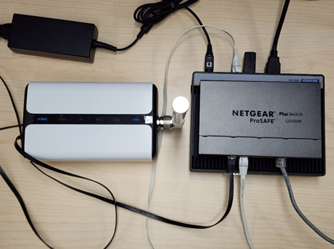

7.Reconnect device Lan cable to switch/hub, device will get DHCP by itself and sync timestamp. Gateway Configuration7.png
