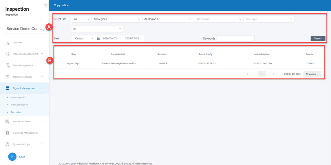

A. Time/job function options: adjusts the time interval, and the job or specific personnel of the data to search. B. Export in Excel format: the data on site inspection record could be exported as an Excel file. Sign-Off Management_Copy notice_CheckDetails_60%.jpg

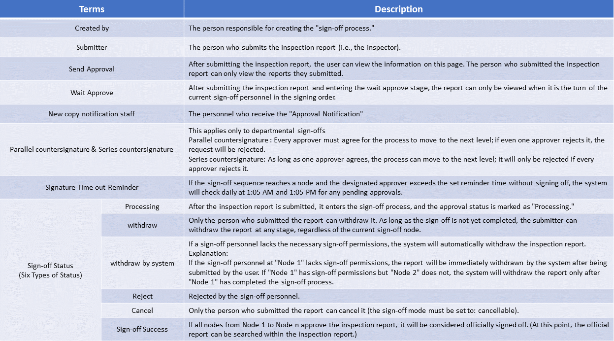

The explanation of terms related to sign-off management

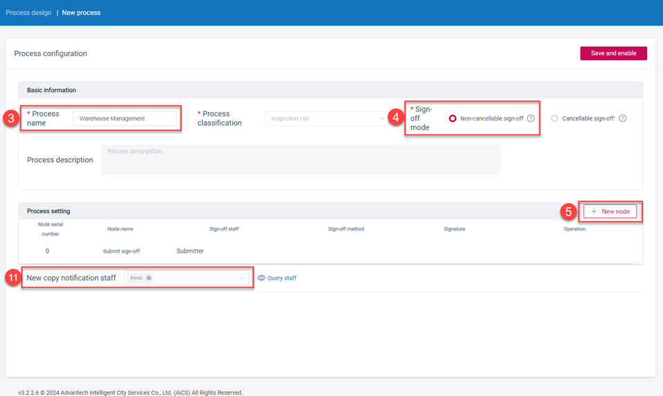

System Settings_Process Design_1_60%.jpg 1: Navigate to the 'System Settings' -> 'Process design' 2: Click on the '+ New process'
System Settings_Process Design_2_60%.jpg 3: Giving a name for this new process 4: In 'Sign-off mode', choose 'Non-cancellable sign-off' 5: Click on '+ New node' to add the approval node, it will take you to the 'Set node' settings page Plaese go to the next picture to see step 6
11: Choose a new copy notification staff member to receive all approval node completion notifications, in this sample, choose 'Kevin'

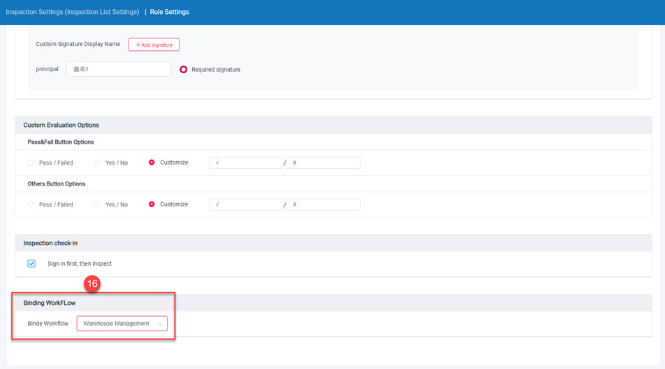

System Settings_Process Design_5_60%.jpg 13: Navigate to the 'Inspection Settings' -> 'Inspection List Settings' 14: Choose an inspection form that will use the sing-off process 15: Click on 'Ruls Settings' to enter the settings page
System Settings_Process Design_6_60%.jpg 16: In 'Binding WorkFlow', choose the sign-off process that will be used, and then click on the 'Save' button to apply the settings

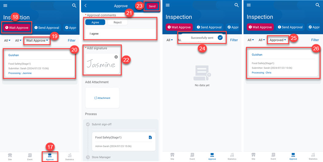

Approval node 1, Jasmine, logs into the inspection app Approval_1_40%.jpg 17: Tap 'Approval' 18: Tap 'Wait Approval' 19: Select 'Wait Approval' 20: Tap here to enter the approval page 21: Tap the 'Agree' option and enter some notes 22: Sign here 23: Tap on the 'Send' button to apply settings 24: An approval successful message will be displayed 25: Select 'Approved' 26: List all approved sign-off processes for the current approval node
Approval node 2, Chris, logs into the inspection app Approval_2.jpg 27: Tap 'Approval' 28: Tap 'Wait Approval' 29: Select 'Wait Approval' 30: Tap here to enter the approval page 31: Tap the 'Agree' option and enter some notes 32: Sign here 33: Tap on the 'Send' button to apply settings 34: Select 'Approved' 35: List all approved sign-off processes, and then click on one 36: It will display the details of all approval nodes

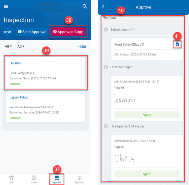

Copy Notification Receiver, Kevin, logs into the inspection app Approval_2_40%.jpg 37: Tap 'Approval' 38: Tap 'Approved Copy' 39: List all received notifications of signed-off copies 40: Tap notification to view the approval details 41: Tap the 'view report' icon to view the details of inspection report
