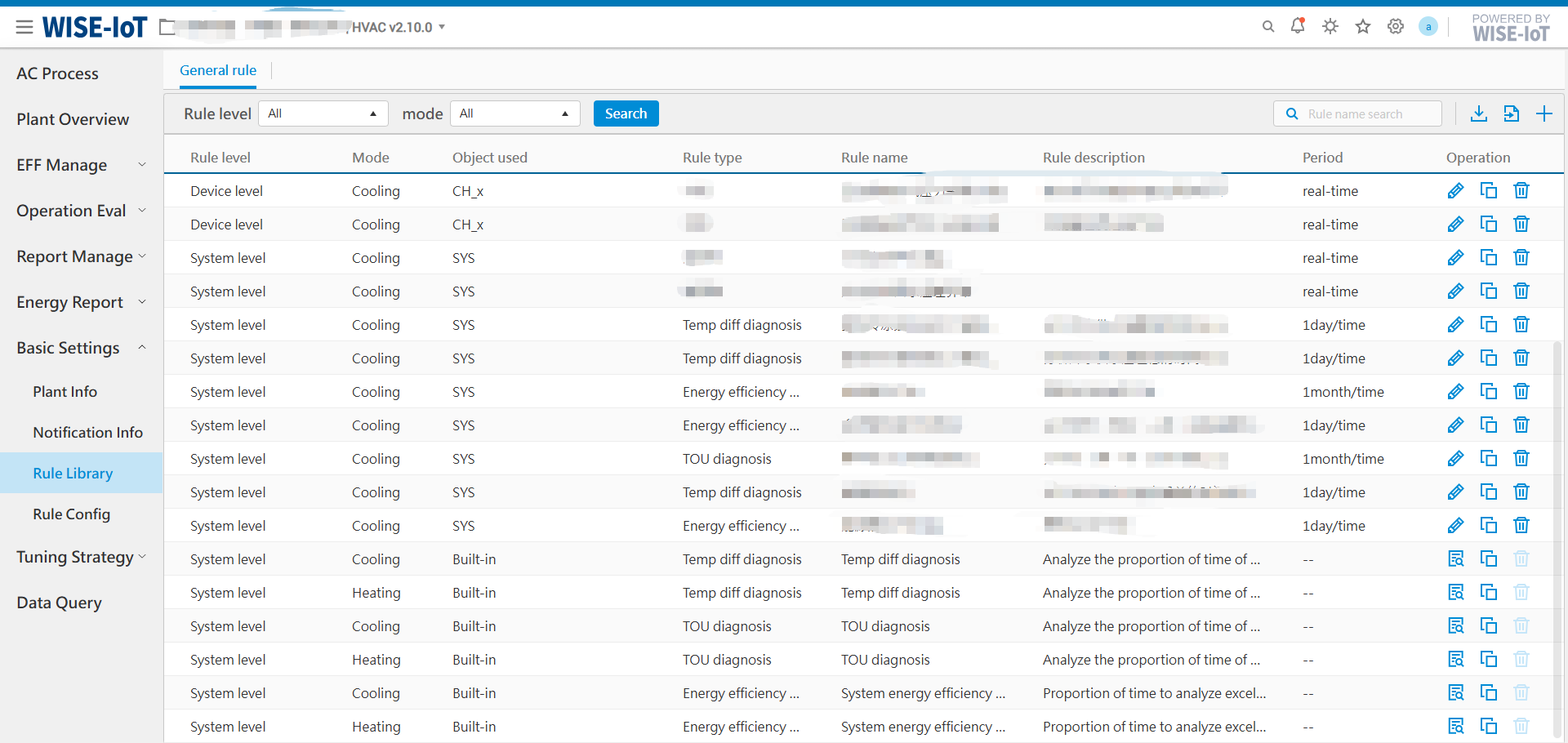

3.4.1 Apply Diagnostic Rule Library Templates​
Directly apply rules from the template library to selected energy stations. This primarily includes two components:
  1. Select Applicable Rules: Select applicable rules for energy station nodes from the rule template library, with filtering support by rule level and mode.

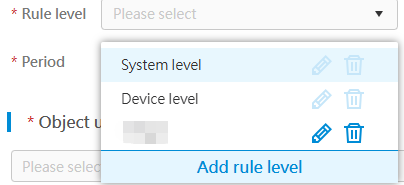

    Note: The rule levels in "Apply rules from the diagnostic rule library", "Custom rules", and the rule library are synchronized. Any newly added rule levels—whether added directly to the rule library or under Rule Configuration > Custom Rules—will be visible in all three sections upon the next viewing.

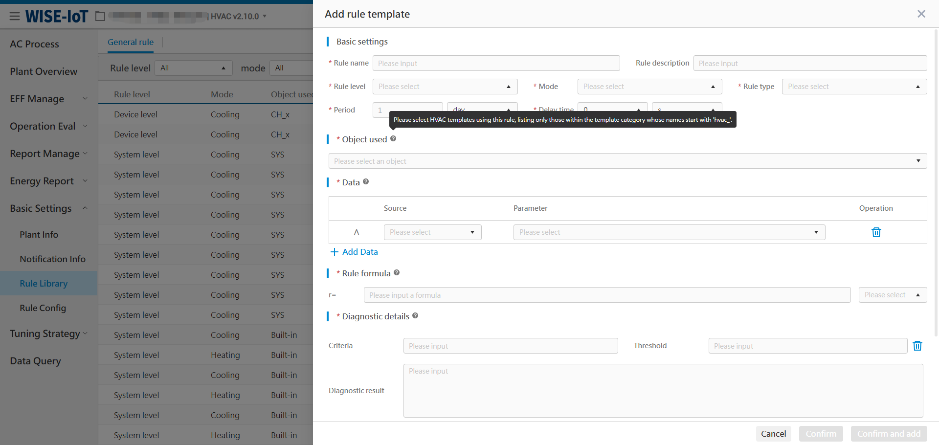

3.4.2 Custom Rules​
Configure node-specific rules directly.
Custom Rules

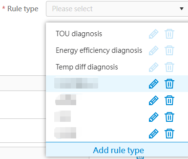

The configuration fields for custom rules are similar to those in the "Add/Edit Rule Template" section (3.3 Rule Library), with the following key differences:
Target Object: Refers specifically to HVAC asset group nodes, with selection restricted to either energy station nodes or their subordinate nodes (including both direct and indirect child nodes), as shown in the following example:
Custom Rules - Target Object
Data Items: Parameters can be selected from either the current node (the target object itself) or other nodes within the same selection scope as the target object (energy station nodes or their subordinate nodes), as demonstrated in the following example of selecting parameters from other nodes:
Custom Rules - Data Items
Notification Group Configuration: Configures notification groups for triggered rules (same configuration method as in Section 3.4.1 "Applying Diagnostic Rule Library Rules).
