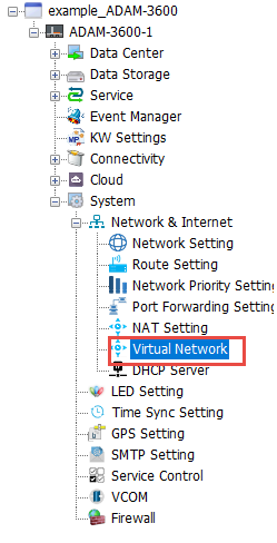

Step 2: Open the EdgeLink Studio project ---> System ---> Network and Internet ---> Virtual Network

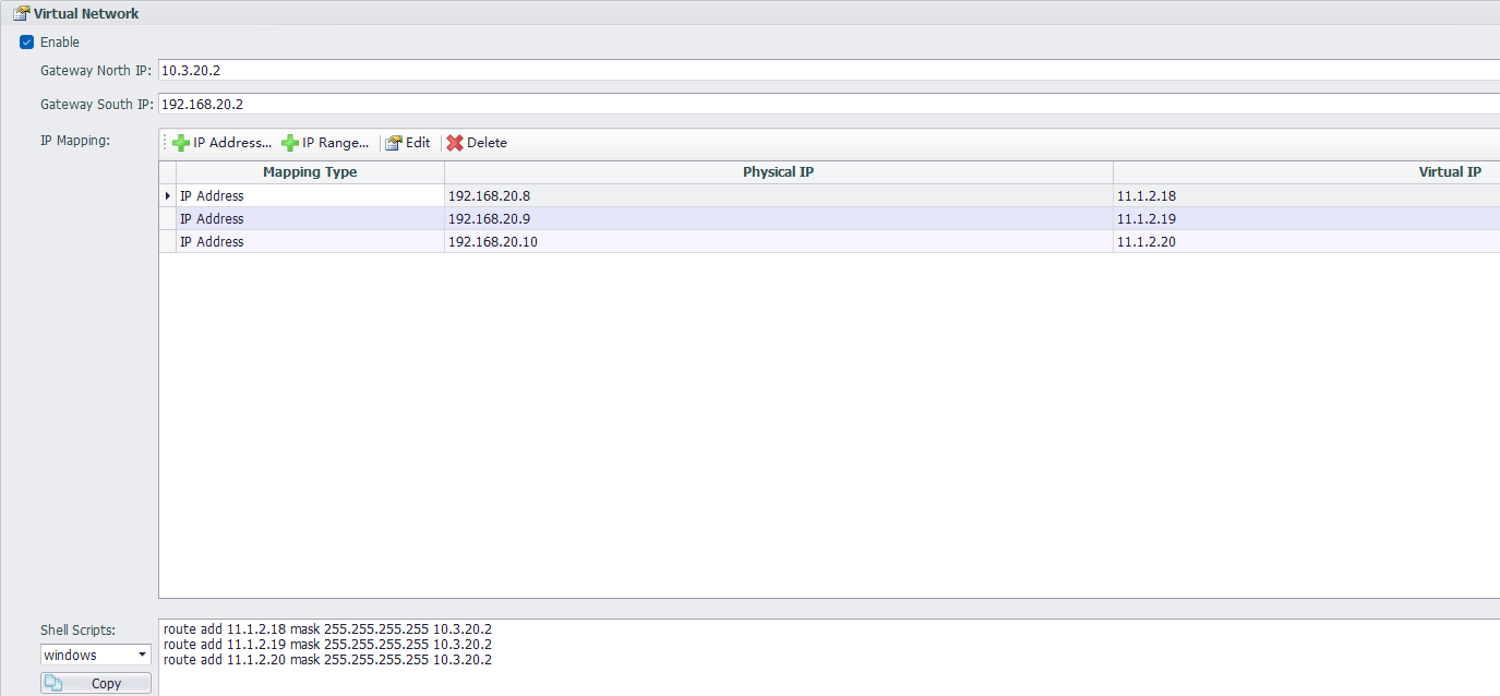

Step 3: Complete the configuration and download the project to the gateway
Parameter Description
Basic Configuration

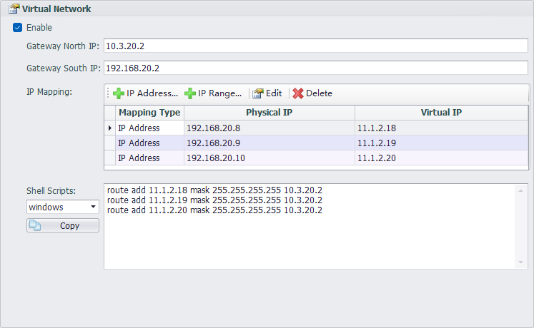

  • Enable: Selecting enable will establish a virtual network according to the configuration.
  • Gateway North IP: The network IP connecting the gateway to the control center.
  • Gateway South IP: The network IP connecting the gateway to the southbound device.

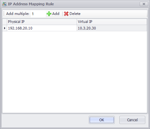

  • IP Address Mapping: Add the mapping between physical IP and virtual IP (edit IP Address as you need).
        1. Click "Add" to add a mapping relationship.
        2. After modifying the number of additions, click "Add" to add multiple mapping relationships at once.
        3. Click "OK" to add the mapping relationships to the IP mapping table.

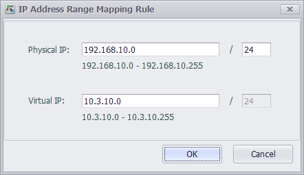

  • IP Range Mapping: Edit the IP mapping range.
        Edit the network segment and subnet mask bits of the physical IP and virtual IP to adjust the networking range.

  • The control center needs to add corresponding routes to implement the overall virtual networking application. Based on the IP mapping configuration, EdgeLink Studio automatically generates the corresponding control center route script (Windows and Linux versions). Copy this script to the control center computer and execute it on the command line.
