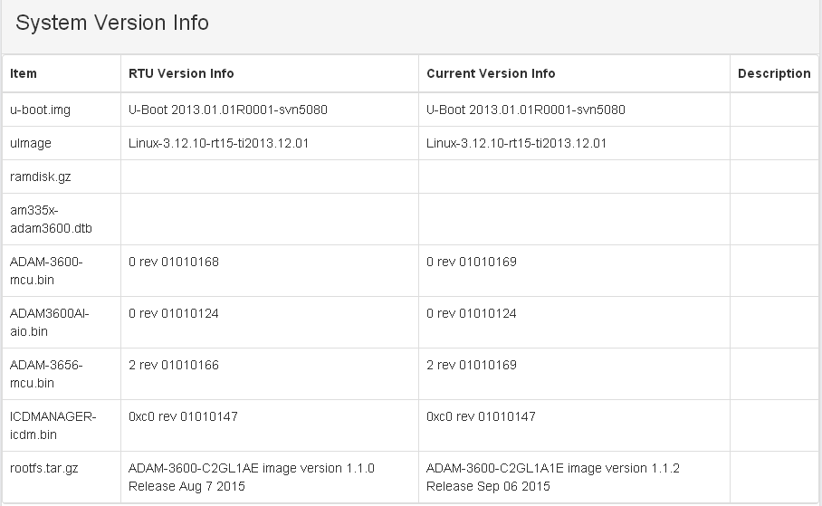

The system version information of the current device is displayed as follows:
The software version information of the current device is displayed as follows:

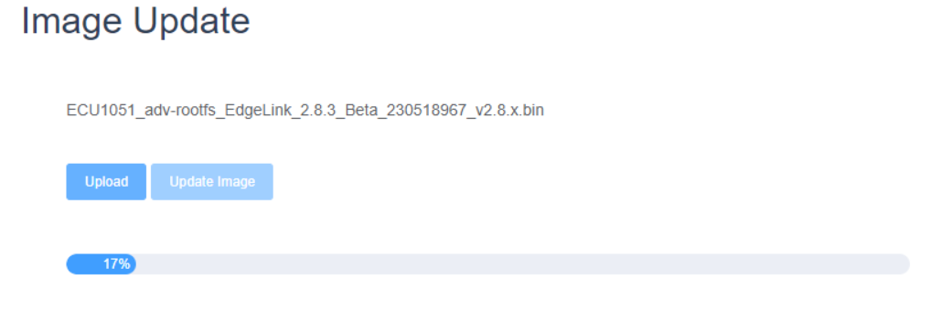

  2. The process of uploading the file is shown below, and the whole process takes about a few minutes.
    Before updating, you can choose whether to check 'Restore factory default settings', if checked, the original configuration will be cleared after the upgrade.

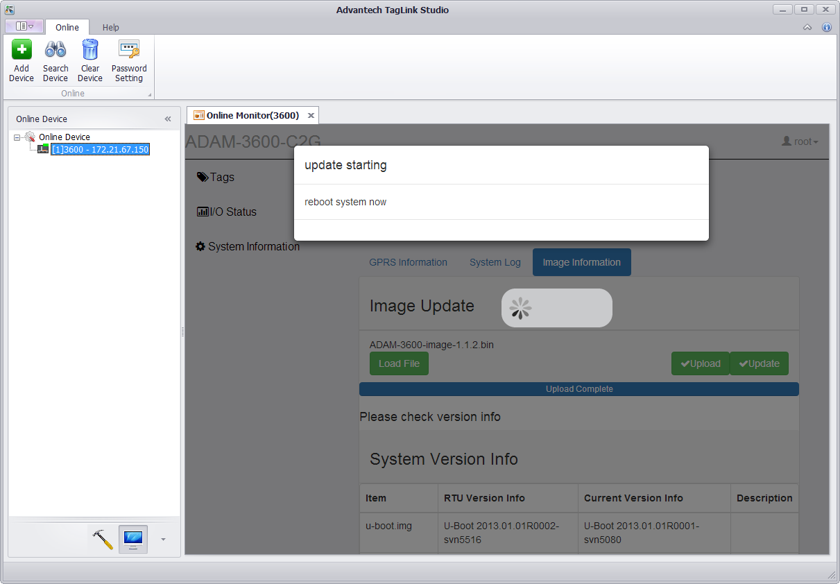

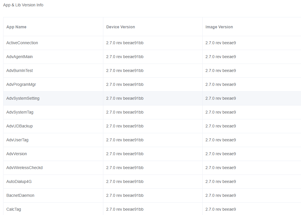

  3. If the file is successfully uploaded, the 'Update Image' button will be displayed, as shown in the red box above. At the same time, the version number of each file in the uploaded package is listed, as shown in the following figure.
  4. Click Update to start the Image update, and the update process is shown in the following figure.
