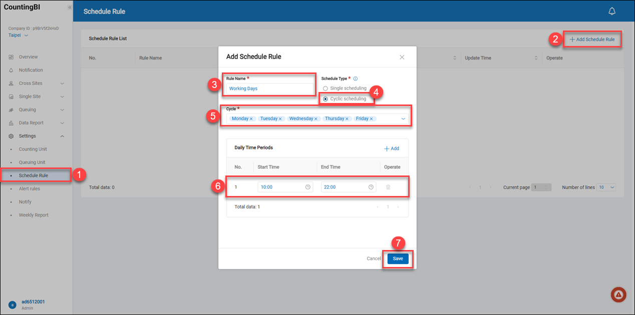

Scenario_Sending Notification_WhatsApp_3.png 1: Navigate to 'Settings' -> 'Schedule Rule' 2: Click on the '+ Add Schedule Rule' 3: Enter the rule name. 4: Select 'Cyclic scheduling.' 5. Choose any day throughout the week. It will repeat the cyclic schedule every week. 6: Set a daily time period with a start time and an end time. For example, from 10:00 AM to 10:00 PM. 7: Click on the 'Save' button.

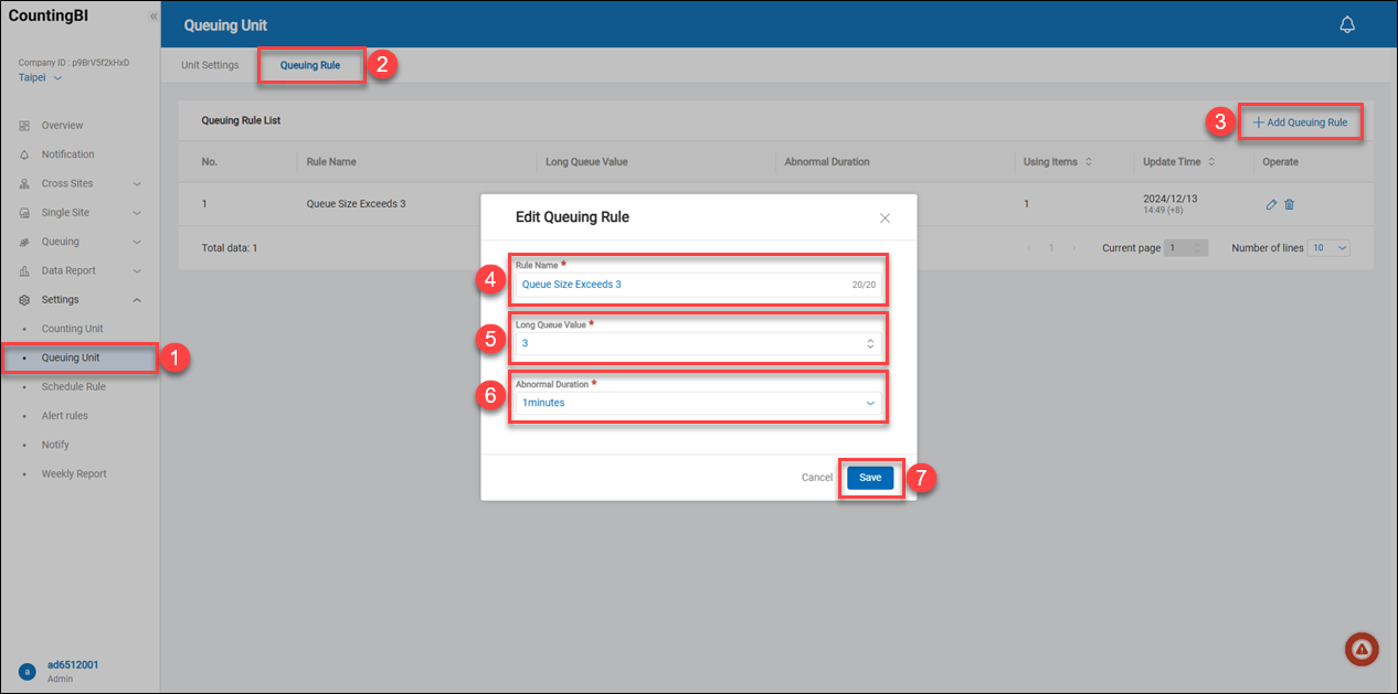

Scenario_Sending Notification_WhatsApp_4.png 1: Navigate to 'Settings' -> 'Queuing Unit' 2: Click on the 'Queuing Rule' 3: Click on the '+ Add Queuing Rule' 4: Enter the rule name. 5: Set the maximum number of people in the queue. Here is an example: 3 people. 6. Select '1 minute.' This item is designed to calculate the duration during which the number of queuing people reaches the ‘Long Queue Value.’ 7: Click on the 'Save' button.

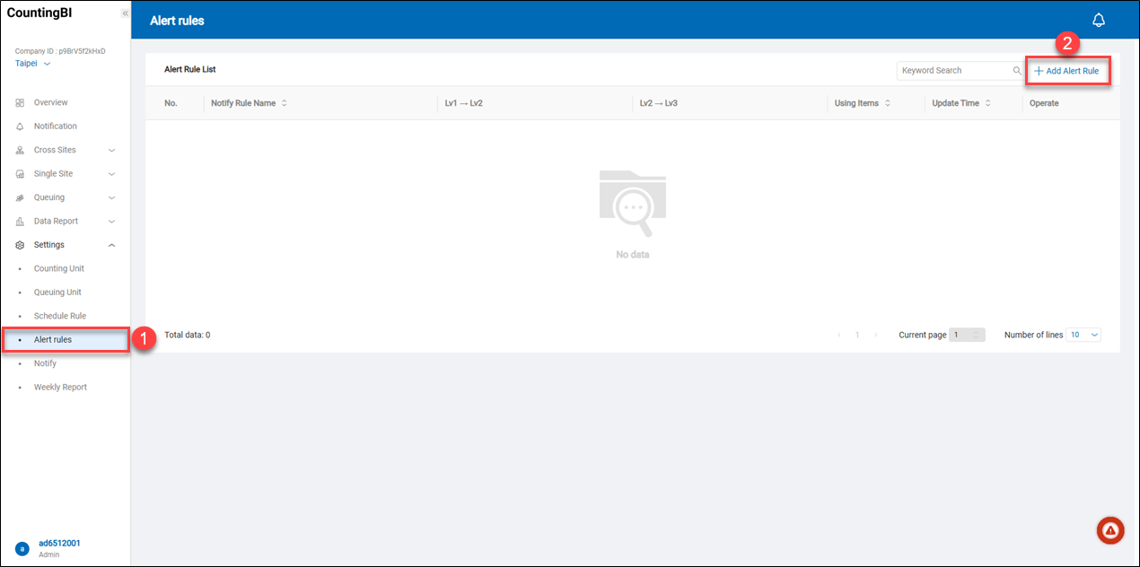

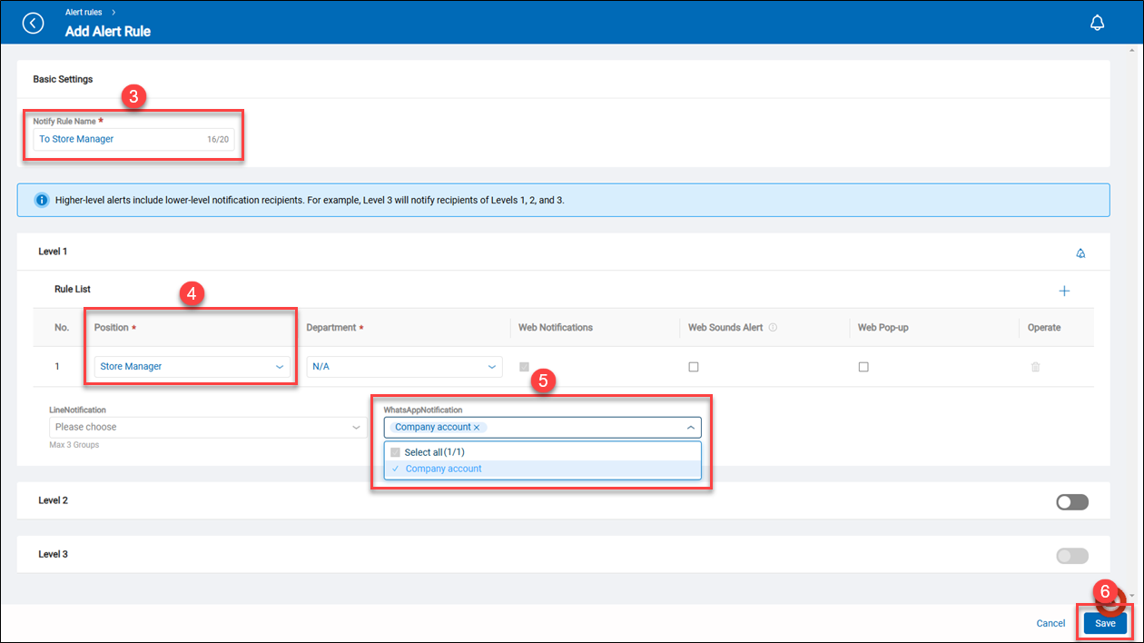

Scenario_Sending Notification_WhatsApp_5.png 1: Navigate to 'Settings' -> 'Alert rules' 2: Click on the '+ Add Alert Rule' Scenario_Sending Notification_WhatsApp_6.png 3: Enter the notify rule name. 4: On Level 1, select a job position. Here is an example: 'Store Manager.' The store manager is Jasmine. 5: Select an added WhatsApp notification sender. 6: Click on the 'Save' button.
