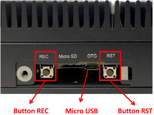

- Make sure the MIC-711 is completely shut down.
Connect USB Cable
- Use a USB Type-A to Micro USB cable to connect the MIC-711 (Micro USB port) to your host PC.
Prepare to Enter Flash Mode
- Do not power on the device yet.
- Press and hold the
RECbutton.
Power On and Reset
- While still holding the “REC” button, plug in the power cable to turn on the device.
- Press the “RST” button once.
Hold and Release
- Keep holding the “REC” button for about 5–10 seconds, then release it.
On Host PC,verify recovery mode by checking if NVIDIA Corp is detected:
lsusb | grep "NVIDIA Corp"Expected output:
0955:7323 NVIDIA Corp
