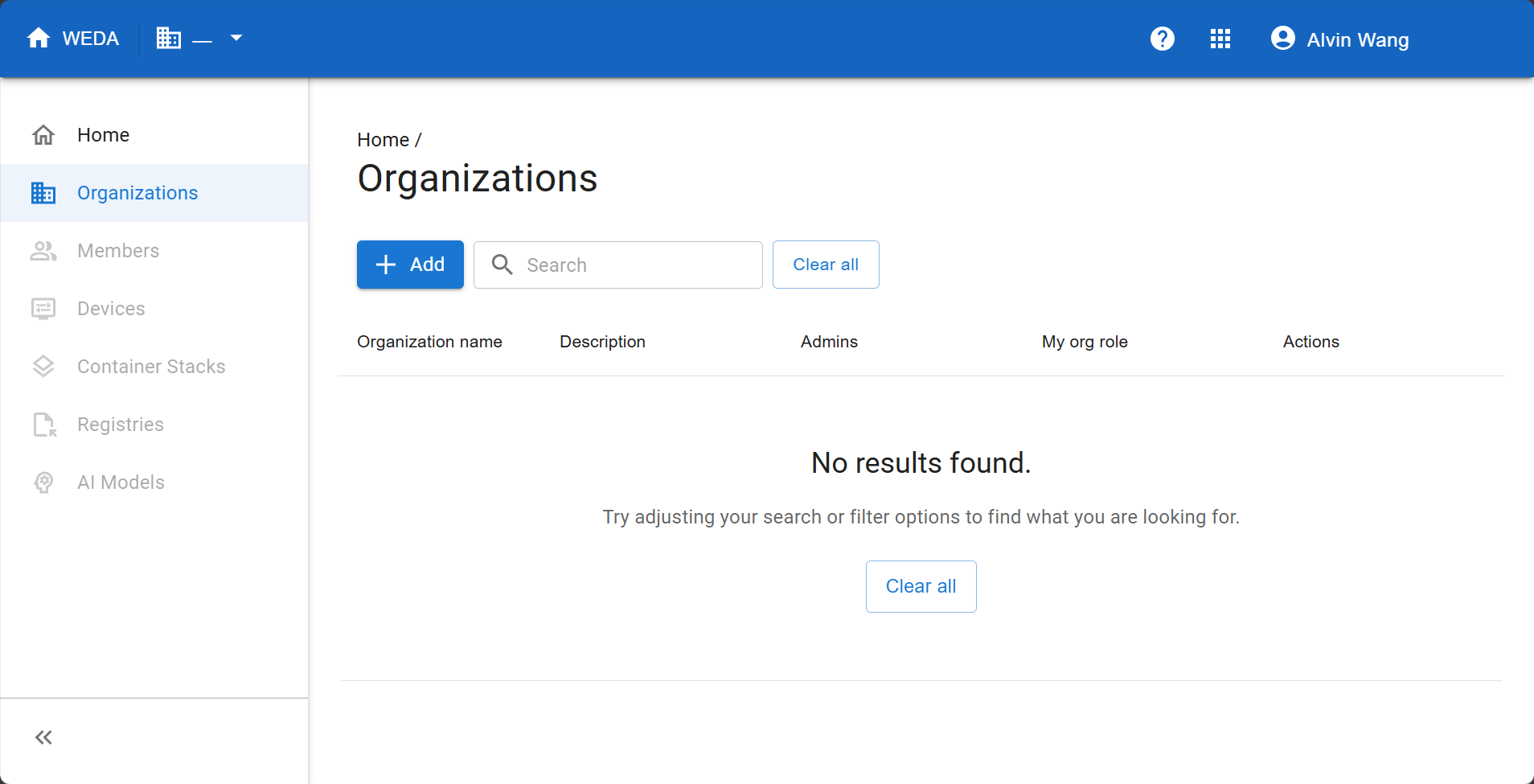

1. Select or Create an Organization
An Organization groups resources such as devices and defines an access boundary. Your role in that organization determines which operations you can perform. Select the organization that should own this device and confirm that you have permission to manage its devices.
Choose the path that matches your environment:
- Existing organization: Open the organization menu in the top bar, select Browse all orgs, then choose the organization in Switch Organization.
- New organization: Follow the steps below to create one.

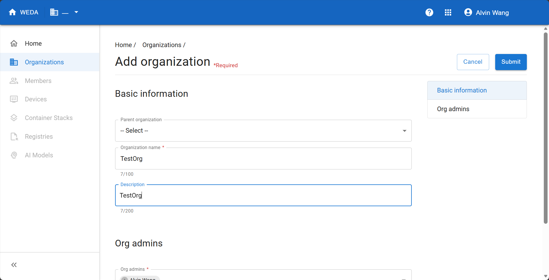

- Open Organizations in the left navigation and select Add.
- In Basic information, complete the organization details:
- Parent organization: Select a parent if you are creating a sub-organization.
- Organization name: Enter a name for the organization.
- Description: Optionally describe the organization.
- In Org admins, assign at least one administrator.
- Select Submit, then Add in the confirmation dialog.

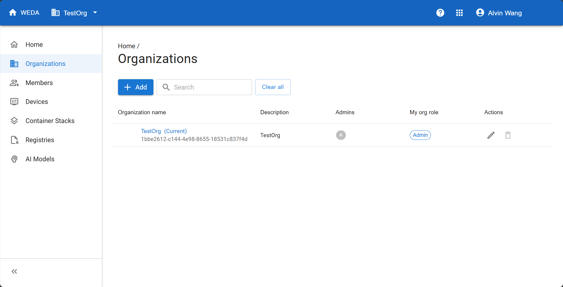

- Confirm that the new organization appears in the list. If it is not already current, select it through Browse all orgs in the top-bar organization menu.
Check the result: The intended organization is selected in the top bar, and you have permission to manage its devices.
Contact your WEDA administrator if you cannot access it or do not have the required permissions. Membership in a parent organization does not automatically grant access to its child organizations.
