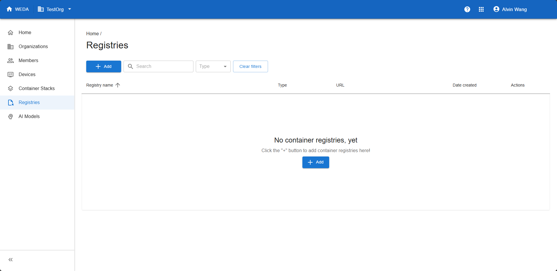

  1. In WEDA Console, select the target devices' Org and open Registries.
  2. Check whether a configuration for the registry host already exists. Reuse or update that configuration when appropriate.
Registries list in TestOrg with no configurations and an Add entry.
Select the intended Org and inspect its existing registry configurations before adding one.

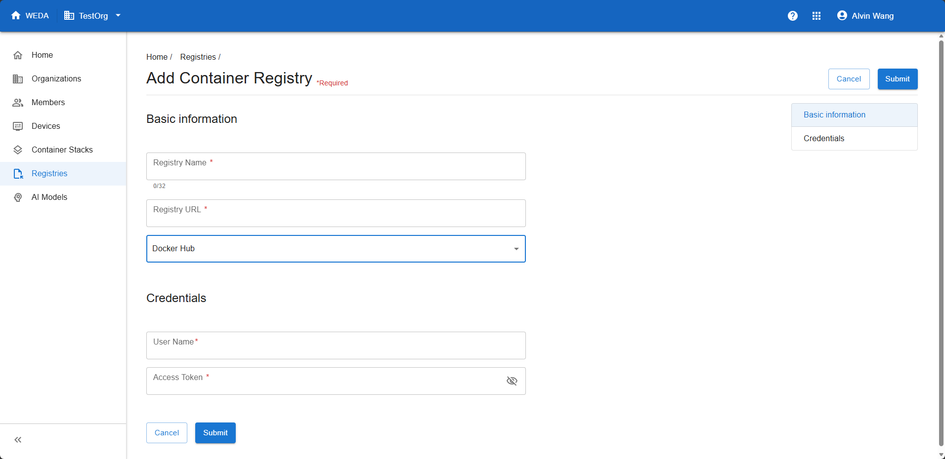

  1. Select Add.
Add Container Registry form with Docker Hub selected and fields for Registry Name, Registry URL, User Name and Access Token.
The credential fields depend on the selected registry type. Docker Hub uses a username and access token.

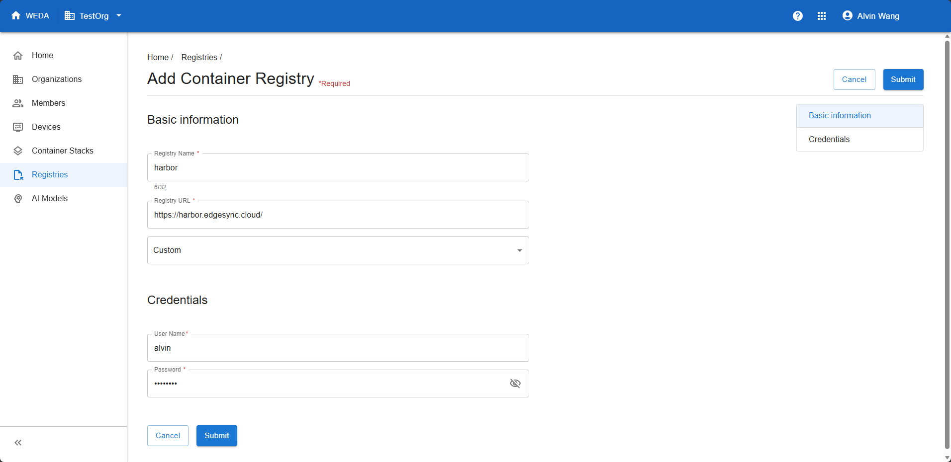

  1. Choose the Registry Type and complete Basic information:
    • Registry Name: A unique name, such as harbor.
    • Registry URL: Your registry address, such as https://harbor.company.com.

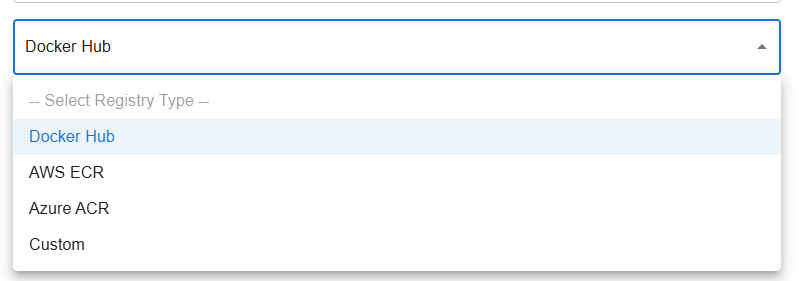

    • Registry Type: Custom for this Harbor example.
Registry Type options showing Docker Hub, AWS ECR, Azure ACR and Custom.
Choose the registry provider whose credential requirements apply to your image source.
  1. Enter the registry account's username and password in Credentials.
Custom registry form named harbor, with a registry URL, account name and masked password.
This Custom registry example uses account credentials. Use your own registry address and keep password or token values masked.

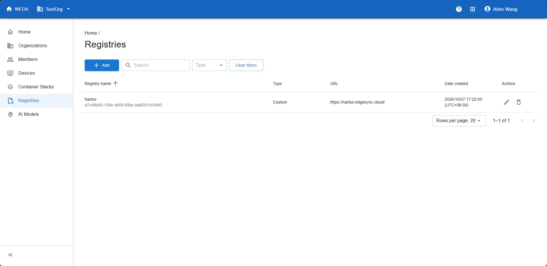

Check the result: The configuration appears in the selected Org's registry list. Confirm its name, URL and type. API clients receive 201 Created and should retain the returned registryId for later reads, updates or deletion.
TestOrg registry list containing harbor with Custom type and its registry URL.
Confirm that harbor appears in the intended Org with the expected URL and type.
Saving a configuration does not confirm that a target device can reach the registry or pull a particular image. Check those results during deployment.

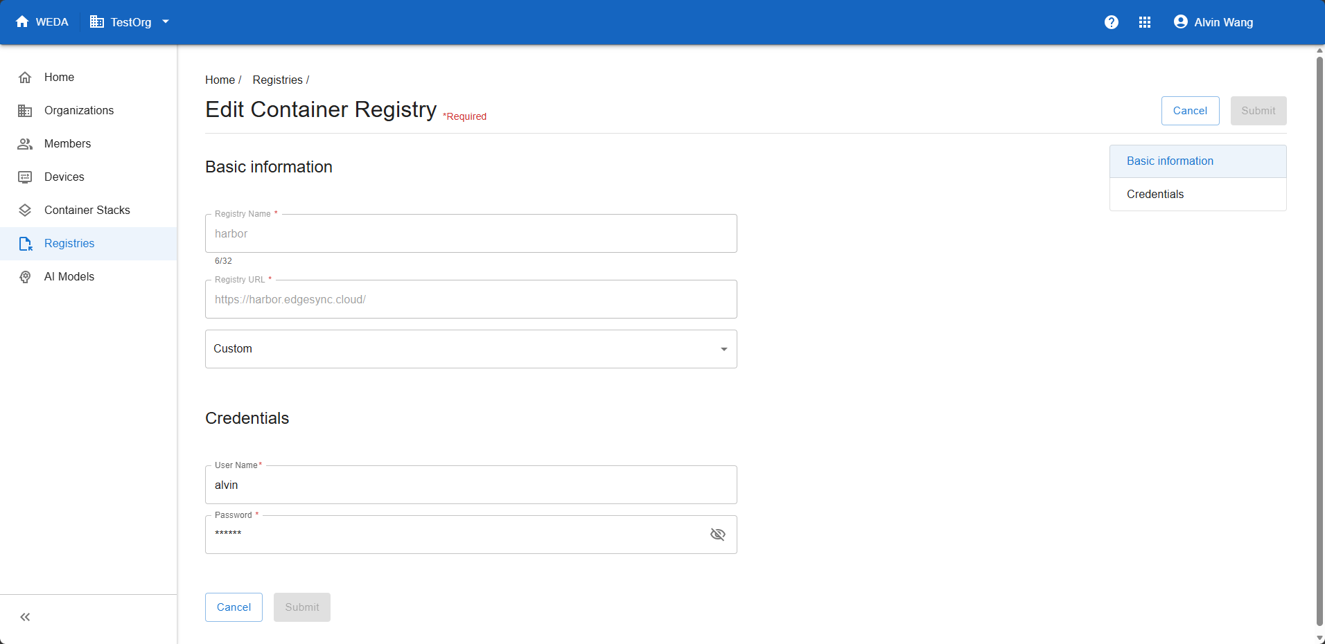

In WEDA Console: Select the configuration's edit icon in the registry list. In the form shown below, Registry Name and Registry URL are read-only; edit the available type or credential fields as needed, then select Submit and read the configuration back.
Edit Container Registry form with Registry Name and Registry URL read-only and type and credential fields displayed.
Inspect the existing configuration before changing its access settings. Follow the selected registry type's credential requirements.
