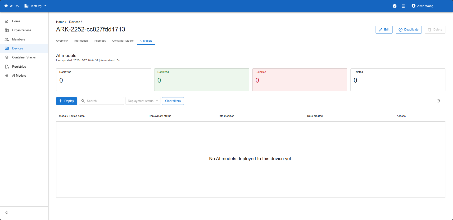

Devices → device → AI ModelsSelect Deploy, then choose the Models and one Uploaded Edition for each.
WEDA Node AI Models tab with a Deploy entry and no AI models deployed to this device.
The AI Models tab shows this device's model deployments. Select Deploy to choose Models and Editions.
For the example below, choose one WEDA Node and one Edition. Check the selected device ID before continuing.
