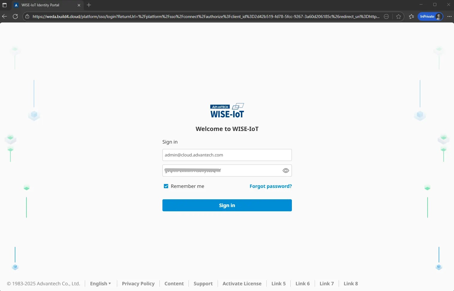

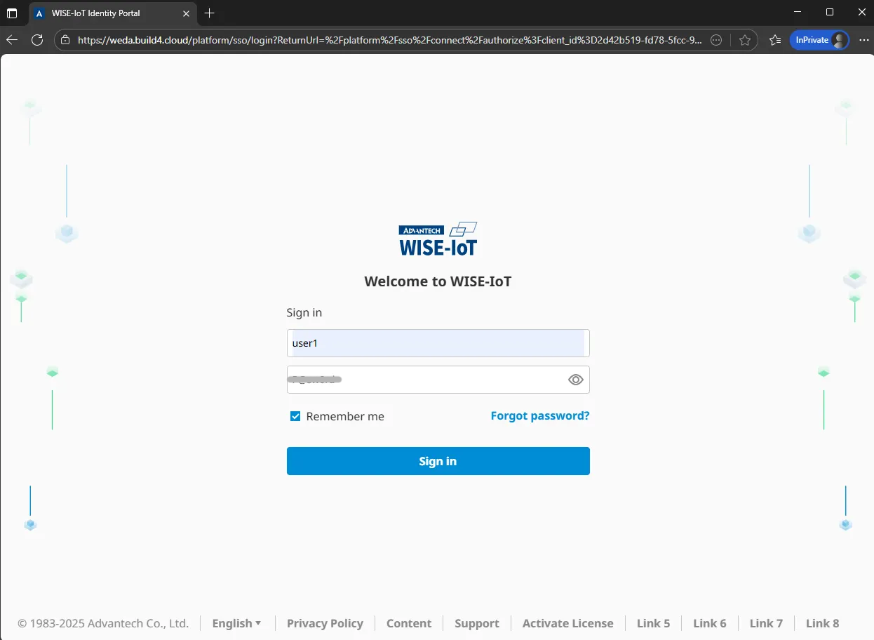

1. Sign in WEDA Desk
Open a web browser and go to the Desk: https://<domain>/platform/desk. Replace <domain> with the actual domain.
You will be automatically redirected to the correct login page.
Log in with the default SSO credentials.

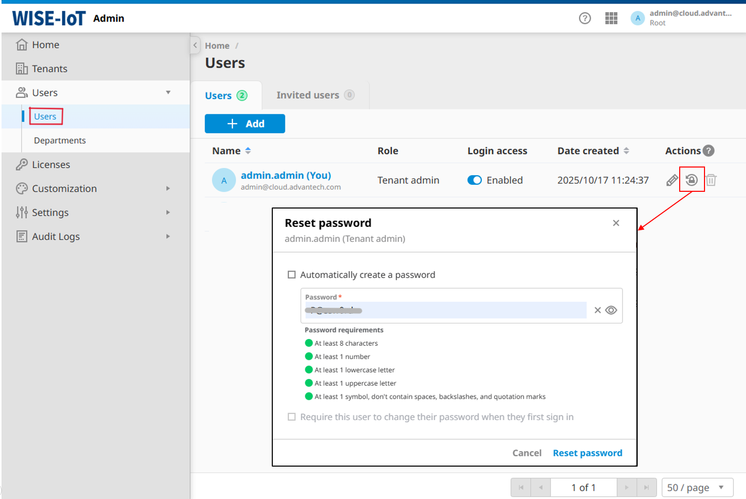

2. Reset Admin Password
Go to User in the left menu, find admin@cloud.advantech.com, and reset the password.
WEDA Reset the Password

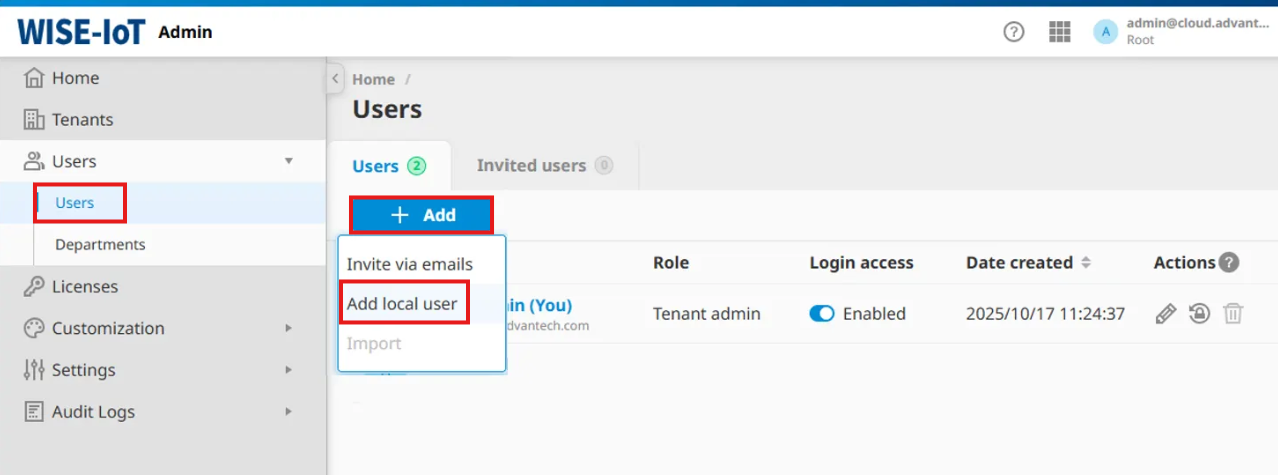

3. Add a Local User
Click + Add button to create a new User.
WEDA Add a New User

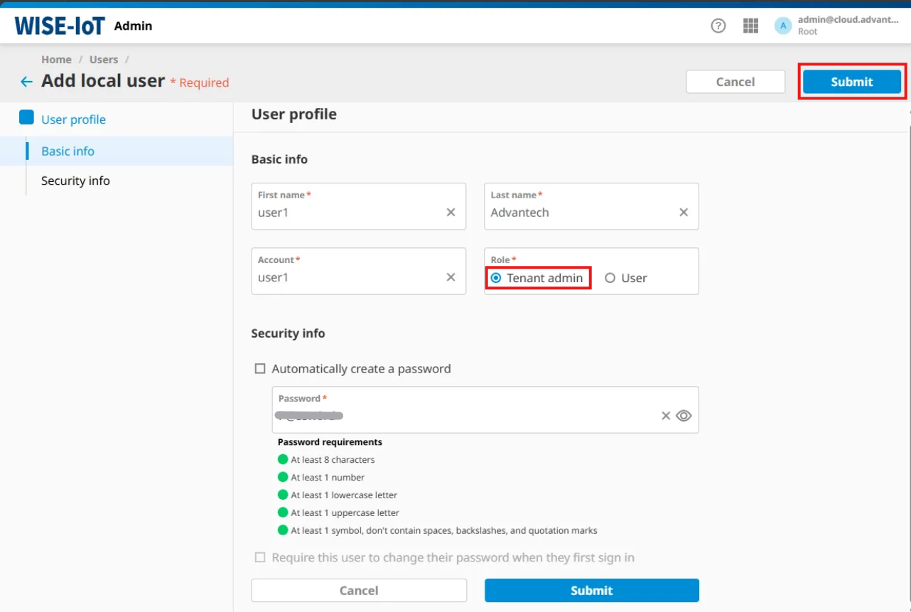

Fill in the user details and choose Tenant Admin as the role.
  • First name
  • Last name
  • Account name
  • Your own password
Click Submit.
WEDA Set Up User

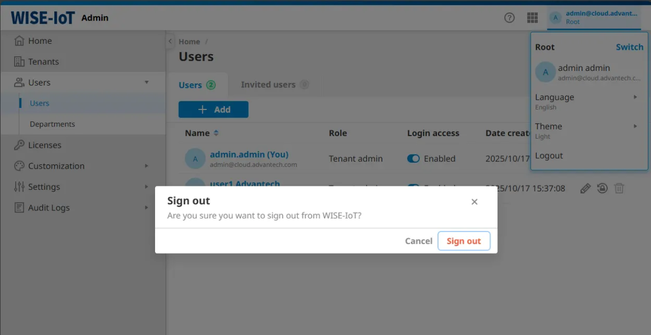

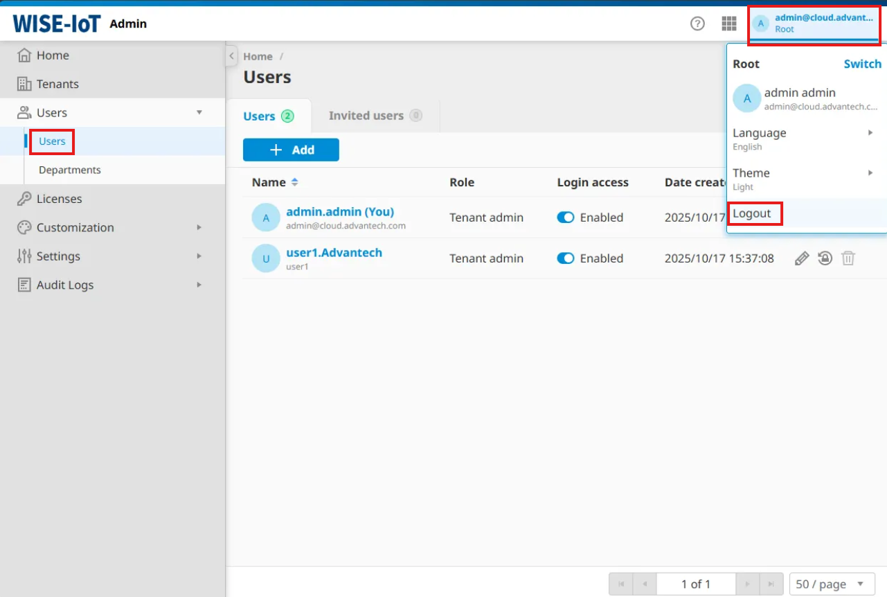

5. Sign Out
Click your username in the top-right corner and select Sign Out.
WEDA Sign Out the Desk-1
WEDA Sign Out the Desk-2

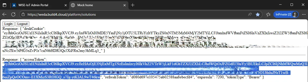

2. Get User WEDA Core Access Token
Open a new browser tab and go to: https://<domain>/platform/solutions.
This page will return two types of tokens:
  • DeskCookie
  • AccessToken - used for WEDA API.
The AccessToken should be included in the Authorization header when calling APIs:
Authorization: Bearer <access-token>
WEDA accessToken

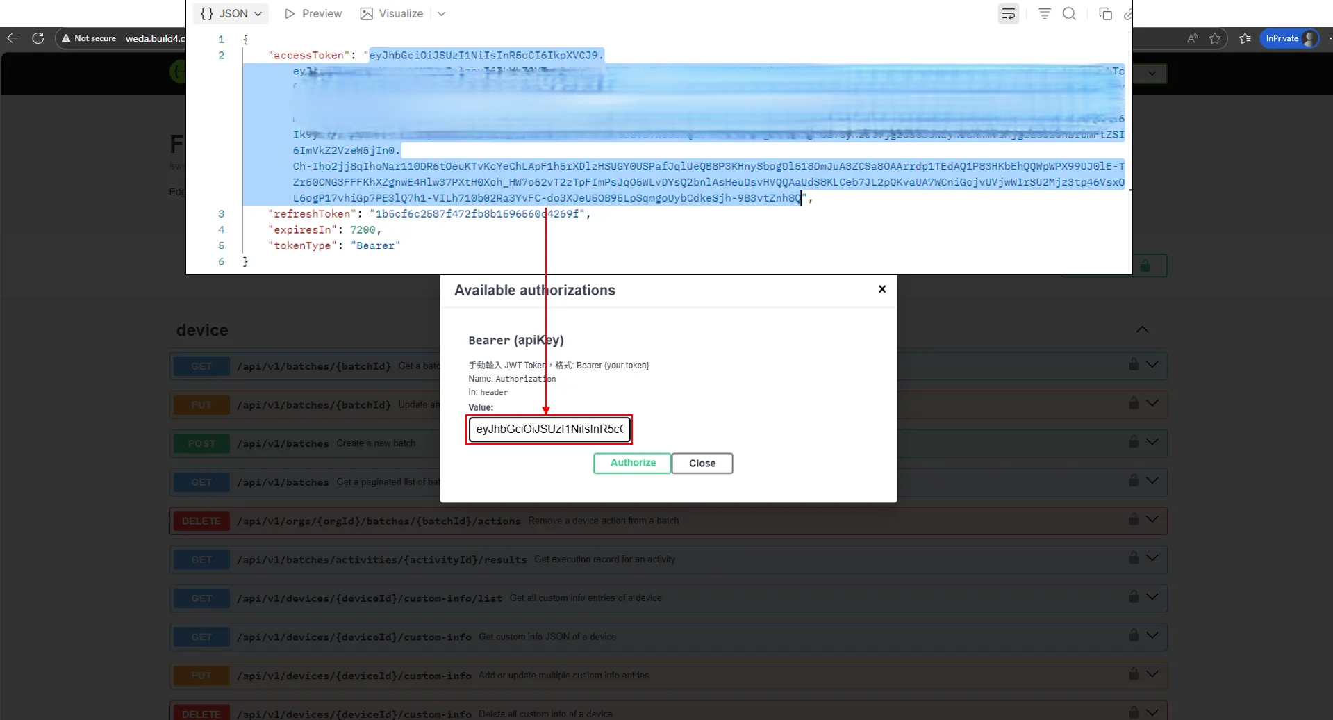

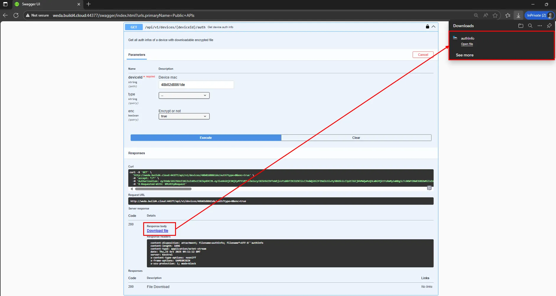

1. Open the Devicemanagement APIs Swagger
Open a web browser and go to the Devicemanagement APIs Swagger: http://<domain>:44377/swagger/index.html.
Authorize the API by entering the accessToken and click Authorize.
WEDA DM Swagger
WEDA API Authorize
2. Download Device Credential File (Active the Device)
To activate the device, request the WEDA Node credential file (authInfo.json) using the following API.
Endpoint
GET /platform/solutions/api/v1/devices/<deviceId>/auth
The API returns the device authentication details and provides a download link for devie credential file (authInfo).
WEDA authInfo download
Download the file and save it as authInfo.json.
WEDA authInfo.json

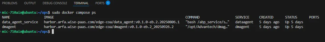

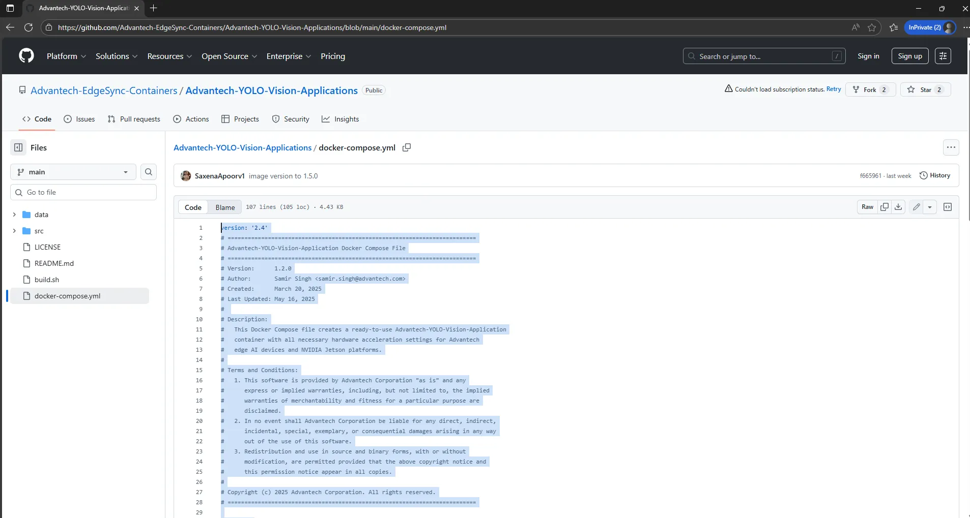

4. Deploy WEDA Node
Upload the downloaded authInfo.json to the edge device. Follow the installation steps in WEDA Node Documentation.
After deployment, verify the services status:
sudo docker compose ps
WEDA Node status
You should see both dmagent and data agent services running.

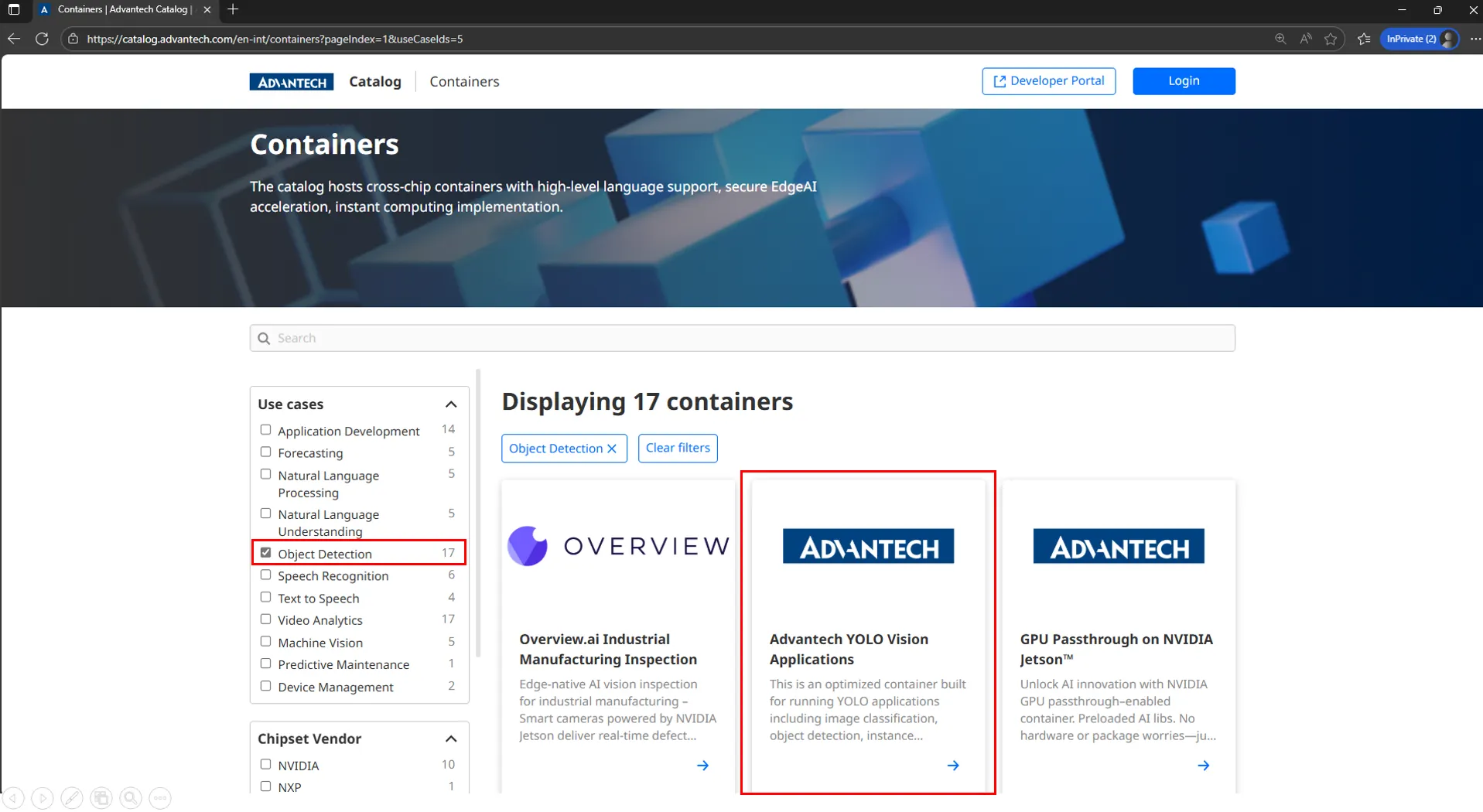

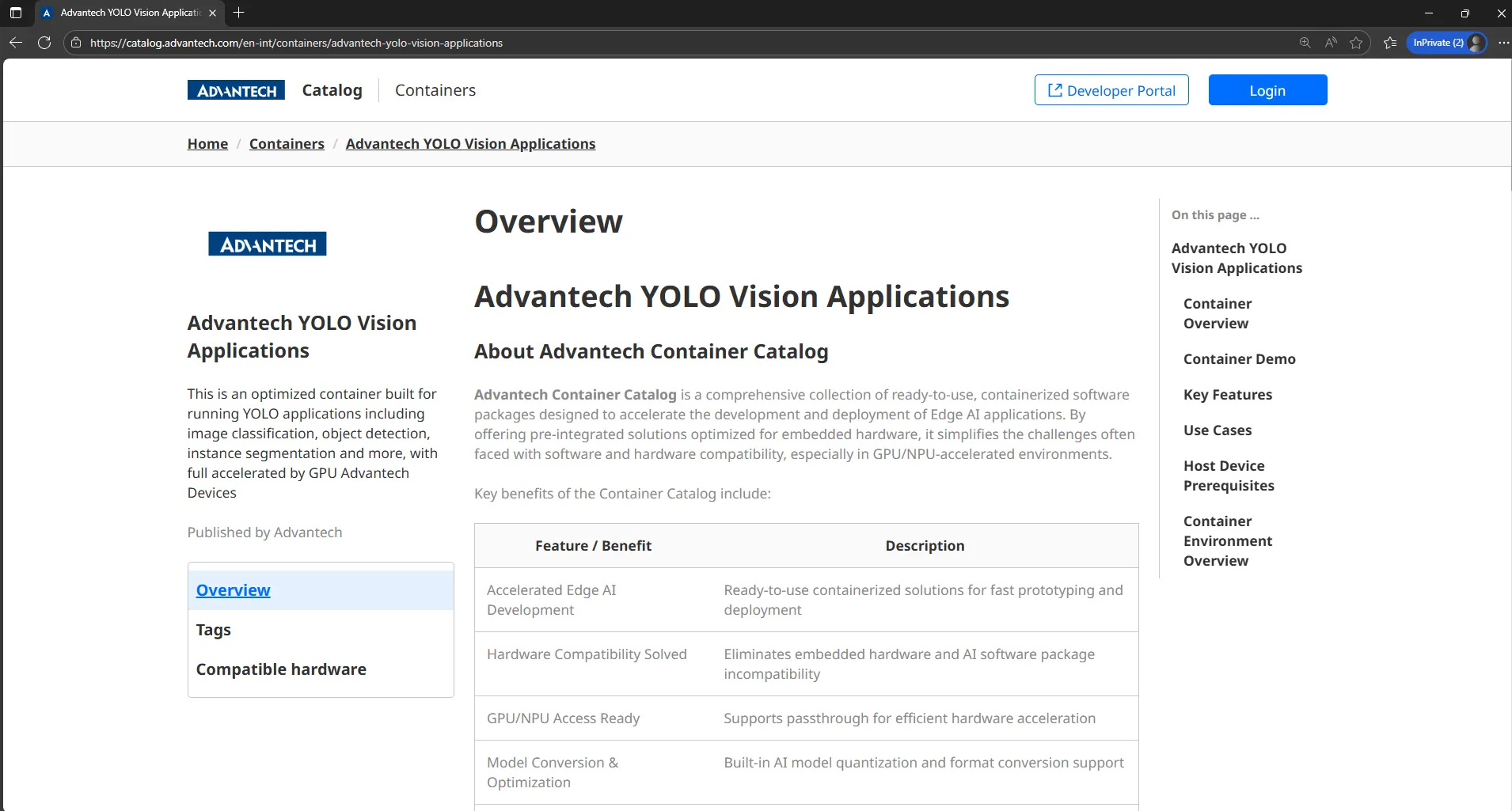

1. Prepare a Docker Compose File
Prepare a docker-compose.yml file, or select a container from the Advantech Catalog which has a GitHub repository link.
WEDA Catalog
WEDA Catalog Container
WEDA Github Link
WEDA Github Repo
WEDA docker-compose.yml

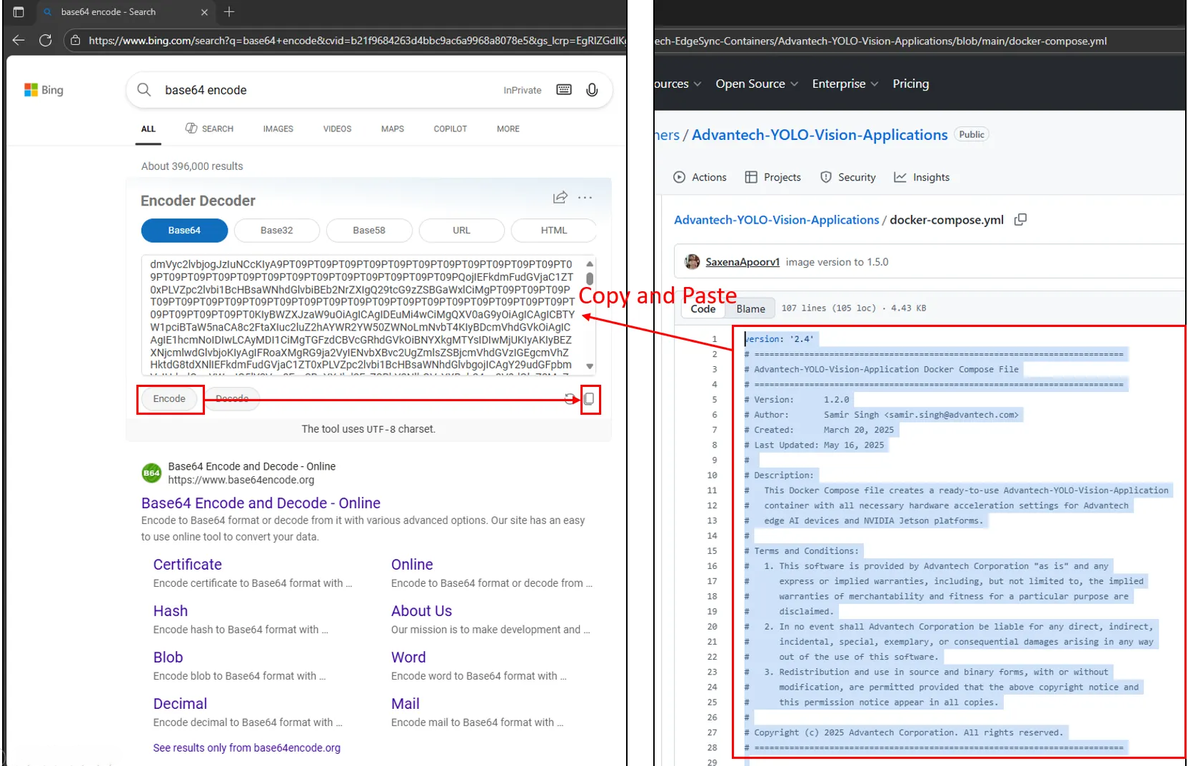

2. Encode the File in Base64
Copy the docker-compose.yml content and encode it in Base64 format. The encoded result will used as composeFileContent in the stack creation API request.
WEDA Base64 Encode
