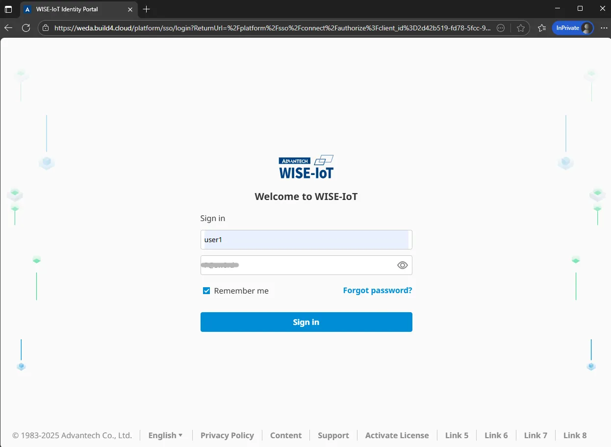

1.1 Sign in WISE Portal
Open a web browser and go to the WISE Portal: https://{domain}/platform/desk. Replace {domain} with the actual domain.
You will be automatically redirected to the correct login page.
Log in with the default SSO credentials.

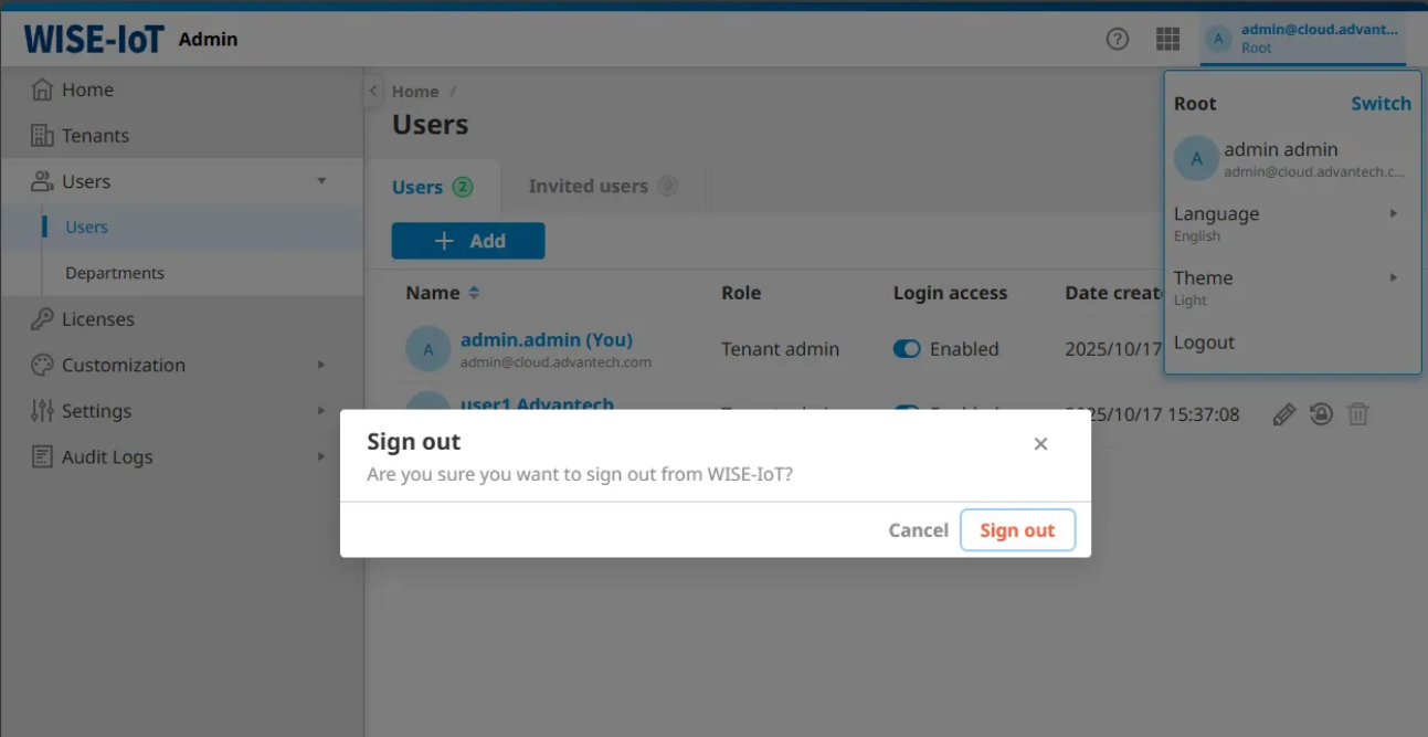

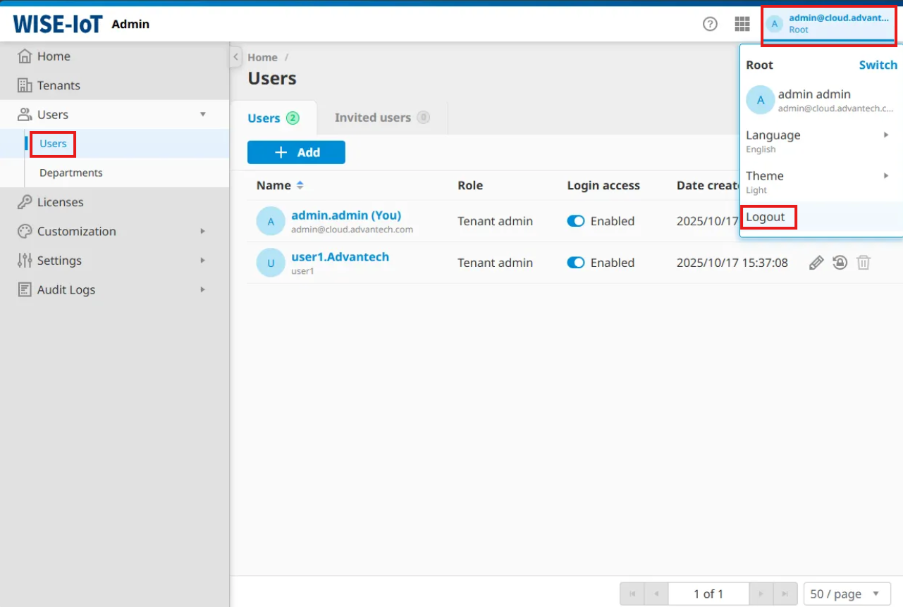

1.4 Sign Out
Click your username in the top-right corner and select Sign Out.
WEDA Sign Out-1
WEDA Sign Out-2

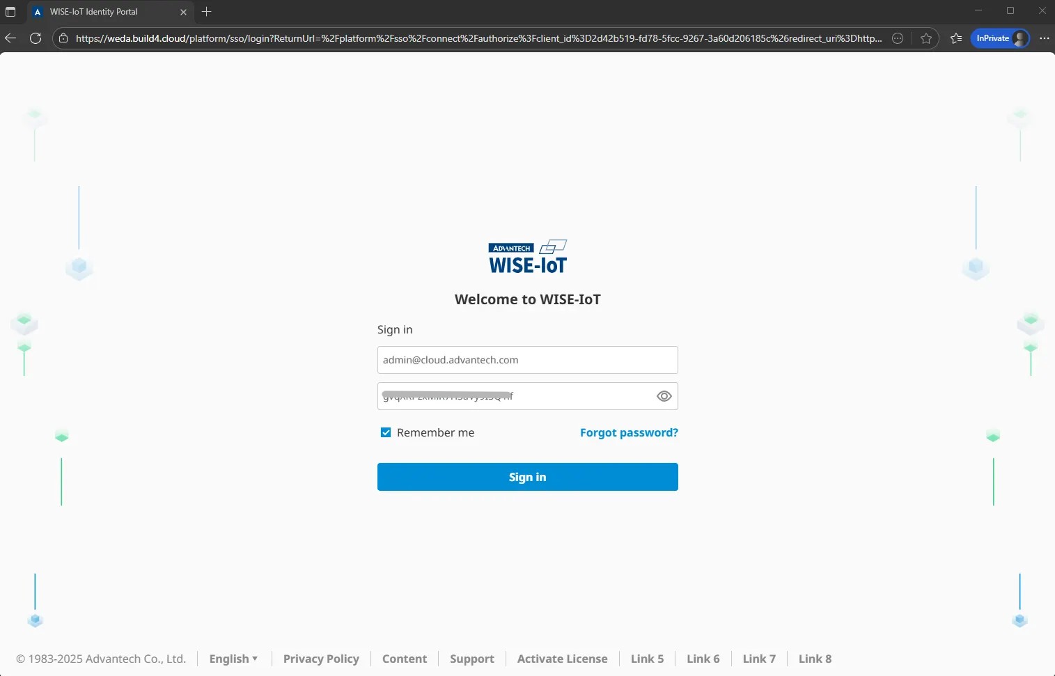

2.2 Sign in WISE Portal
Log in WISE Portal: https://{domain}/platform/desk using the Tenant Admin account.

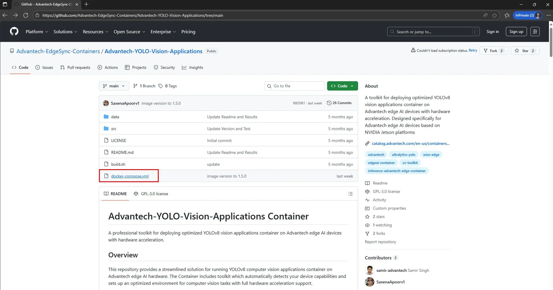

5.1 Prepare a Docker Compose File
Prepare a docker-compose.yml file, or select a container from the Advantech Catalog which has a GitHub repository link.
WEDA Catalog
WEDA Catalog Container
WEDA Github Link
WEDA Github Repo
WEDA docker-compose.yml
