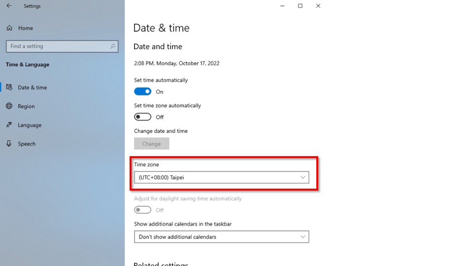

Step1. Switching Time Zone and Time > The time zone and time are crucial for the player. Incorrect settings can affect the playback time and sequence.

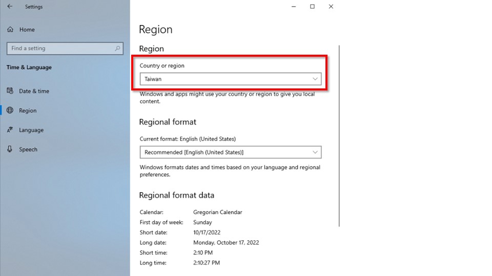

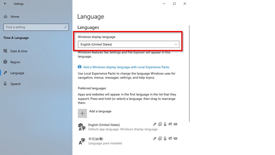

步驟3. Switching Language(Options) The default language is English. Please choose the corresponding language based on your region. 投影片14.JPG

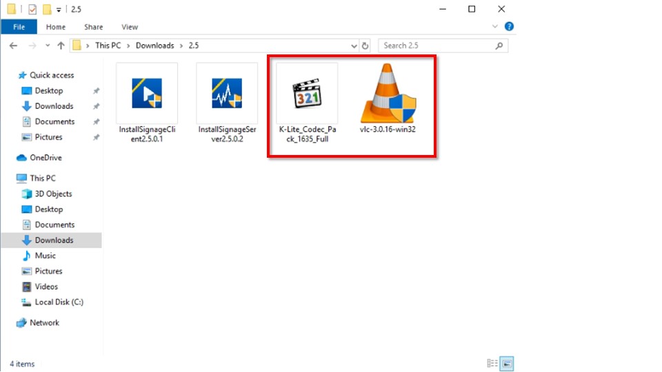

2. Decoder Download and Installation
>Due to the wide variety of video formats available in the market, the built-in decoder in Windows may not be able to support all of them. Therefore, additional installation is required. > "After installation, you will need to choose the appropriate decoder on the server side for video support in program production."

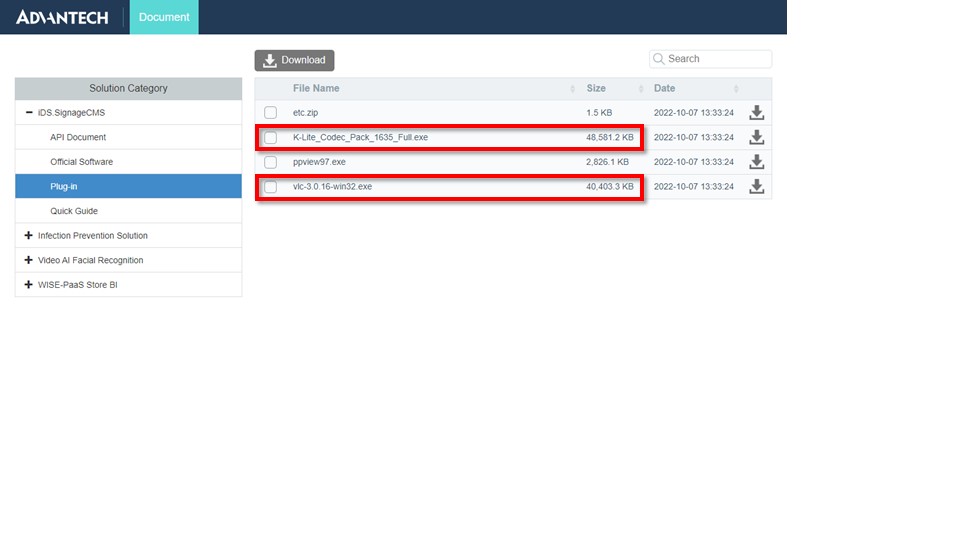

Step 1. Download the Software iDS.SignageCMS Player Software Version Information
DecoderSoftware Version
K-Lite Codec17.7.5 Full
VLC Player3.0.18(Win32)
Open the browser, enter the URL,and you can find it in iDS.SignageCMS-->Plug-in . Please download the relevant software according to your needs. 投影片15.JPG

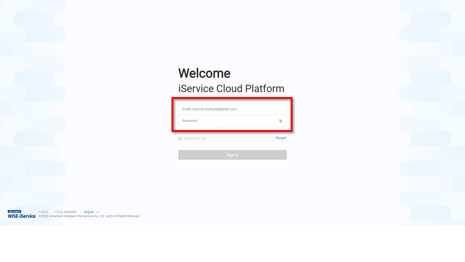

Step1. Open the Chrome or Edge browser, enter the public cloud's address ,, and log in to the homepage with your username and password. > If you don't have an account and password, please contact the brand manager to create one.

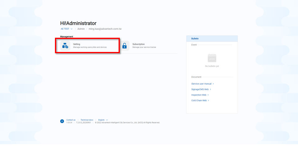

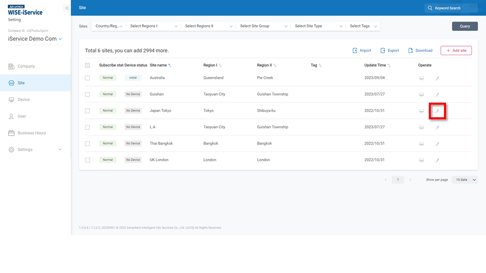

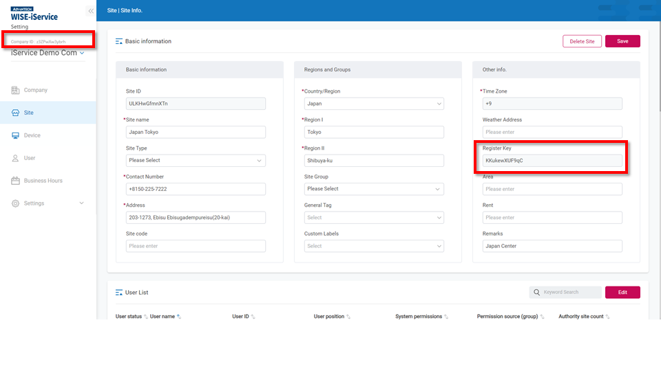

Step3. In Site Management, select the Site where you want to register the device, then click the "Edit" button > If you cannot find the store you want to register, please contact the administrator to add it.
Step4. Record the Company ID and Register Key. You will need to enter them in the player later. 3.1 Public Cloud Registration-3.png

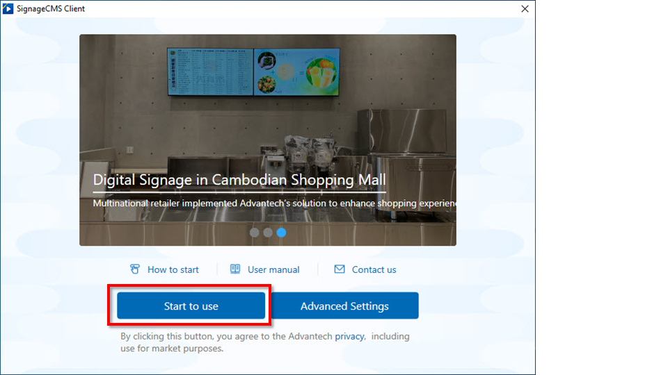

Step2. Click 'Start to use' to proceed to the next step. If you prefer to use the traditional setup, click 'Advanced setting' and proceed to section 3.2.2 for advanced setup mode. Guided Mode1.png

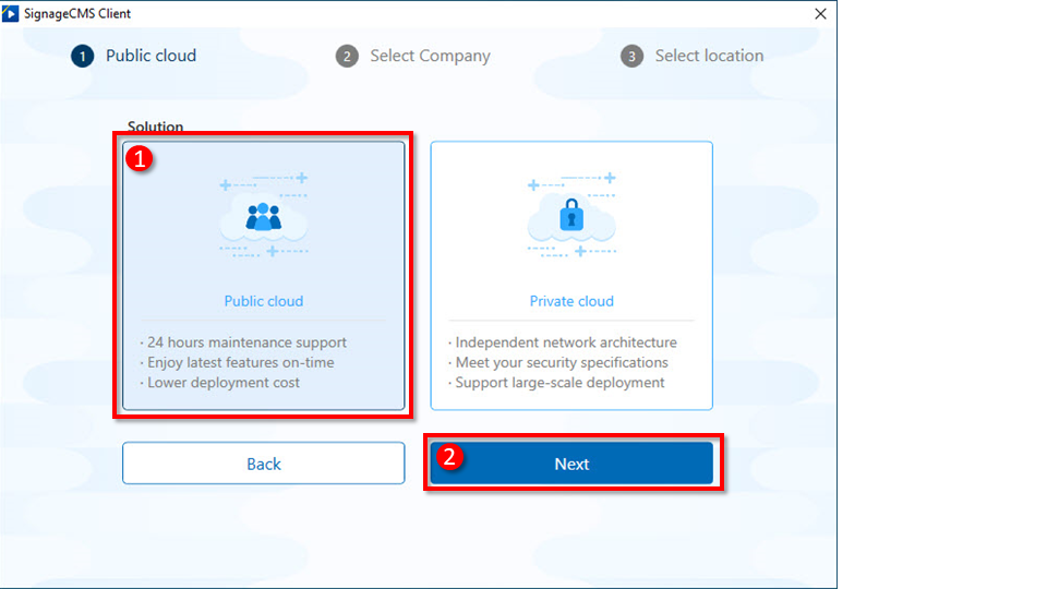

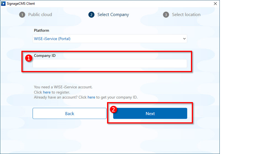

Step4. After enter the Company ID value that you recorded earlier into the Company ID field, click 'Next' button. Guided Mode3.png

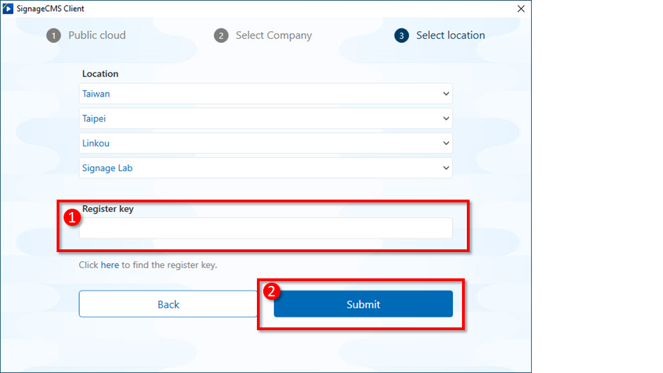

Step5. After select the location where you want to register the device, enter the Register key into the field. Then, press the 'Submit' button. Guided Mode4.png

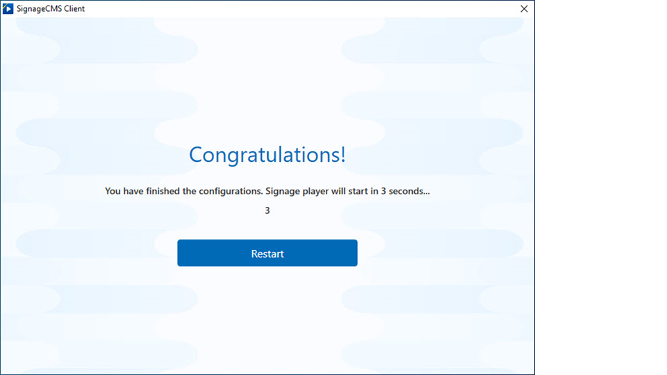

Step6. The initial setup is complete. The player will start in 3 seconds, or you can press the 'Start Now' button. Guided Mode5.png
Step7. After completion, the SignageCMS main screen will appear. Guided Mode6.png

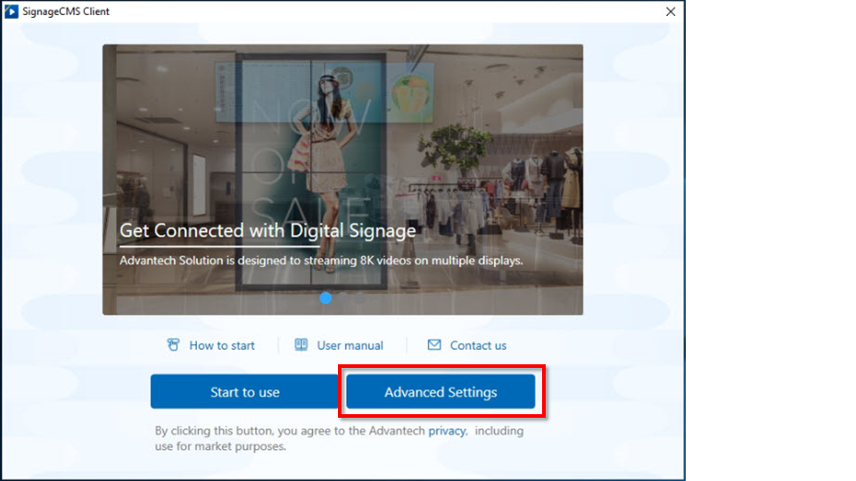

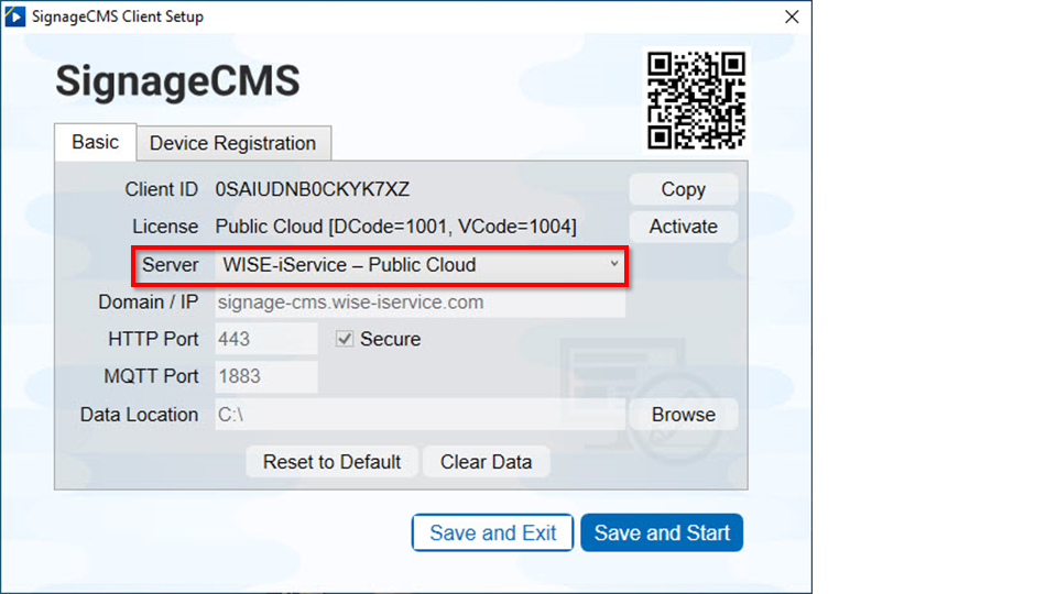

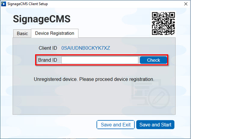

Step4. Select Device Registration, then enter the Company ID value you recorded earlier into the "Brand ID" field. After completing this, press the "Check" button. Advanced Setup Mode2.png

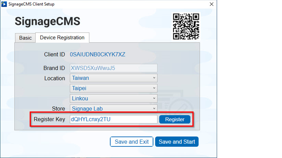

Step5. After selecting the store where you want to register the device, enter the Device Registration Code into the 'Register Key' field. Then, press the 'Register' button. Advanced Setup Mode3.png

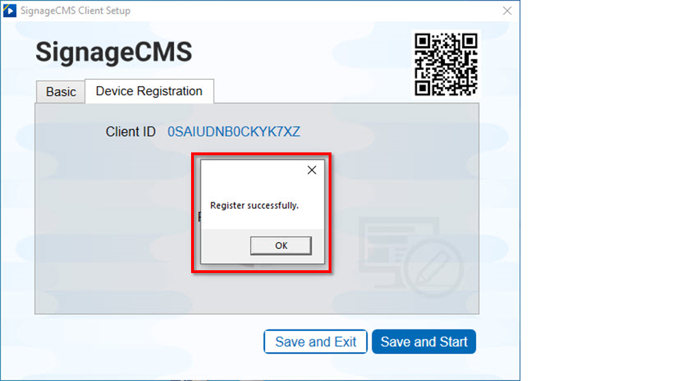

Step6. After successful registration, you will see 'Register Successfully'. Click 'OK' to continue. Advanced Setup Mode4.png

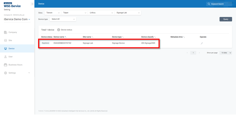

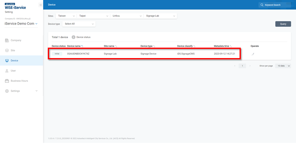

3.1.3 Verify the device registration status and activate the cloud service.​
Step1. "You can go to Device Management to see that the device has been successfully registered, and it will display as 'Registered'."
Step2. Contact OP and have them assist in activating the cloud license. Once completed, the device status will change from 'Registered' to 'Activated', indicating that programs can be sent to the player.

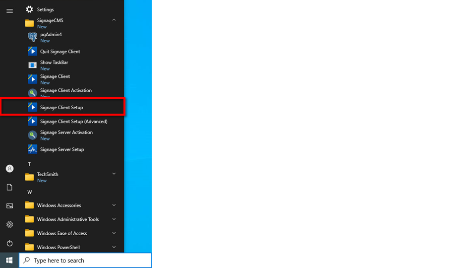

Step1. Press the Win key and click Signage Client Setup Guided Mode-Signage Steup Mode.png
Step2. Click 'Start to use' to proceed to the next step. If you prefer to use the traditional setup, click on 'Advanced Settings' and proceed to section 3.2.2 for advanced setup mode. Guided Mode1.png

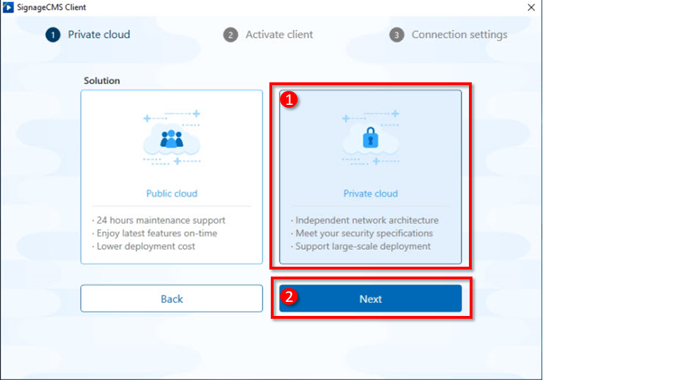

Step3. After clicking on the Private cloud icon, click the 'Next' button. Guided Mode2.png

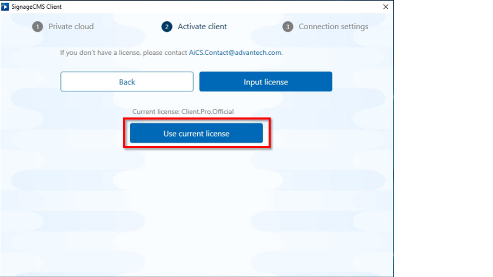

Step4. Please click on 'Use Current license'. > If 'Use Current license' does not appear, please click on 'Enter license Key ' to input the serial number for activation.

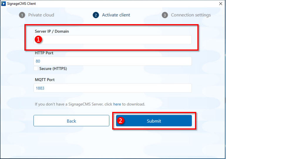

Step5. Please enter the SignageCMS Server IP address or Domain name. Afterward, click the 'Submit' button. > If the player and server are on the same machine, please enter the server IP as 127.0.0.1.

Step1. Press the Win key and click Signage Client Setup. 3.2.2 Advanced Setup Mode.png
Step2. Click on 'Advanced Settings' to proceed to the next step. Guided Mode-Signage Steup Mode1.png

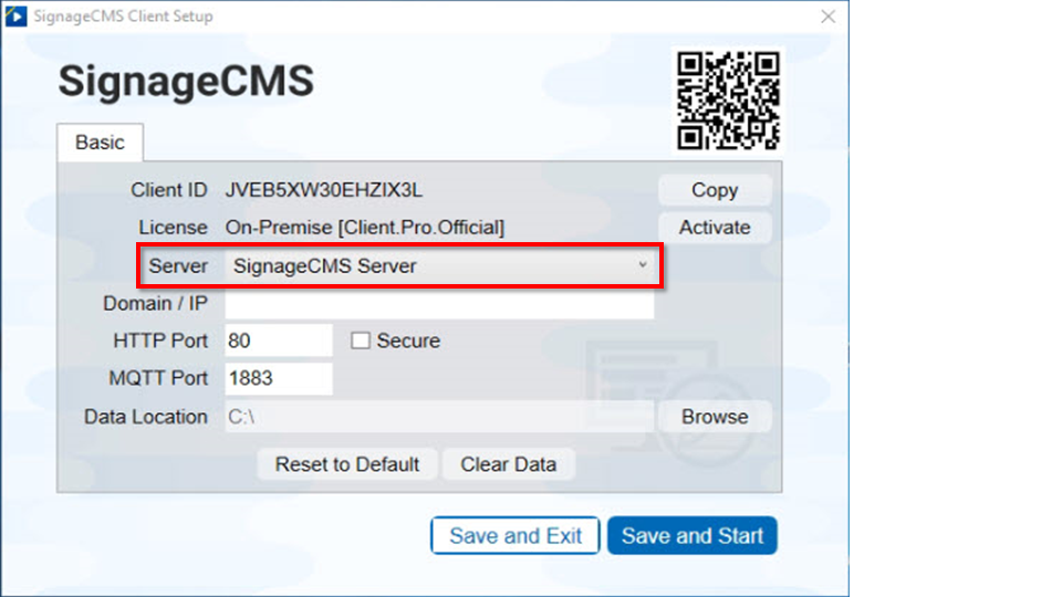

Step3. Make sure to select 'SignageCMS Server' for the server location. > If you are unable to select 'SignageCMS Server,' it means that this device has not been activated with a serial number. Please proceed to the section 'Software Installation/Update and Serial Activation' for steps on activating the serial number. Guided Mode-Signage Steup Mode2.png
Step4. Set the server location, such as Domain or IP. Afterward, please press the 'Save and Start' button to launch the main program. > If the player and server are on the same machine, please enter the server IP as 127.0.0.1.

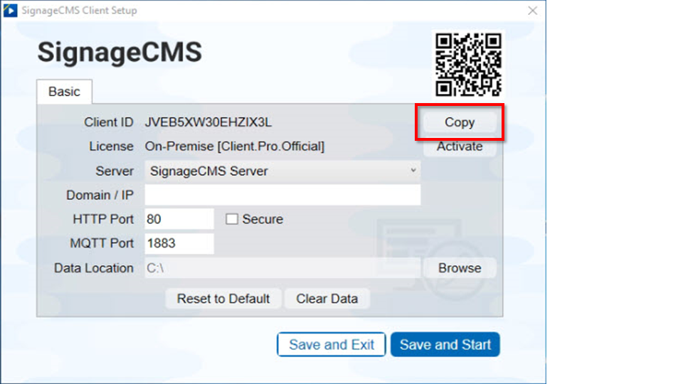

Step1. Open Signage Client Setup. 3.2.3. Register the player to the server.png

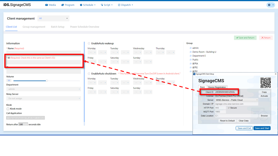

Step2. Copy the Client ID, click the "Copy" button, and then press the "Save and Exit" button.

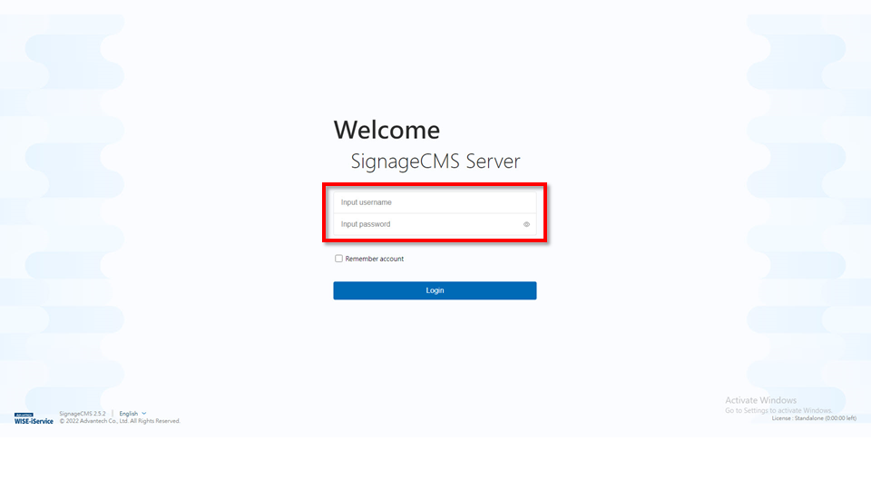

Step3. Open Chrome or Edge browser, enter the server's address (http://IP.ADDRESS/PSN), for example, http://127.0.0.1/PSN, and input your login credentials. In the bottom-left corner, you can choose the preferred language for display. > The default username and password for the SignageCMS server are admin/admin.

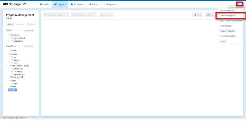

Step4. Click on the gear icon, then select "Client Management". 3.2.3. Register the player to the server3.png

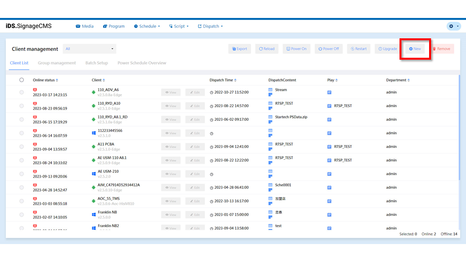

Step5. Click on the "New" button. 3.2.3. Register the player to the server4.png
Step6. Enter the desired player name and ID, which can be found in the player's Client Setup. Once done, please click the "Save and Exit" button. 3.2.3. Register the player to the server5.png

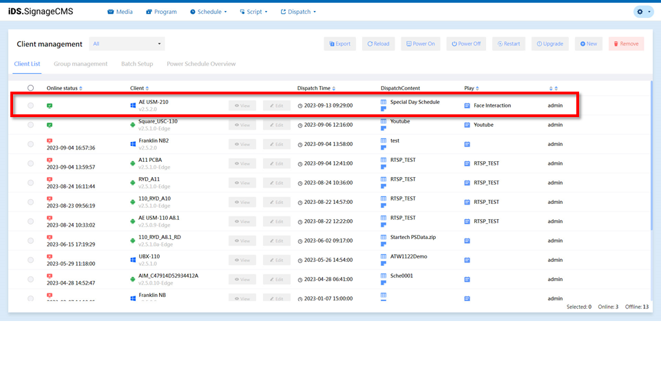

Step7. Return to the device list page and click the "Refresh" button to verify if the device is online. If you see a red light, first click "Refresh" to update the client status. If it still shows as red (offline), please ensure that the software is running and that the Client ID is correct.
