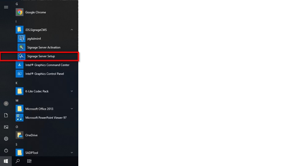

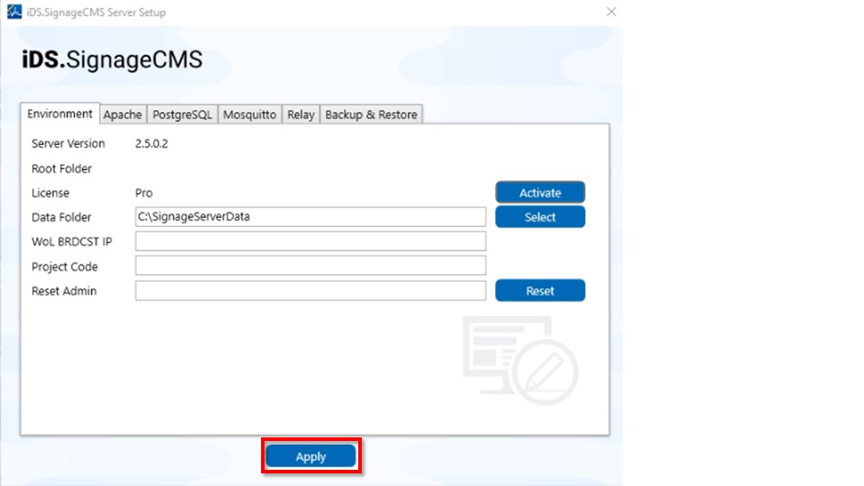

Step 2. please setup what port to use on the server. When everything ready, press Apply button go to next step.
ServiceListen Port
Apache80
Posgres SQL5432
Mosquitto1883

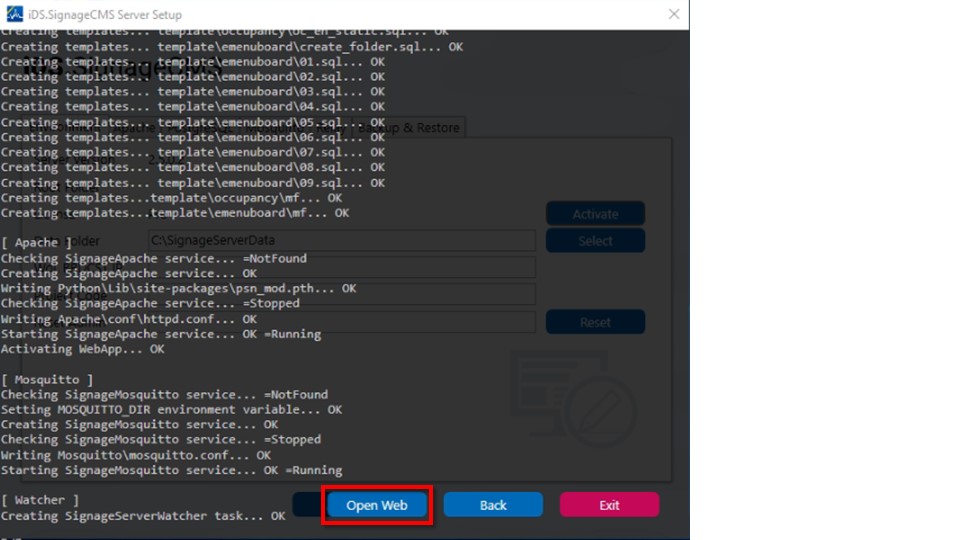

Step 3. iDS.SigangeCMS setup will apply the configuration. It will show Open Web buitton if there is no poroblem, then click Open Web button。If there is no show Open Web button, it means something wrong, please go back check server setting, espically listen Port.

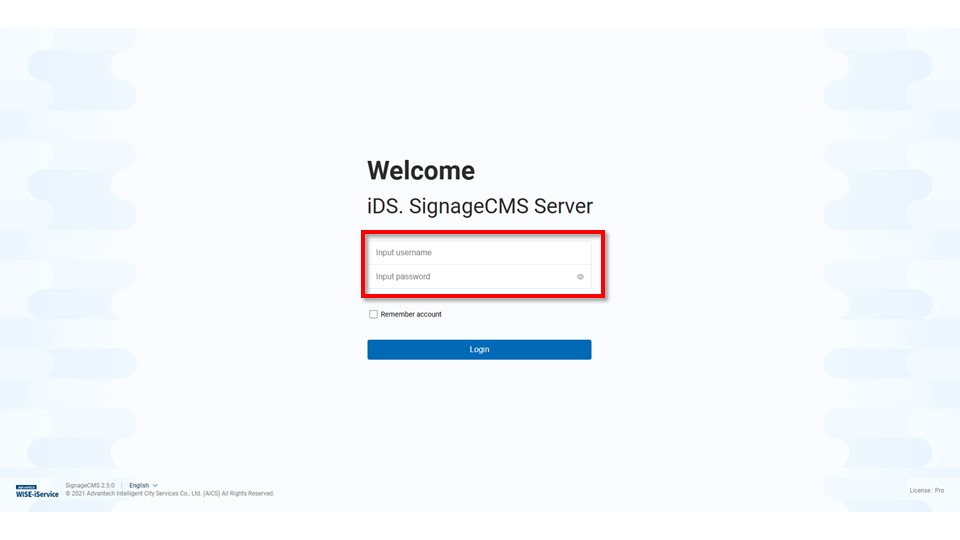

Step 4. Open Chrome or Edge Browser, input domain name(http://IP.ADDRESS/PSN), Example http://127.0.0.1/PSN, input username / password. You can change language at left bottom. >- SignageCMS server default username/password : admin/admin
