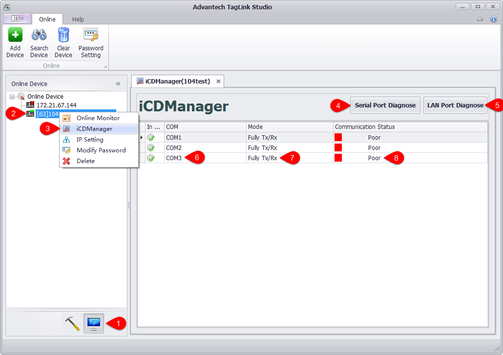

Main Interface of iCDManager
As shown in the figure above, right-click on the device name go to "iCDManager" page.
  1. Click "Online" button.
  2. Select a device.
  3. Right-click on the device name to open "iCDManager" page.
  4. Click "Serial Port Diagnose" button to view the communication status of the serial port. The interface is shown as the above when it is opened for the first time.
  5. Click "LAN Port Diagnose" button to view the communication status of the LAN port. Please refer to "Network Monitoring" for its interface.
  6. Display the name of the serial port. Double-click it to pop up the parameter configuration window (refer to "Parameter Configurations of Serial Port").
  7. Show the monitoring mode (refer to "Parameter Configurations of Serial Port").
  8. Show the communication status: "Poor", "Good" and "Excellent" (refer to "Monitoring Status Tips").

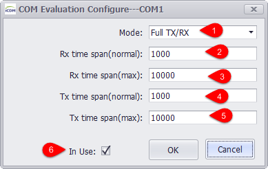

#####Full tx/rx
The parameters are described as follows:
  1. Here the monitoring mode is set to "Full tx/rx" which means full function monitoring mode.
  2. The minimum time span for receiving line to monitor the signal level variation. If the actual time span is less than it, the monitoring result will be excellent.
  3. The maximum time span for receiving line to monitor the signal level variation. If the actual time span is greater than it, the monitoring result will be poor.
  4. The minimum time span for transmitting line to monitor the signal level variation. If the actual time span is less than it, the monitoring result will be excellent.
  5. The maximum time span for transmitting line to monitor the signal level variation. If the actual time span is greater than it, the monitoring result will be poor.
  6. Choose whether to display the information of this port.

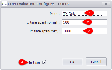

#####Tx Only
  1. Here the monitoring mode is set to "Tx Only" which means only transmitting signals will be monitored.
  2. The minimum time span for transmitting line to monitor the signal level variation. If the actual time span is less than it, the monitoring result will be excellent.
  3. The minimum time span for receiving line to monitor the signal level variation. If the actual time span is less than it, the monitoring result will be poor.
  4. Choose whether to display the information of this port.

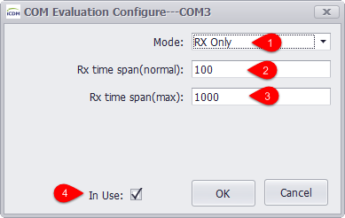

Rx Only
  1. Here the monitoring mode is set to "Rx Only" which means only receiving signals will be monitored.
  2. The minimum time span for receiving line to monitor the signal level variation. If the actual time span is less than it, the monitoring result will be poor.

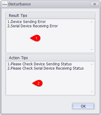

  1. Result tips.
  2. Action tips.

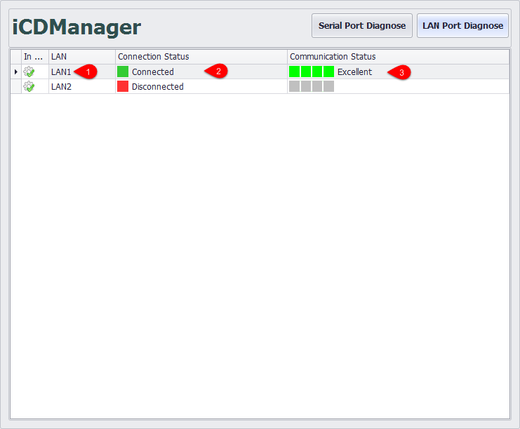

Network Monitoring
  1. Network name.
  2. Network connection status.
  3. Network communication status.
