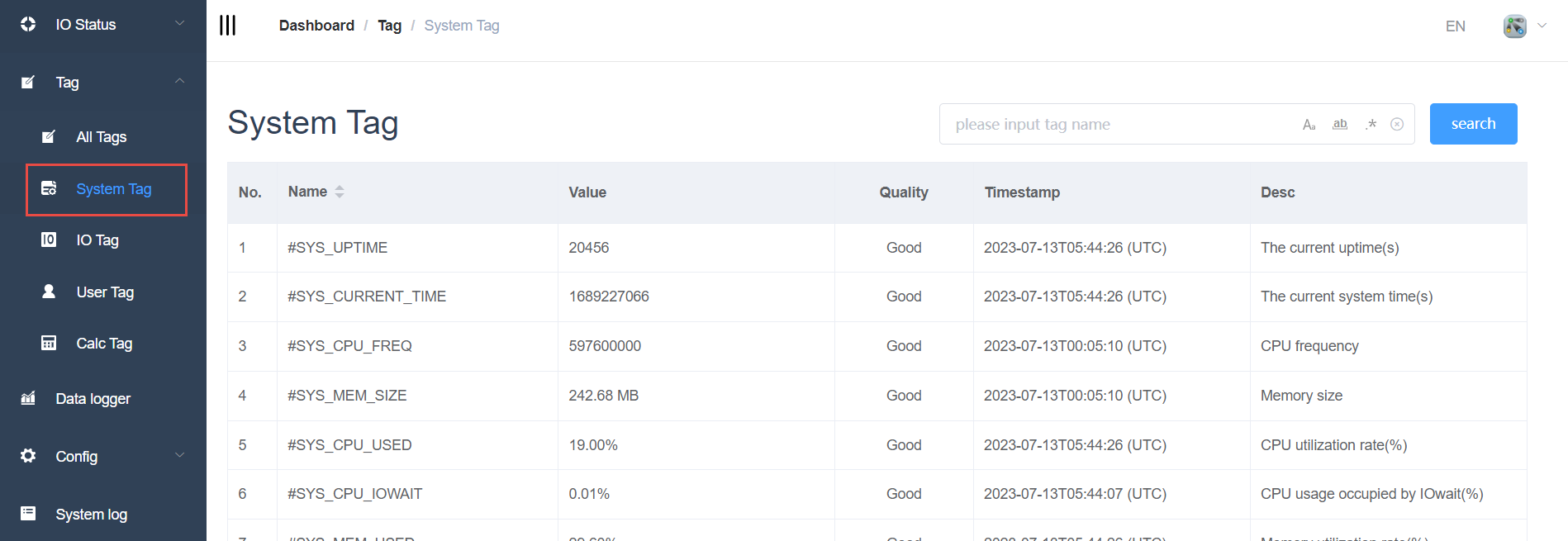

System Tag
Search of Tags:
General system tag description(Read Only)
