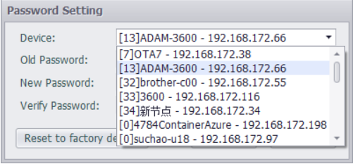

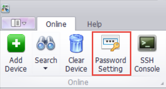

The first case: any one of the multiple devices is selected to change the password
Click Password setting
Select the device you want to set up

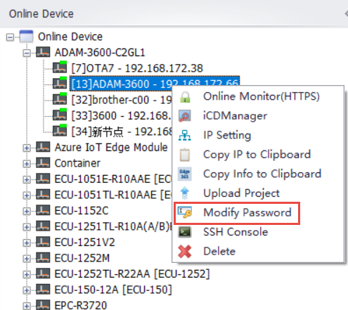

The second case: Right-click on a specific online device and select Change Password to modify the password of the current device
Select the device, right-click
Select Modify password

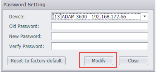

After the above two situations
Fill in the old password, new password, and thenconfirm password
Click Modify to set a password

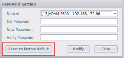

Reset to factory default
Click "Reset to factory default" on this interface, after which you need to restart the device within 10 seconds. After restarting, the device's passcode is restored to its factory state.
