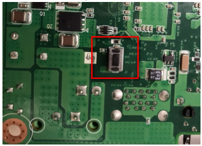

Device Trigger Mode
Open the back cover
Connect the Micro USB cable to the Host PC
Press the SW1 button and power on
Verify recovery mode by checking if NVIDIA Corp is detected:
lsusb | grep "NVIDIA Corp"Expected output:
XXXX:XXXX NVIDIA Corp
