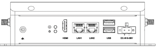

DC-In
EPC-R3720 supports a lockable DC=jack header that can be connected 12V DC

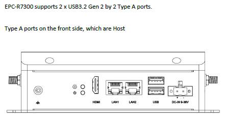

EPC-R7300 supports 2 * USB3.2 Gen 2 by 2 Type A ports.Type A ports on the front side, which are Host.

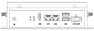

LAN Ports
EPC-R7300 supports 2 * 10/100/1000Mbps LAN ports on the front side.

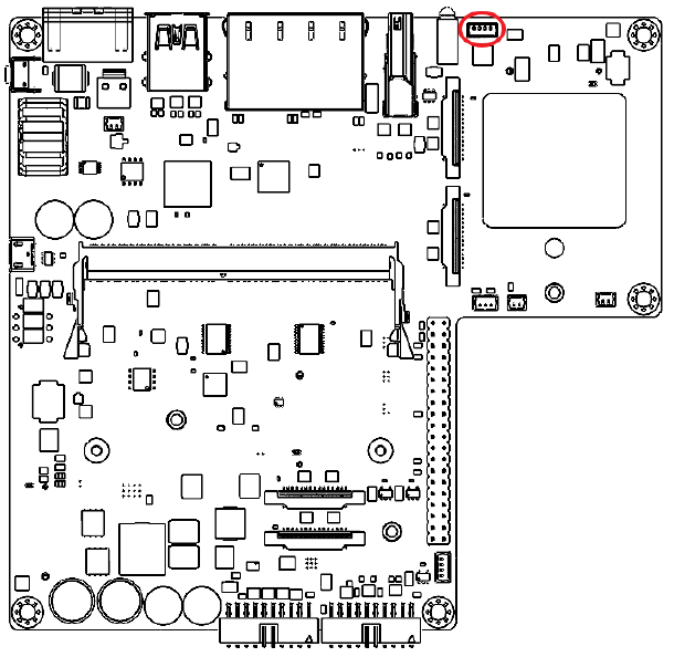

Debug Port
EPC-R7300 provides one Debug Port for development used. Debug cable P/N: 1700021565-01 4P-1.25 to D-SUB 9P (F) 60cm
| Pin | Pin Name | Pin | Pin Name |
| 1 | N/A | 2 | COM_TXD |
| 3 | COM_RXD | 4 | GND |

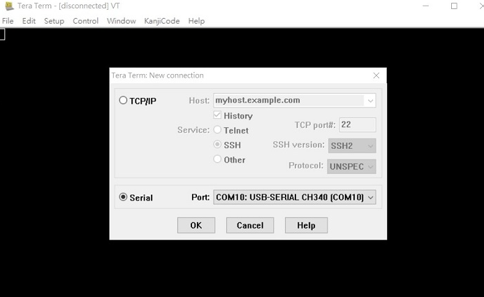

Debug with Tera Term
Set up New Connection, choose Serial

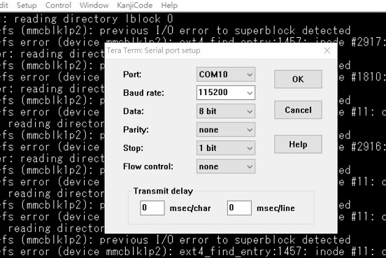

Setting
| Setting | Value |
| Baud Rate | 115200 |
| Data | 8 |
| Parity | none |
| Stop | 1 bit |
| Flow Control | none |
