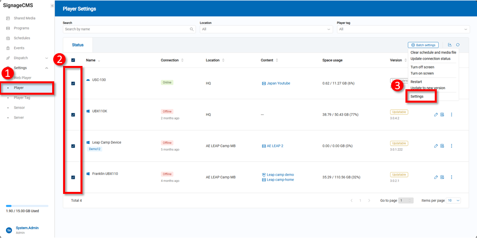

Here are the setup steps:
  1. Go to the settings page and select "Player."
  2. Check the players you want to schedule for reboot, or check the box at the top to select all players.

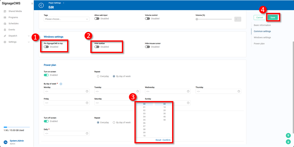

Turning the Screen On and Off:
This feature only toggles the HDMI signal from the player, causing the screen to enter standby mode when no signal is received. Please use the screen on/off functions together as follows:
  1. Enable the "Turn on screen" option to open the subsequent settings menu.
  2. Choose whether the player should restart daily or on specific weekdays.
  3. Select the desired restart time. Ensure that the player is powered on at the restart time to prevent the function from failing.
  4. Enable the "Turn off screen" option and follow steps 2-4 in the subsequent settings menu.
  5. After completing the settings, press the "Save" button to apply and save the changes. 投影片5.PNG

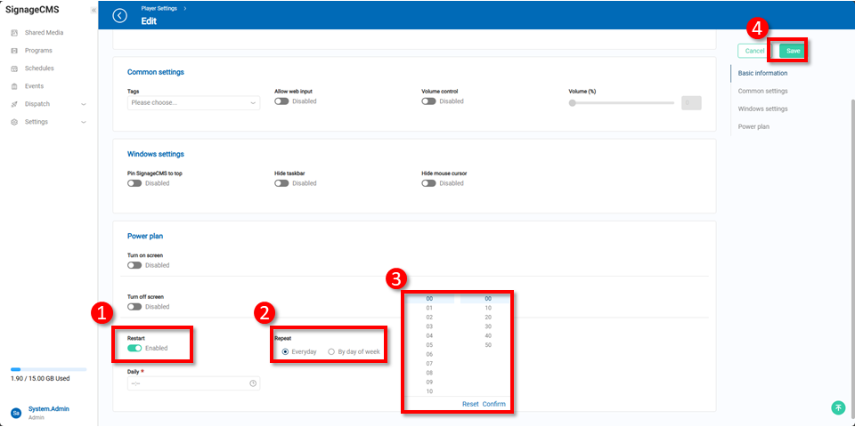

Rebooting the Device:
  1. Enable the "Reboot" option to open the subsequent settings menu.
  2. Choose whether to restart the player daily or on specific weekdays.
  4. After completing the settings, press the "Save" button to apply and save the changes. 投影片6.PNG
